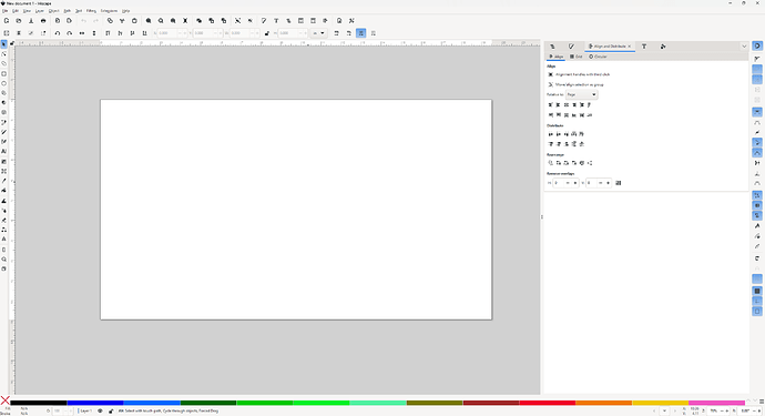

When you open Inkscape, there is a white rectangle that is the working area for Inkscape.

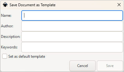

Then go to File->Save Template… and name it as you see fit. I chose to make mine the default template with the checkbox at the bottom.
Now whenever I open a new document it’s correctly sized for the Glowforge bed and I can lay my job out to fit a full sheet.
