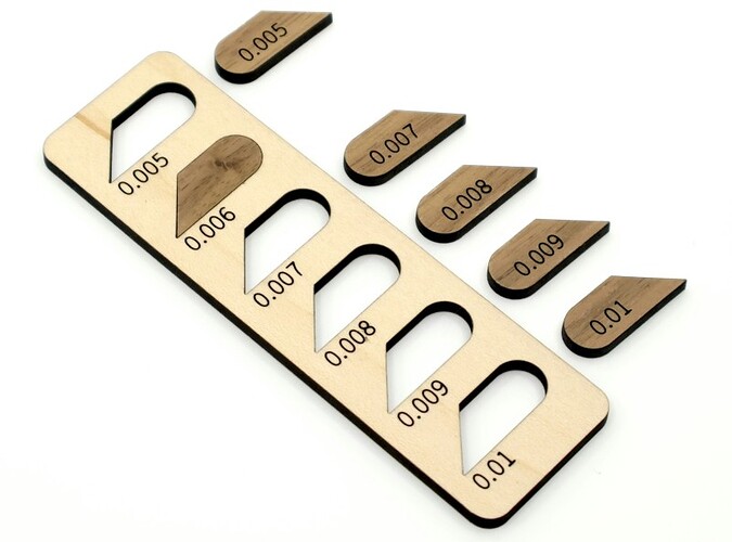

Inlay Kerf Tester
We started with a slight twist on a classic tester that let’s you find that dreaded kerf in a few easy steps. The companion video has detailed instructions on how to use it if you haven’t done this kind of thing before. And in true Cuttle fashion you can customize all the parameters, so if you are a power user you can easily get more precision or make more tests in one go.

Fabulous! Especially that one is not a smooth shape - that’s always tougher with kerf :slight_smile:
