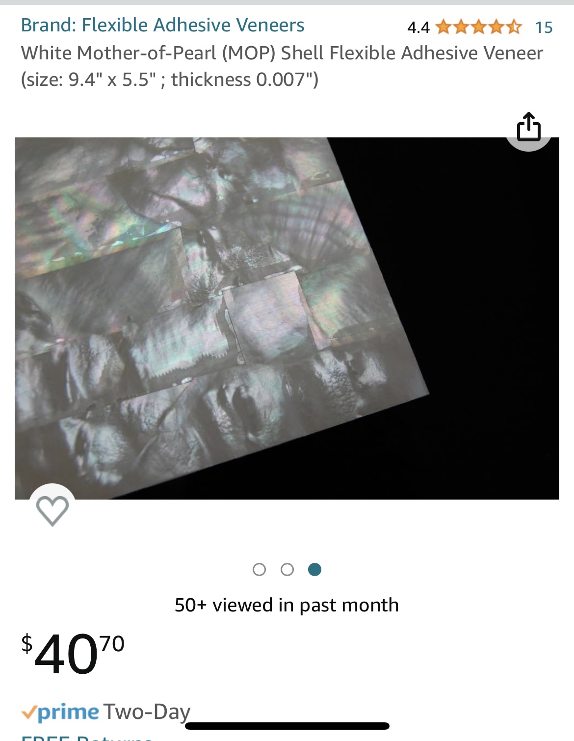

If I may ask, how thick is the Nacre, and did it cut well?

This is the kind I used. It has a 3M backing. (0.178mm) I had to prep the wood with a silver paint or else the wood was visible.
It cut ok at 200/45/x2 passes, but I still had to cut it free in a few places because of the glue.

I bought a “flexible” inlay…which means it is very thin and kind of “pre-cracked.” I had to prep the surface better because it is so thin you can see the wood grain behind it.
The bonus is that the tie, itself, remains flexible and the kind of cracking that would be damaging is not really a risk. Since the wood is a living hinge instead of many pieces, there’s a need to not “overbend” it in the design.
