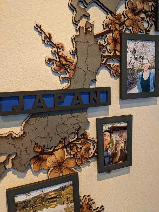

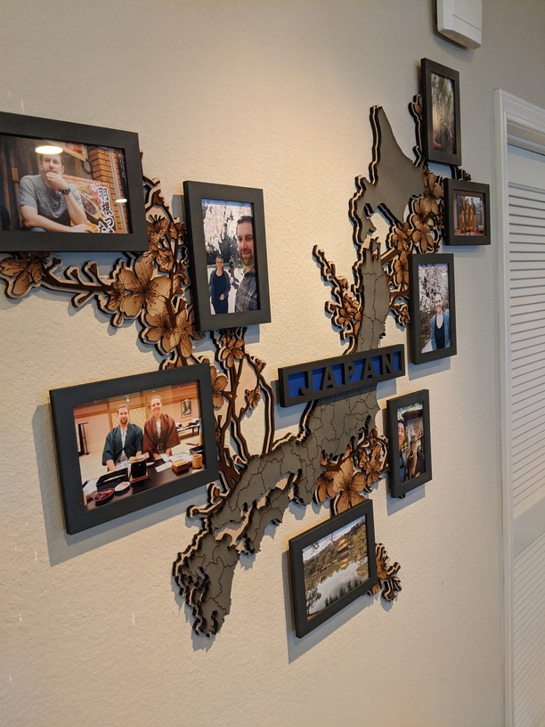

Japan picture frame for our vacation
All draftboard (except the acrylic over the pictures). Each layer is fit together with dovetail connections behind the layer in front of it. The pictures are magnetized to the piece on the back so we can change the pictures.

The colors are really good, did you paint it? The color variations in the flowers is super cool, like before I take the masking off the draftboard and it’s super pretty, then I get super disappointed when I peel off the masking because it’s plain.
The cherry blossoms were just engraved. I did take the masking off before engraving, which allows the burn marks to add to the coloration. The country pieces were stained with a grey stain. I spray painted the frames and the blue title background.

WOW! This is a beautiful piece of wall art. Are all pieces assembled together or are they hung seperatly?
