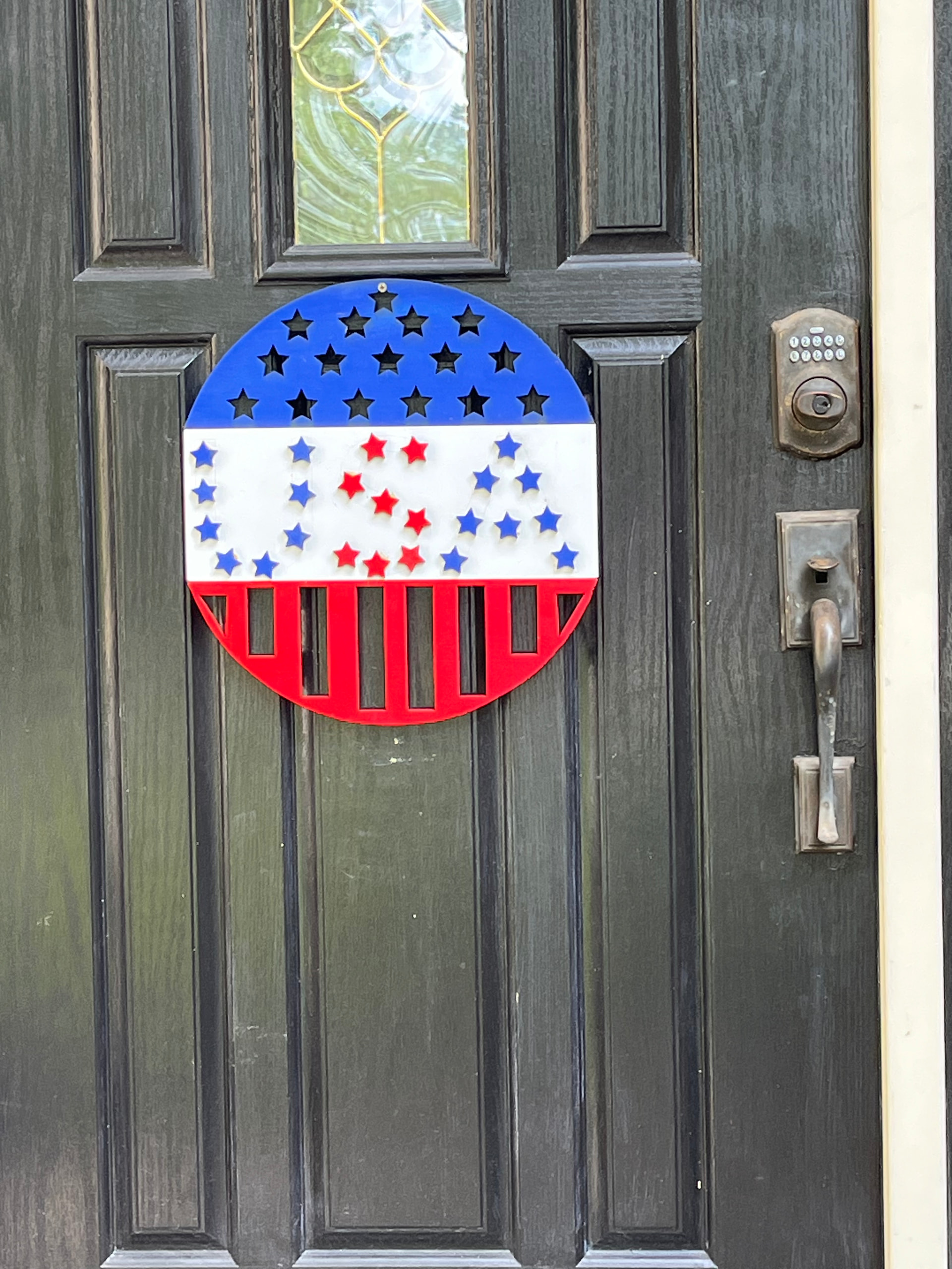

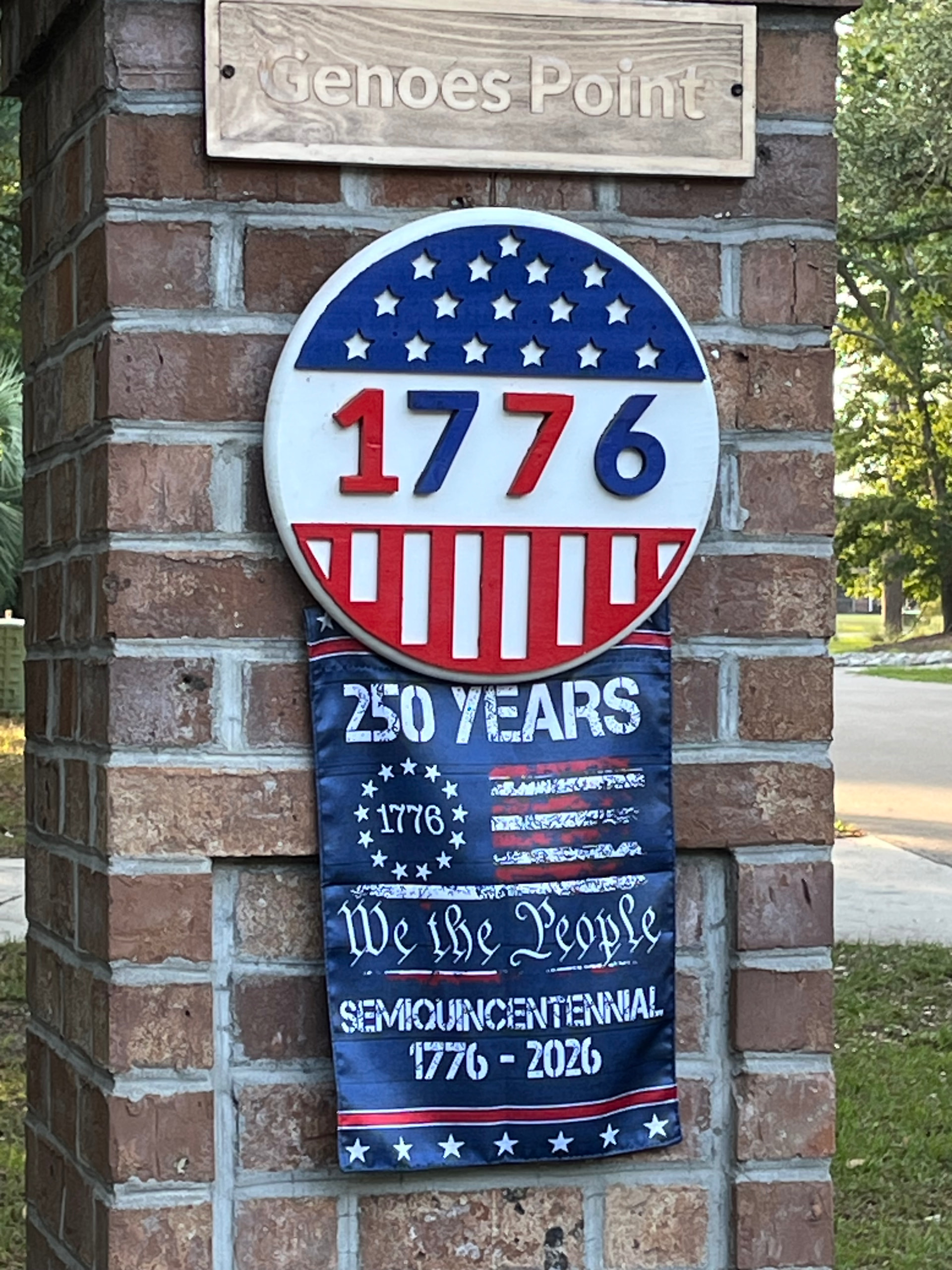

3 wreaths and one made with scrap cutout stars in the USA. Material used is 1/4 Popular

There are two wreaths on the 2 column entrances and they were identical so I just took a picture of 1

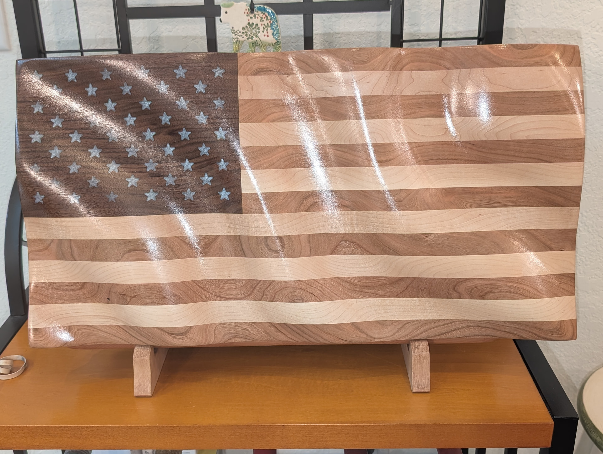

Maple, walnut & cherry with epoxy filled stars & lacquer finish. CNC carved to create the “waves”.

Beautiful! How big is it?
After you cut the waving flag affect, how long did it take you to get such a smooth finish? You did a really nice job on your flag.
It’s 22 1/2 x 12" with the thickness varying from 1/2" to 1 1/4" depending on where on the wave it’s measured.
I made it for an auction to support local scholarships so it’s on a stand I make for cutting boards. But it’s got a keyhole hanger slot in the back so it can hang on the wall.
I sanded it using paper up to 320g. Most of it was with a random orbital sander with a thick sponge pad backer to allow it to flex. But it got finished off with hand sanding using flexible sanding pads. After a few coats of poly a final " sanding" using a brown paper grocery bag to burnish it.
