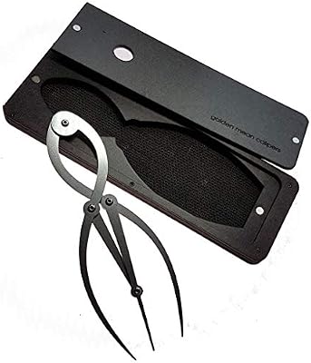

After randomly typing keywords into Google Image searches for, like, an hour, the closest real tool I could find are “golden mean calipers” (which look quite similar at first glance).
Nice digging there.
Not just antique, but ancient. Wonder if it is as accurate as yours?
Thanks! I bet it’s perfect, but the pointer doesn’t actually point to the center. Instead it always divides the total distance into two parts that form the golden ratio (AKA the “divine proportion”, a ratio said to be found in many places in nature).
