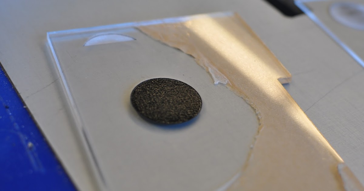

Check out what it does on clear plexi
Thanks for testing this idea and showing the results. Guess I’ll keep those almost empty cartridges a few more months.
Well, it could have some promise after all. Thanks for running with the idea. Toner doesn’t look like it fills as smoothly as the Laser Darc SEEMS to. But it does seem to bond OK. Would hate to do multiple passes with it, but might be worth it for special projects.
