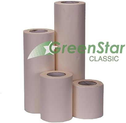

OK I am going deep on masking here. I have also learned about Greenstar, which one of our peeps is apparently using as well.
@markwal, can you chime in with how well it is working on whatever materials you’ve tried?
Anyone else using this?

US cutter sells Greenstar through Amazon:
or directly:
http://www.uscutter.com/GreenStar-Layflat-Classic-Transfer-Tape-Medium-Tack-Assorted-Widths
I’ve used the Greenstar on Baltic Birch ply and veg tanned leather. It takes some work (pressure and smoothing with my hands and a putty knife) to get it to stick nicely on the birch and the flesh side of leather. Weeds easily from the birch and a holds a bit tighter to the leather. Tighter still if I leave it on in the material stack for a while before using. But even then, it’s easier to weed than the Proofgrade.
I have more trouble with flash back on the birch. If I give enough power to reliably get through the birch then the flash back also makes it through the mask sometimes.
So far I’ve had better luck with the leather. Probably because I’m less worried about making it all the way through all the time. A few missed spots are easy for me to cut through with a knife. So I can dial it back to where it is just barely making it through the masking.
Sure, I use that stuff on everything - fabric, wood, acrylic, and (predominantly) leather. I like it quite well, and find it to be far more economical than some of the other options that I initially tried. It holds nicely, but still peels off easily.
When using it on leather, be careful to smooth it out completely. Any folds or crinkles will transfer to the surface of the leather (true for any masking, FWIW).
