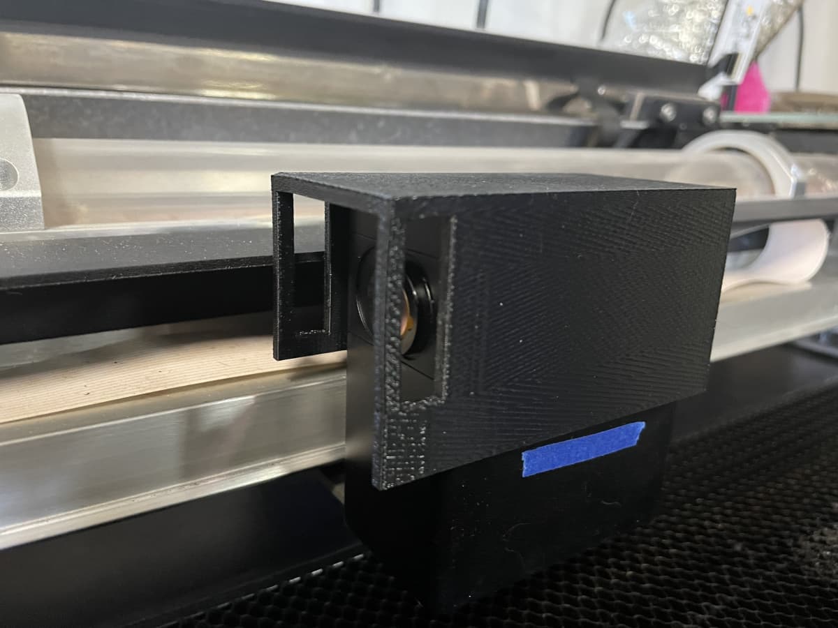

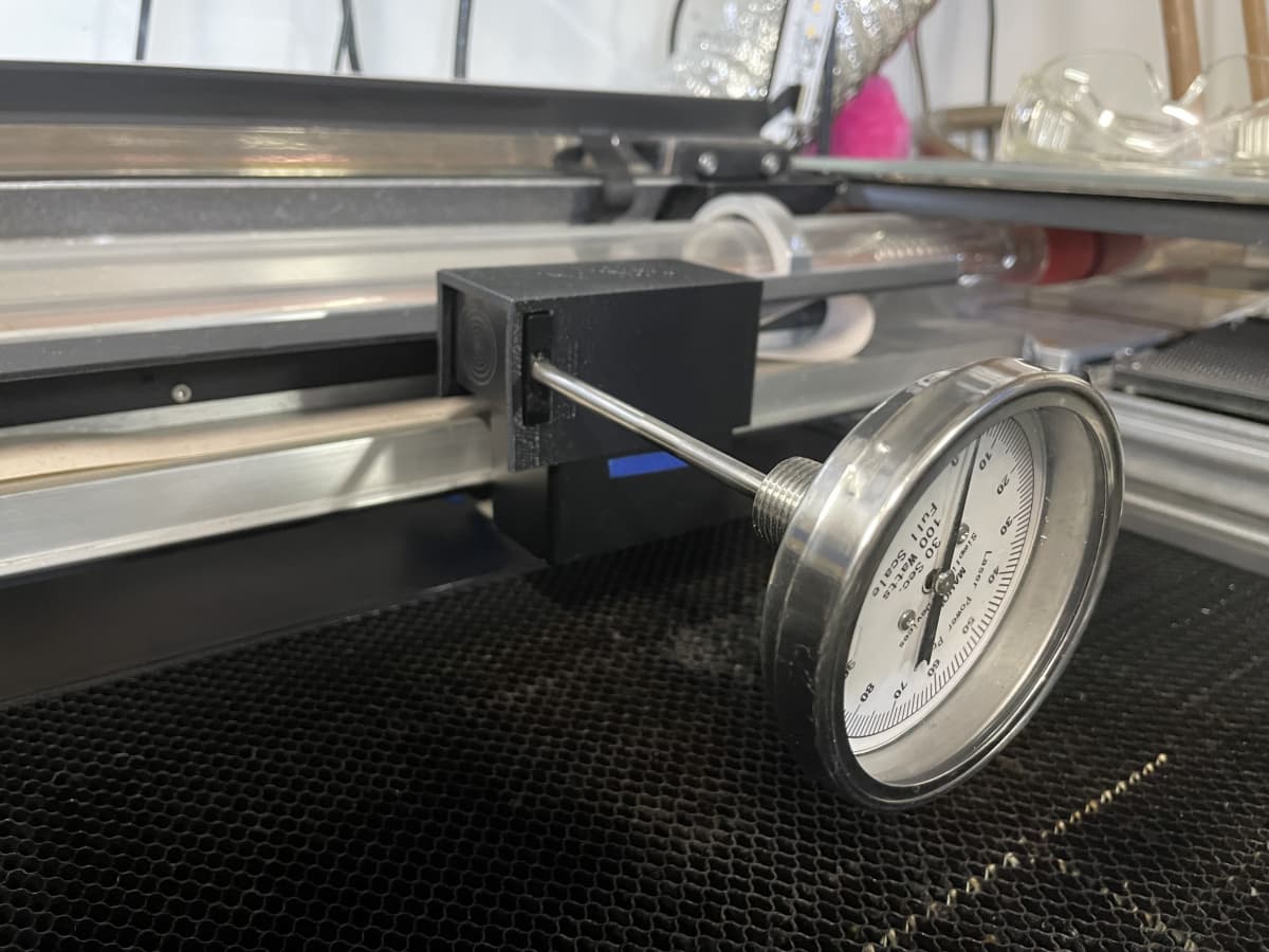

I 3D-printed a holder for the laser power meter that slips over the head of the GF printer. I don’t slip this holder or power meter onto the printer head until the initial homing and centering process is complete. During those steps, the head moves too close to the bottom edge to allow for clearance of the meter that sticks out several inches. Anything printed with the power meter attached has to be located near the top of the GF bed.
The power meter slips into a couple openings on the front (left left) side of the printer head and completely covers/intercepts the light path.
How does it work???
I printed the spiral vector image that takes 29 seconds using Full Power. After waiting the requisite time after exposure, the meter read 23.2 Watts. A video recording of the run can be found here:
While I’m still not getting the 40 Watts I expected, using this approach did increase the reading from ~16 Watts that I got from readings through the print head with the lens removed.
I’m still wondering why I’m only getting about 60% (~23W) of the 40W rating of the GF. Maybe that’s the best it can do??? Maybe the power meter is not recording accurately because of the etching I made in early runs??? BTW…the manufacturer is sending me another meter at half-price so I’ll have another meter to test in coming days. Maybe there’s still something I don’t understand about how to make these measurements???
Clever. Nice clean design.
