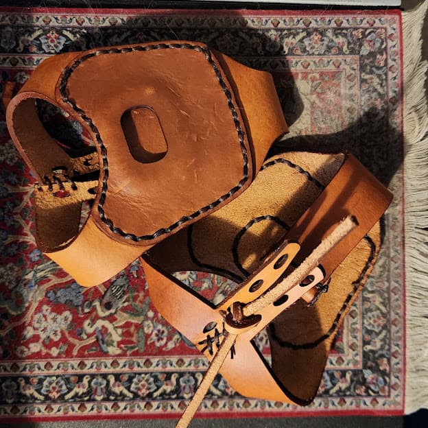

My sister was asking me if I’d ever used a sewing palm - and I had not, so I looked it up and thought how useful that would be for some of the …hardier… sewing projects I have. They are used mostly by sailmakers and the like, but in case it’s something that would come in handy here’s my take on one.
I made it ambidextrous since I alternate left-handed and right-handed depending on the project :slight_smile:
Made with a Tandy leather 3-4oz vintage side (Apollo, but they don’t seem to have that anymore) cut on the Thick PG Leather setting.
As you can see it’s adjustable for the width of your hand - and has quite a bit of room for the thumb. The only thing that might have to be truly adjusted was what you used for the hard part inside. Mine is a cheap metal ring thimble that I flattened and cut in half.
Anything smaller than about 1x2" would fit in the space :slight_smile:
Sewing Palm_V6
You take your hard item, sew it into the pocket made by the two oval pieces and sew that to the front of the main base (this picture is from the back).
Flip over the palm piece (so the suede is out) and sew that to the front of the main base.
Fold over the belt end trapping the strip of tie leather in there.
Lastly sew the top of the loop ends together.
I hope it helps someone poke fewer holes in their hands when sewing something! :slight_smile:

You could use either an additional layer or two of leather in its place or (my favorite) a piece of delrin. I prefer that because the needle doesn’t slip on me as much as it does on thimble material.
NOOOOOOO!!! I have punched through multiple layers of sole leather before trying to use them pushing a needle - it hurt like hell! Layers of polyethylene too, even more ouch.
Definitely use a metal layer.
Yep. :slight_smile: That’s why I like Delrin. Never had a punch through.
Yes to both of these - I’d totally give Delrin a try if I had any, but multiple layers of leather is not enough :smiley:
My first attempt at this had the holes for the oval bit going all the way through and I managed to jam the back end of the needle through those holes - and the two layers of leather! Moar protection needed!
I could totally see making the palm piece full sized so it fills the entire pocket - with the smaller hole through to the hard part…as long as the holes don’t go all the way through!

As someone who has bought a professionally made one of these, it looks good. The only thing I’d suggest improving would be the metal insert.
On the one I have, the insert is a thick steel disk with half spherical indents, like a golf ball. Honestly, I only ever used the same one or two spots on it. So I’d say go to the hardware store and buy 1/4” thick by 3/4” bar stock steel, cut off a 3/4” length or so. Grind the edges and corners smooth, then use a Dremel with a spherical burr to put a few divots in the middle, probably about 3/16” to 1/8” deep.
This will make the indentations much deeper than a normal thimble and the needle much less likely to slip out when pushing hard.

I had some friends who plan on sewing some canvas pavilions, so it was time to make a more traditional sailor’s palm using this design!
Instead of soft leather I used a nice heavy leather (~10oz), and for the hard bit I enlarged the center bit by 104%, removed the cut out, and then boiled it in water and rubbed it with wax (modern cuir bouilli) which makes it just less than rock hard.
(it shrinks when you put it in the boiling water, so the 104% made it shrink back to the point where the stitch holes were still the right size/place)
