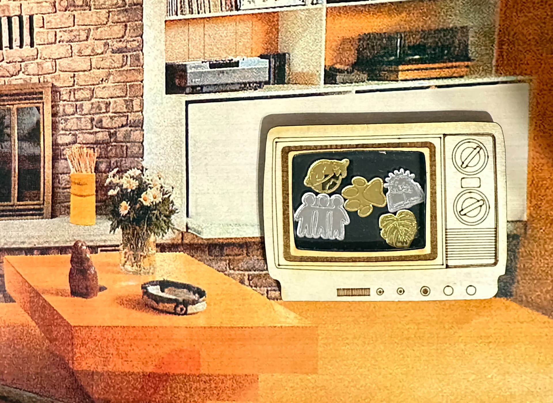

I saw a post about a snowglobe (double layer acrylic, see-through) ornament in the Friendliest Glowforge FB Community and it got my gears turning on how I could use this concept in a way that spoke to me and the things I like to create.
Behold what I call the “Manifestation Station”

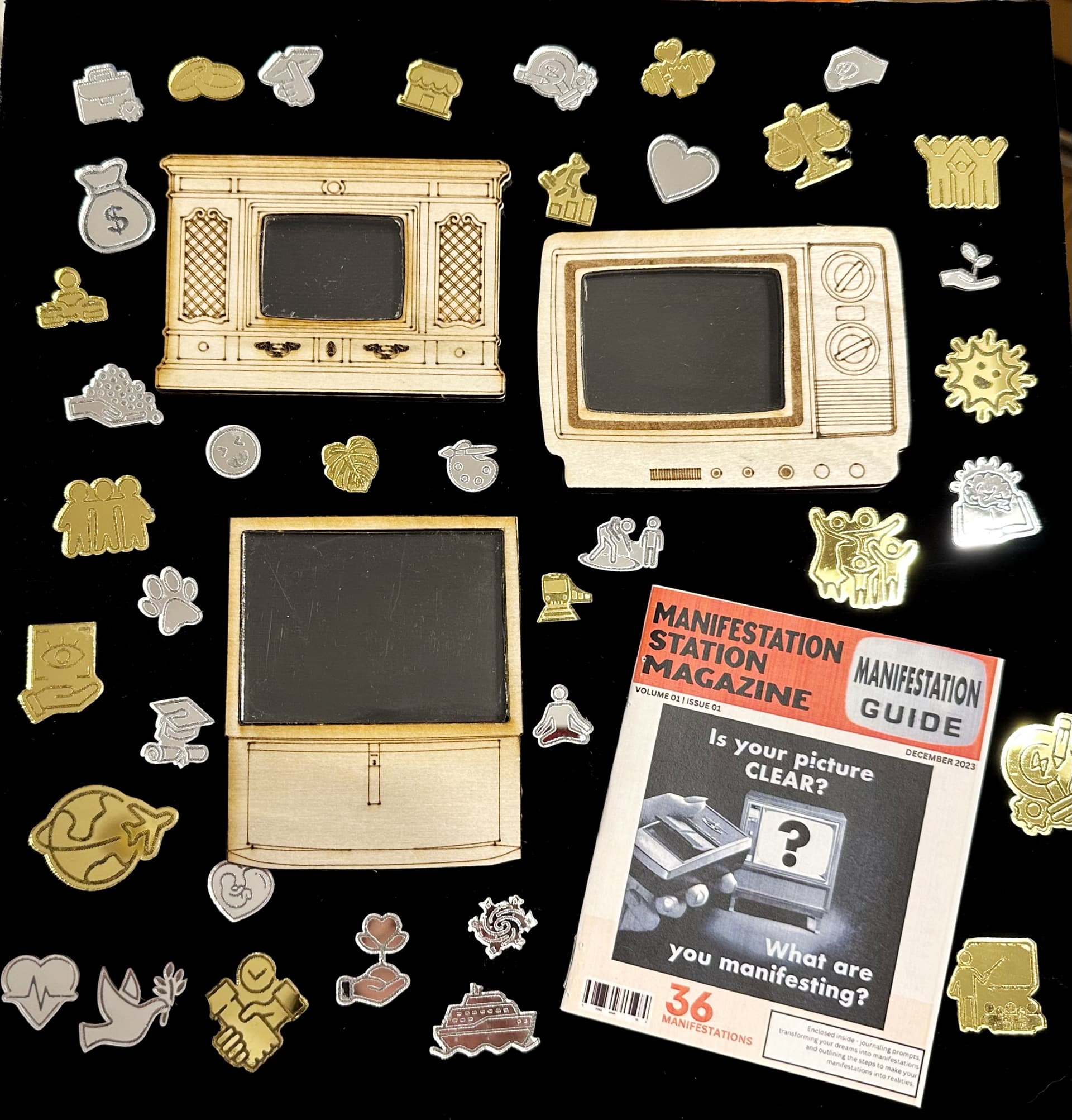

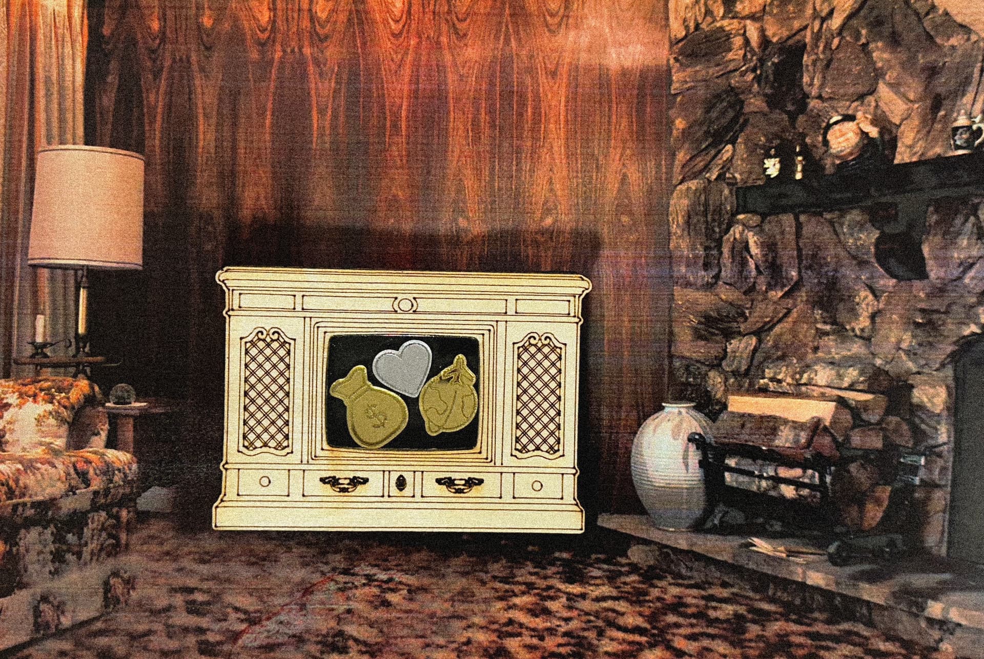

The Manifestation Station is a physical representation of the console TV you and I have spent countless hours sitting in front of - being told what to buy, who we are and who we can be. This Manifestation Station that I’ve made flips that script on its head and makes the Manifestation Station a tangible item with a magentized back. You can take off the back of the Manifestation Station and populate it with Manifestation Station tokens to represent the things you are wanting to manifest in your life. There are 36 Manifestation Station tokens in the set, cut from mirrored acrylic, in varyings sizes to fit one of three iconic Manifestation Station styles.
I recommend keeping your Manifestation Station tokens limited to 3 or 4 at a time, as our human spotlight of attention is quite narrow and easily overwhelmed/distracted.
Each Manifestation Station comes with a 16 page booklet that gives a background on the 36 Manifestation Station Tokens and includes over 50 journaling prompts and a step-by-step guide on how to get into integrity with others.

1/16 Yellow Gold & Silver Mirrored Acrylic from Houston Acrylic for the Manifestation Station Tokens LINK
1/16 Clear Cast Acrylic sheet for the Manifestaiton Station screens LINK

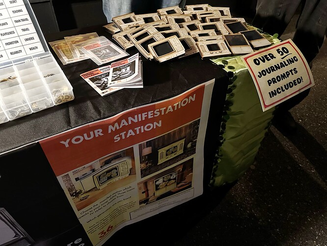

My first night selling these at a night market was last night and I sold 9 of them! I was pretty thrilled with the customers’ reactions. They’d never seen anything like it, and that’s because it’s an idea that I thought up, designed, created, assembled and brought to market just last night.
