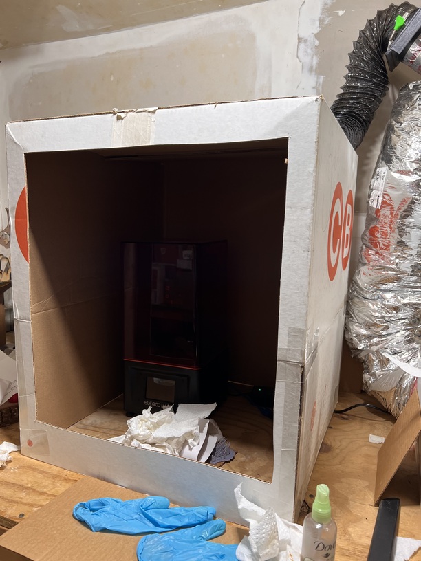

I recently made a super low budget fume hood by hooking up a Y to my external inline fan, cutting a hole for the vent hose in a big box and putting the whole IPA print/rinse setup inside it. I was getting irritated by the IPA and/or resin fumes and decided a negative pressure environment was a good plan. turned out to be an outstanding idea, and now I have no issues.

I find that cleaning is the only phase that causes me grief. i think it’s probably the IPA. My bodged fume hood has been a game changer… I’ll post a pic and you’ll laugh.
Oh also bonus alcohol spray bottle in the foreground. I find it’s useful for the very final cleaning of various surfaces to spray and wipe them down… it uses very little alcohol. 99.9% IPA is pricey (not really but kinda, it’s the principle of the matter)
hey, nothing wrong with makeshift stuff like that! why spend a fortune on something when a modified cardboard box will do the trick? i’d probably do the same.
Yeah I tried to complicate it and got all into planning a Real Live Vent Hoodtm, scheming and planning for a week or two but in the end I said “or I could use a box” and was done in like ten minutes.
I don’t even use a mask or anything anymore. I just crank that fan and there are no fumes in the room at all. It just goes out the same vent hole that the GF uses.
