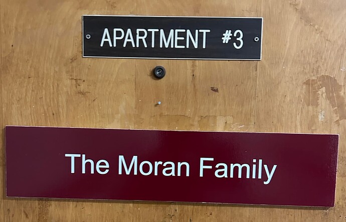

I have been asked to create some signs for our community. They have send me a photo of what they have used in the past, and I have pasted it below. I need to figure out the best way to make something similar with the Glowforge. I wondered if there is a material I can use that would be a different color when it is engraved? I know I could use a wood piece, or clear acrylic and the engraving would show, but I wonder if there is another option. Otherwise I would need to cut the acrylic sign in Glowforge and use my Cricut machine to make a sticker of the name. Am I missing another option?
The search tool is your friend. Try “two color plastic” :wink:
Consider Rowmark Ultragrave
As @dklgood suggested, Rowmark would give the cleanest professional look.

It’s just not worth the effort to fiddle with other methods, the two-color (also called “double color”) acrylic is ubiquitous.. Even Amazon has it. It will produce the most durable, commercial-looking results.

This makes complete sense now that you put it that way. For some reason I was having a hard time figuring out what to search for. I was making it too complicated, and because there isn’t anything in the glowforge proof materials like this I wasn’t sure. Thank you.

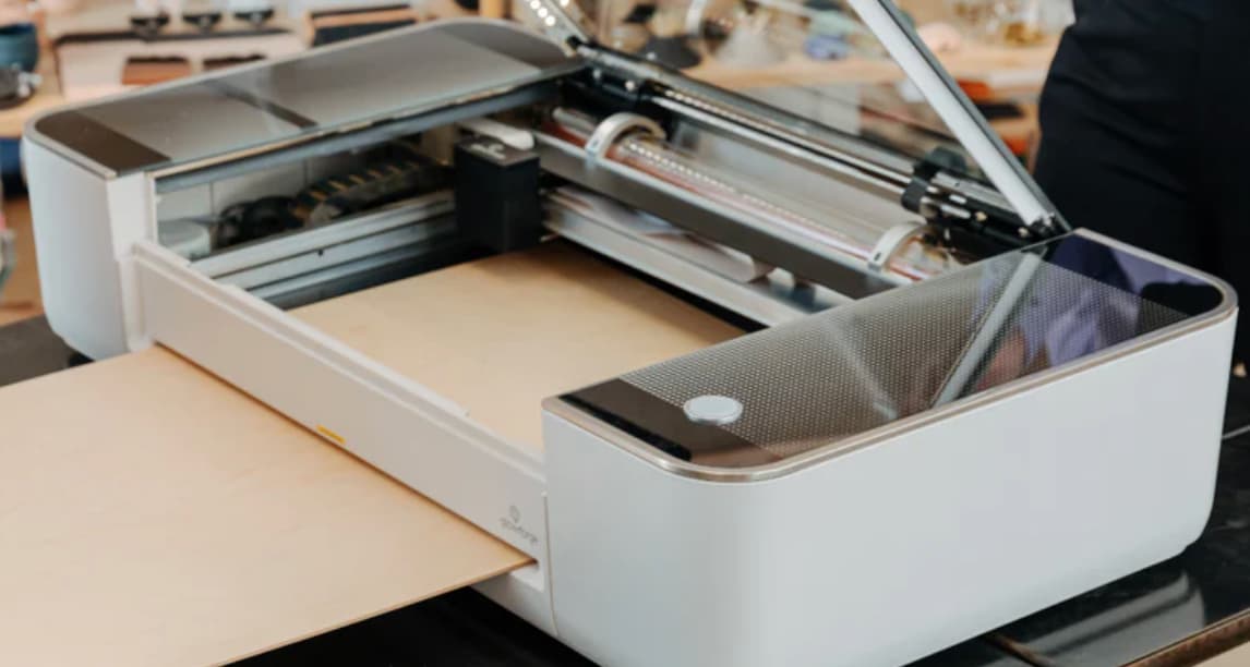

It looks like the smallest size on the Rowmark website for the Ultragrave is 12”24”, which is too wide for my Glowforge. I don’t have anything that can cut it smaller in my classroom. I know I can put longer pieces into the Glowforge by opening the door on the front, but that didn’t work well for me the last time. It might be worth me looking into having someone cut smaller pieces for me, or getting over my aversion to using the machine with the pass through open. What settings do you use when you are cutting or engraving this?
You easily cut this product without a Glowforge. Simply score and snap. You can also get smaller sizes: Black on Bright White Laserable Acrylic Sheet – Inventables, Inc.

Some people may not feel comfortable “snapping” the acrylic. I have also used the passthrough slot on the Pro to cut larger pieces down to size. Just drop a line across the entire sheet and cut it at the 20” mark. You will end up with 2 pieces that fit inside your Glowforge when you need them.
The front lower door is not the “pass through” - pass through is provided by built-in slots with silicone wipers, that come with metal covers if not intended to be used. It is on the Pro models.
It is possible to use the machine with that front door open, but is ill-advised in-general.
