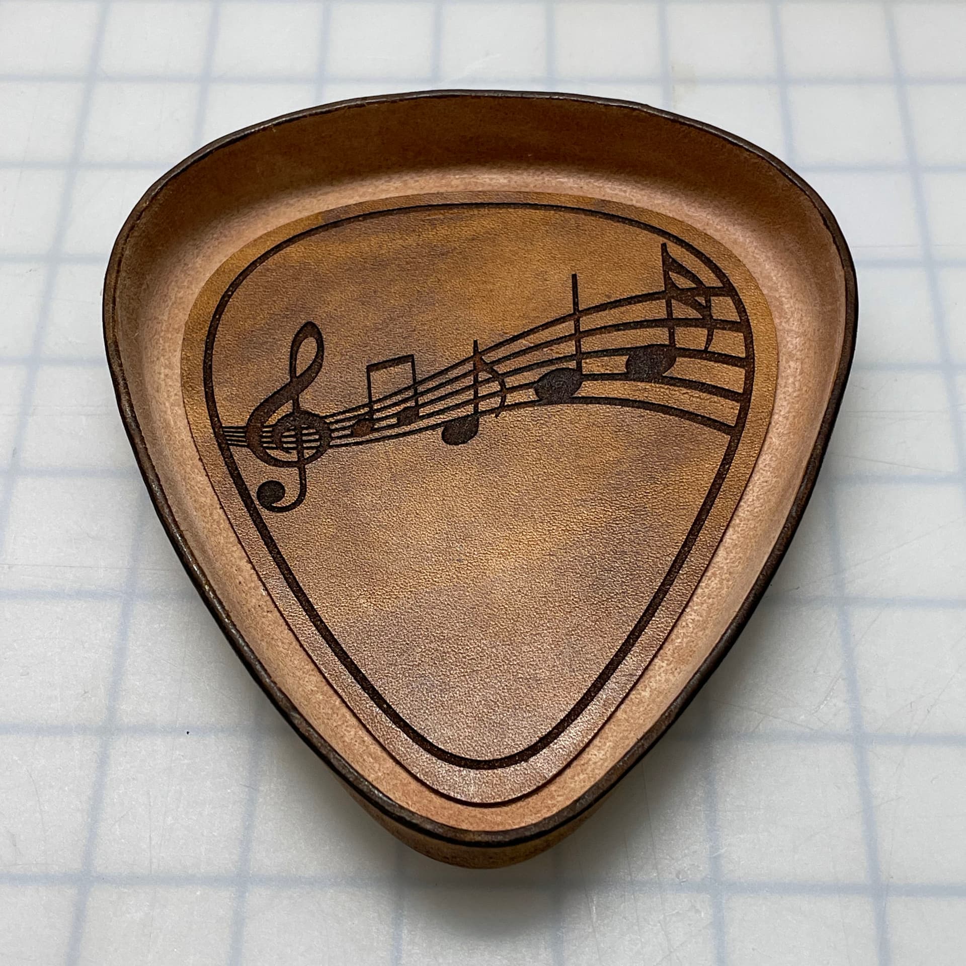

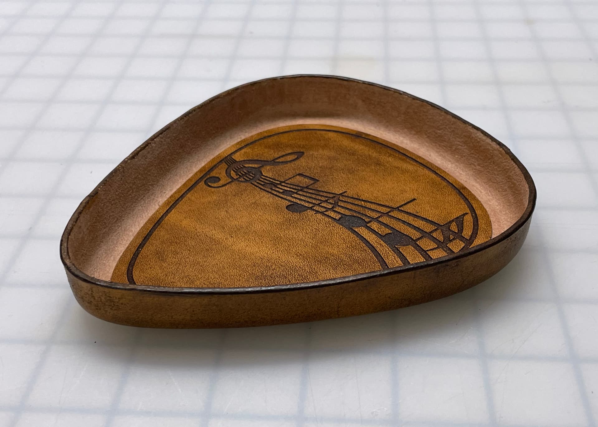

Latest molded leather tray. Wanted to play around with a different way to decorate bottom surface of tray.

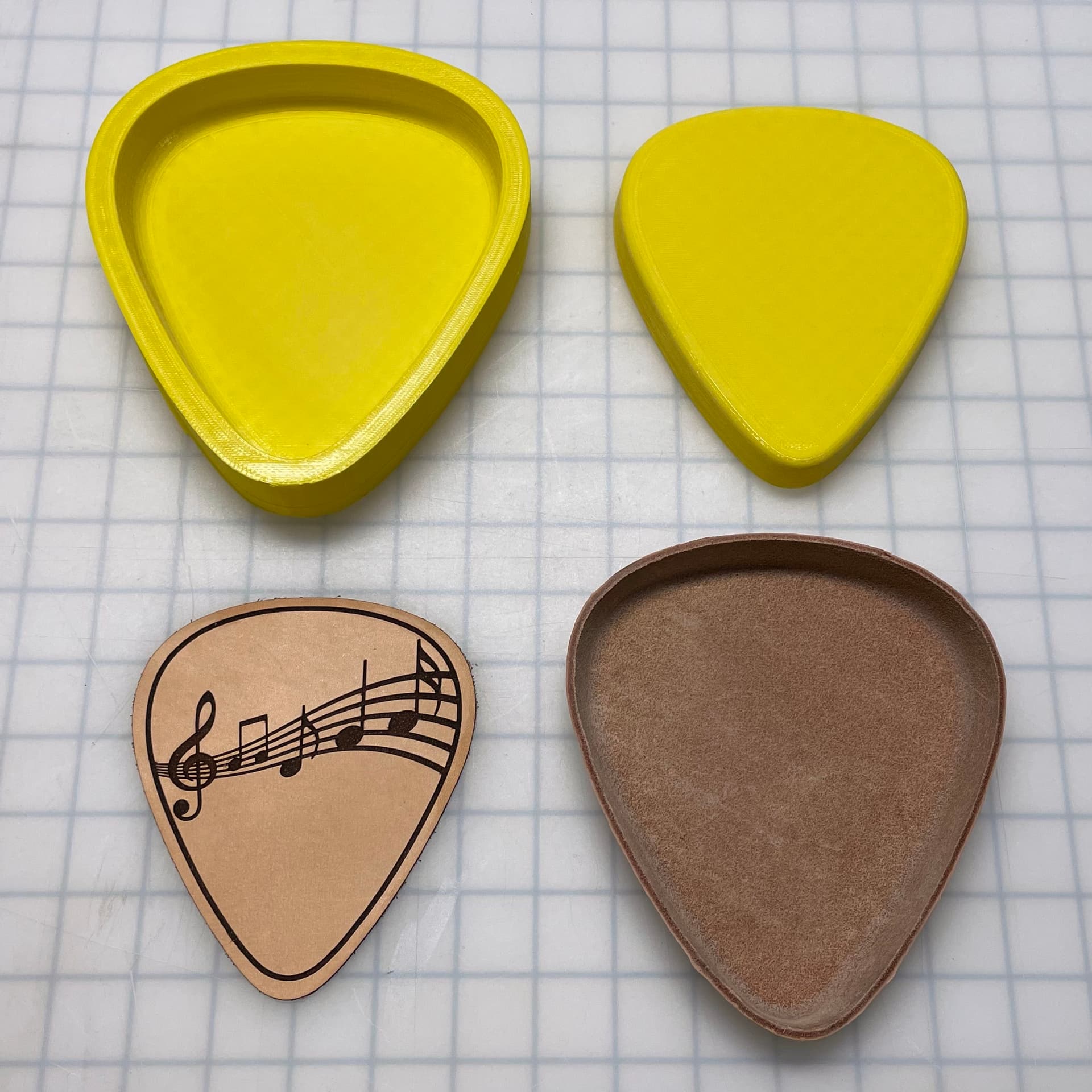

3D printed mold.
Wet molded proofgrade thick natural leather for main tray.
Engraved and cut inner panel from proofgrade medium natural leather.
After dying and finishing parts, glued panel in tray.

Very nice. Are those 1 inch squares on the surface it’s sitting on?

Yes, those are 1" squares.
Finished tray is about 5.25"x6"

Great combined use of the 3D printer and Glowforge! Final tray looks perfect.
