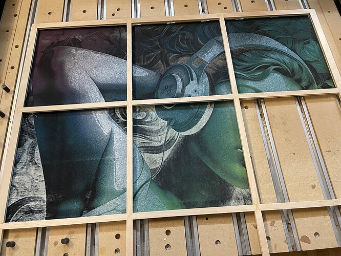

This project was a way to turn a limitation into an inspiration. Given the bed size of the glowforge, the largest square canvas I could work with was about a 10 by 10. I wanted to make larger art, so I decided to make a custom frame and use 9 separate canvases to make this:
It’s about 30 by 30 inches, spray painted and then individually engraved. Here’s a few process photos:
Layout of individual black canveses
Silver top coat
Taste the Rainbow
The slow assembly of 9 separate 1.5 hour engraves (please don’t lose power, please don’t lose power, please don’t lose power)
(edit) One other cool thing is that if you look at the first photo and the assembly photos, you can see the silver shows up only at certain angles. It is much more prominent in the first photo.
This also gave me a really interesting idea for the next project. Stay tuned.

So could you show the original image? Or just describe it? Is it a grayscale that you used vary power setting? Just trying to understand the technique a bit more and how you got such interesting effects with very few layers of paint. The black canvases were black or you painted them black?
That looks absolutely amazing! And thank you for showing us the process!
The original image is greyscale with Vary power. The canvases are originally black. As far as the paint layers go, it can be a bit of an adventure.
Thin layers can give a lot of detail, but sometimes the laser goes right through and you lose even the black part of the canvas. I have also used high temperature black engine paint, which can alleviate some of that. Thick layers of different colors can be interesting, because greys tend to cause the layers to blend.
Short answer: It’s a bit of a crap shoot, but that’s kind of why I love it.
