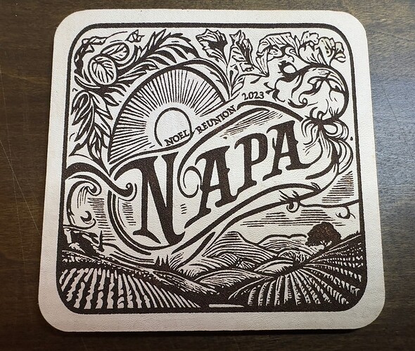

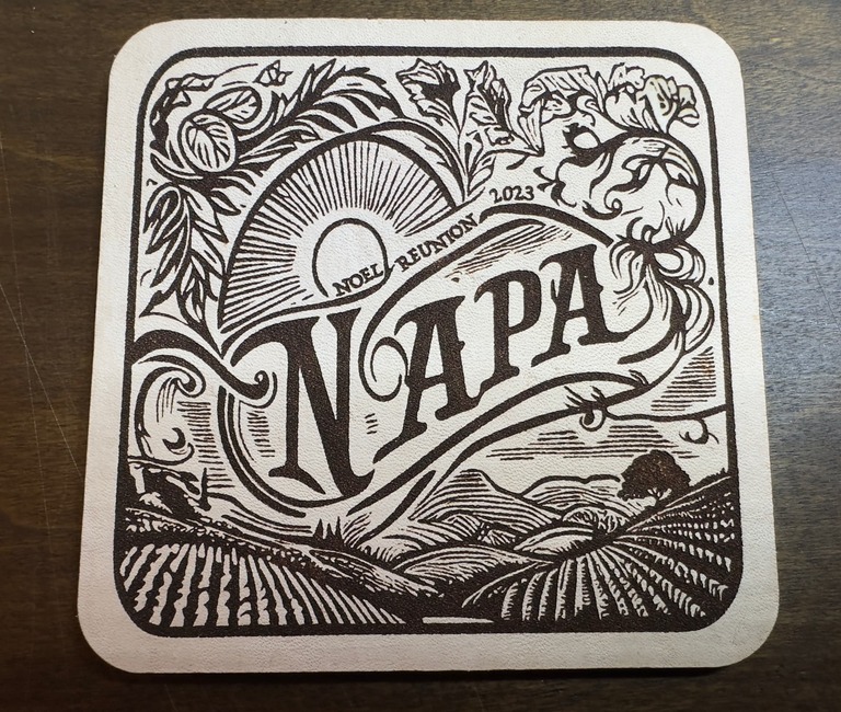

Napa-themed leather coasters
My first leather-engraving project: memento coasters for a family reunion in Napa, California.
For finish, I’m going to apply a couple of light coats of diluted acrylic resolene (thanks for all the helpful advice in the forum!).
This is probably a good example of a level of detail you don’t want for a leather engraving. Weeding the tiny bits of fragmented masking was a lengthy process, about 4-5 applications of Gorilla tape followed by spot touch-up. (It’s possible I applied the masking too firmly, but I didn’t want pieces coming off during engraving.)

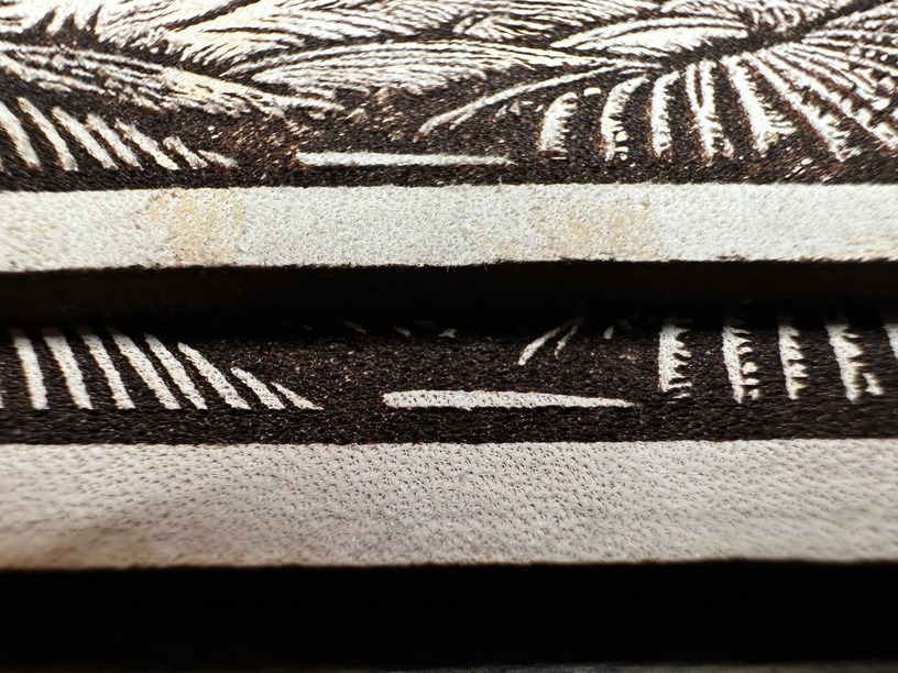

Nice contrast on this (thanks for posting the settings in BtM). I do find that the proofgrade leather seems to hold onto the masking for dear life. When I mask stuff with something like the Nekoosa paper, it seems to be more cooperative.

I just tested Proofgrade for comparison. The Proofgrade leather (shown on top) got a little torn up during de-masking — the surface of the leather itself started coming off. The other leather I’m using (bottom) came from Amazon, with my own transfer paper added.
Yep. That is exactly what I have seen too.
