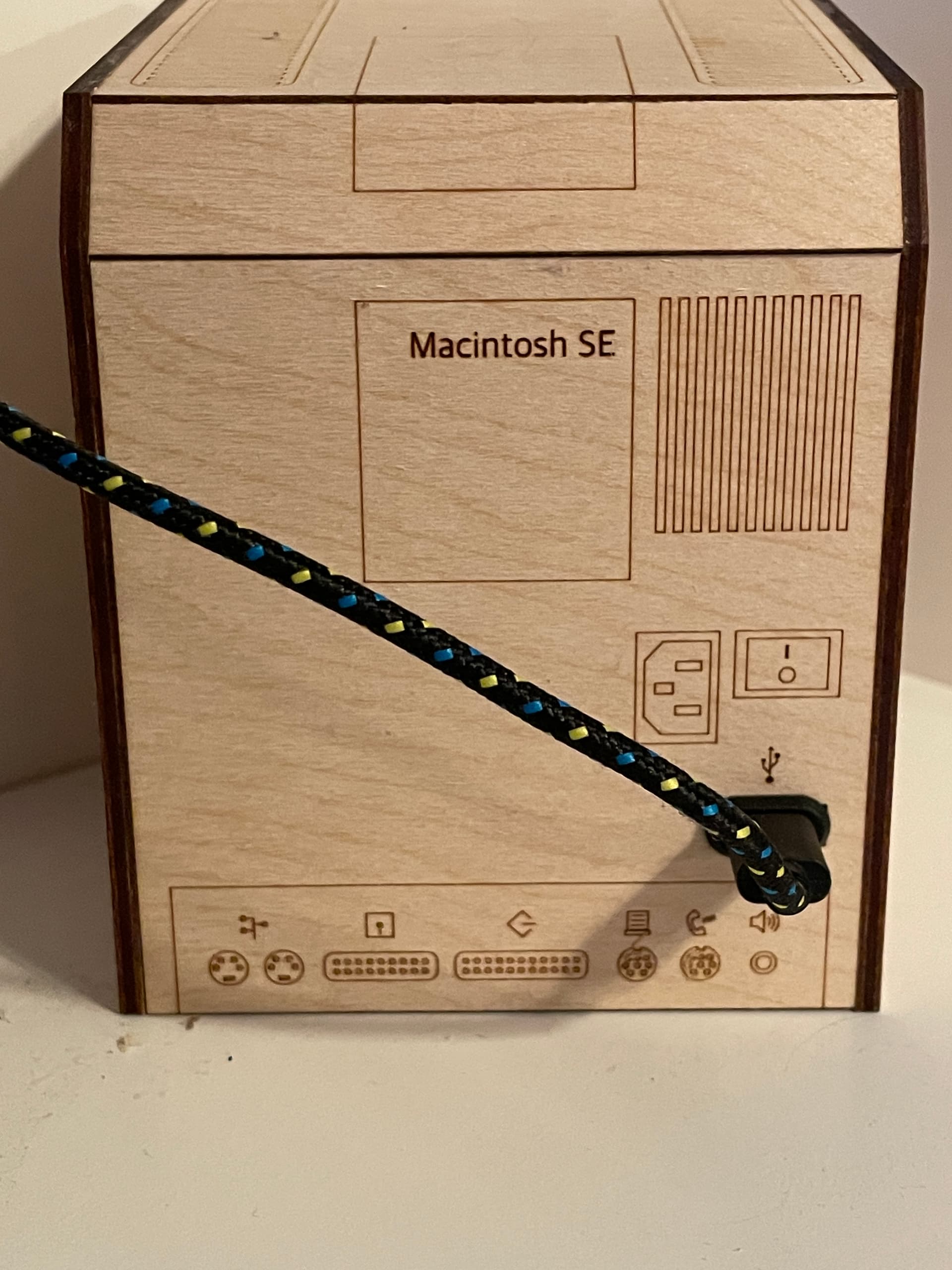

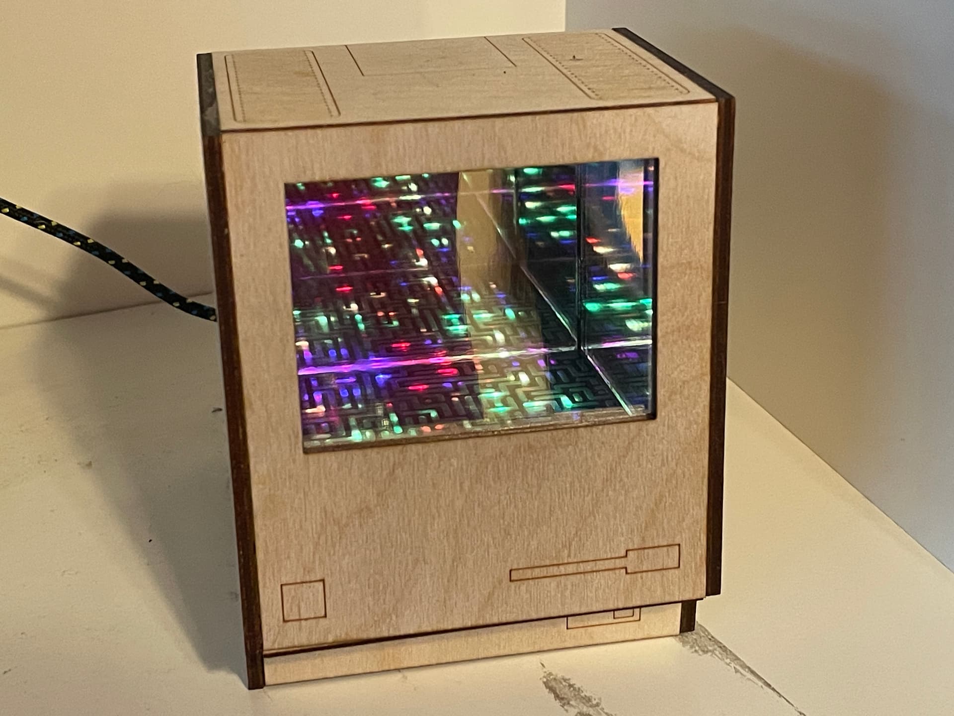

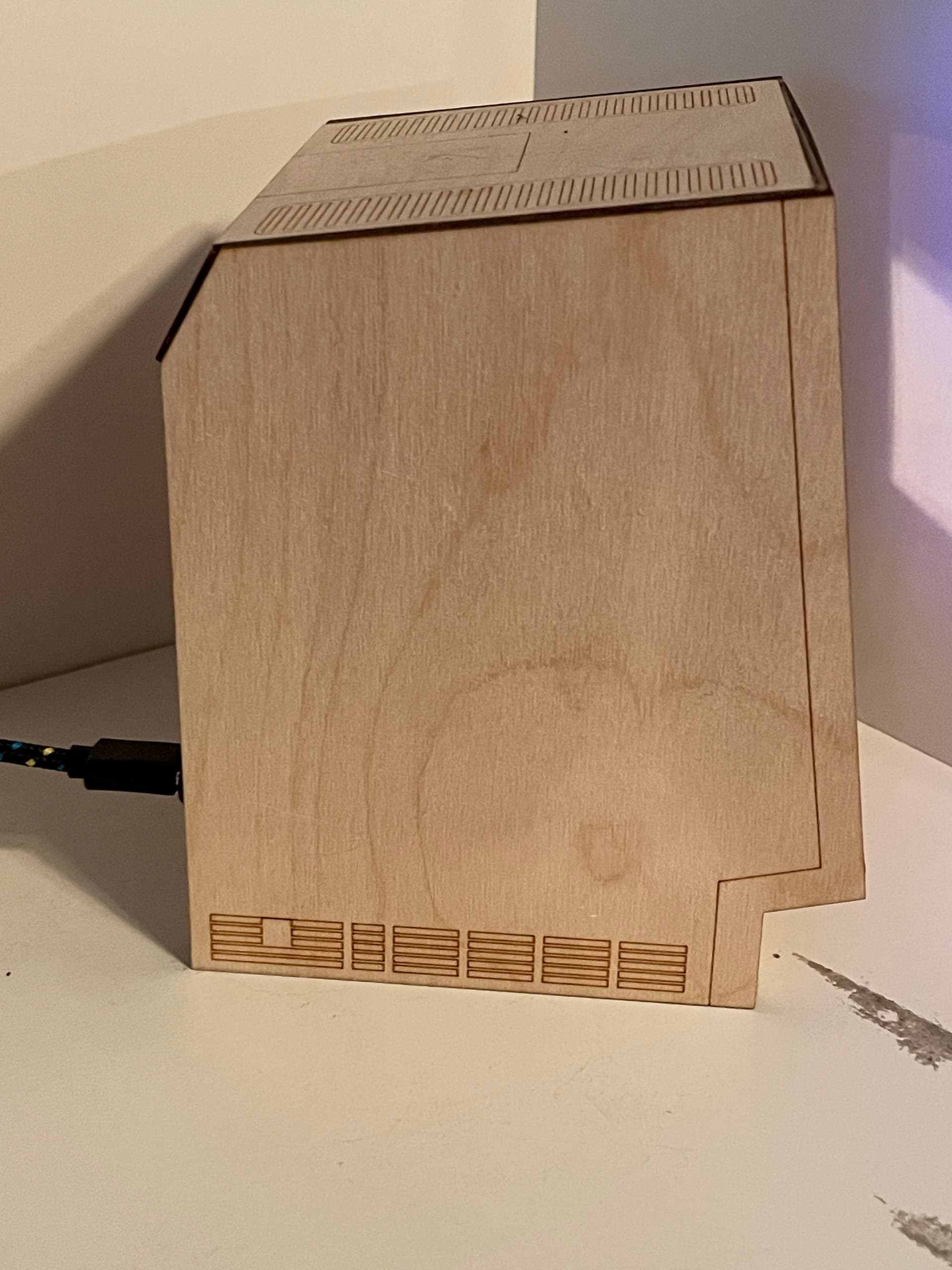

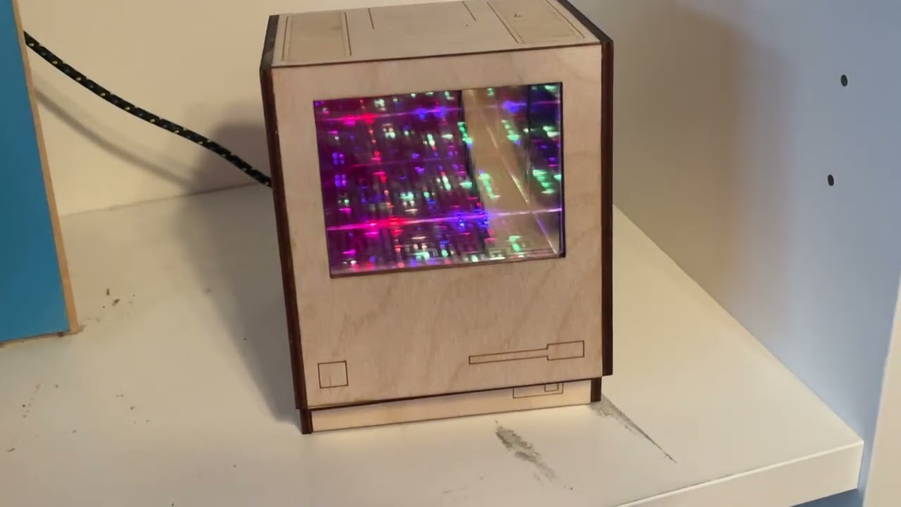

I made a new blinky thing (short video at the bottom).
The case is a wooden version of a Mac SE and it’s about 6 inches tall.

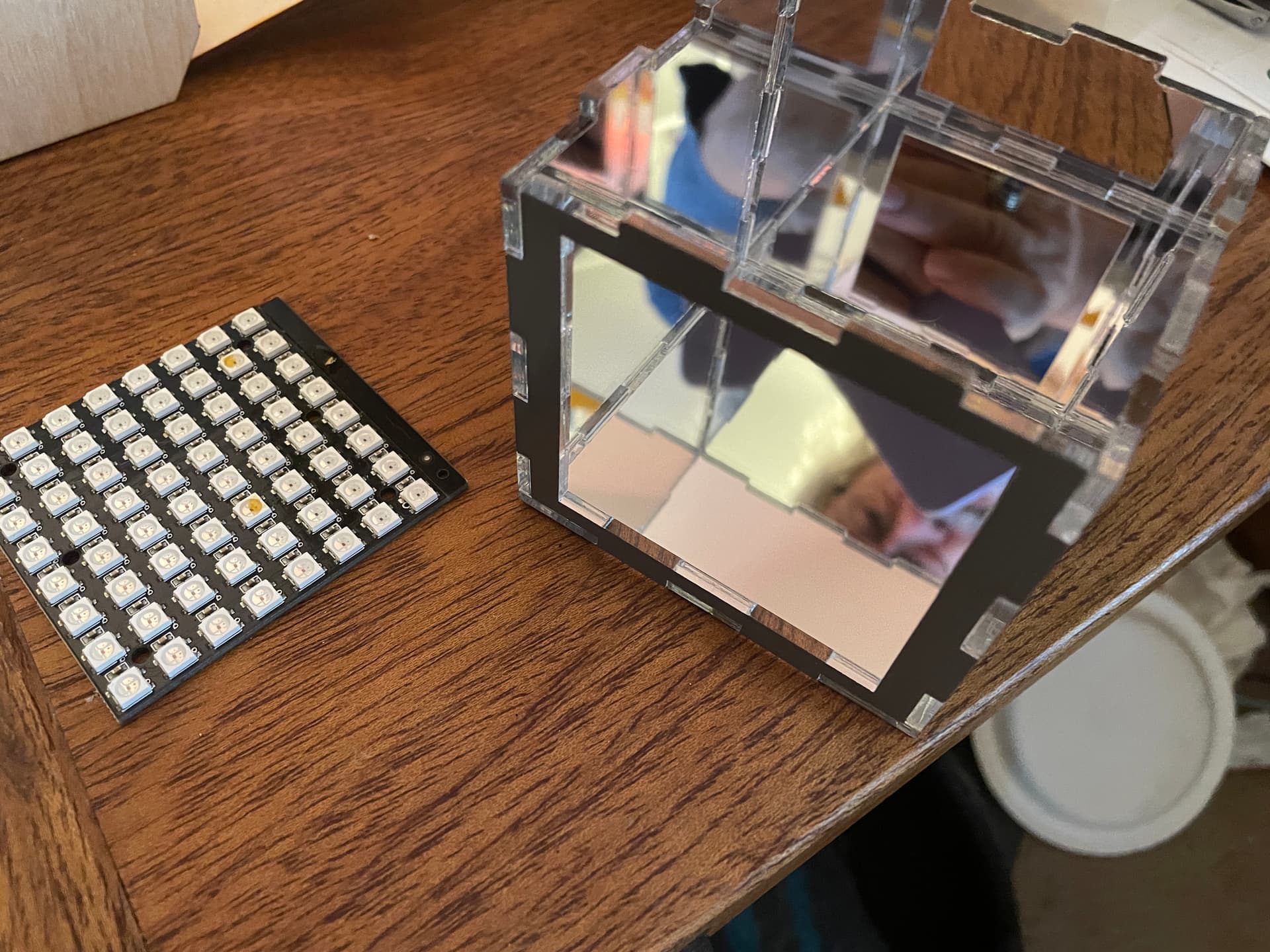

The innards are a cube with acrylic mirror on 5 sides and a two way mirror in front (standard infinity cube stuff).
An 8by8 LED matrix sits on the bottom with a clear acrylic maze pattern over the top. A pixelblaze nano powers everything.
It is really pretty in action:
