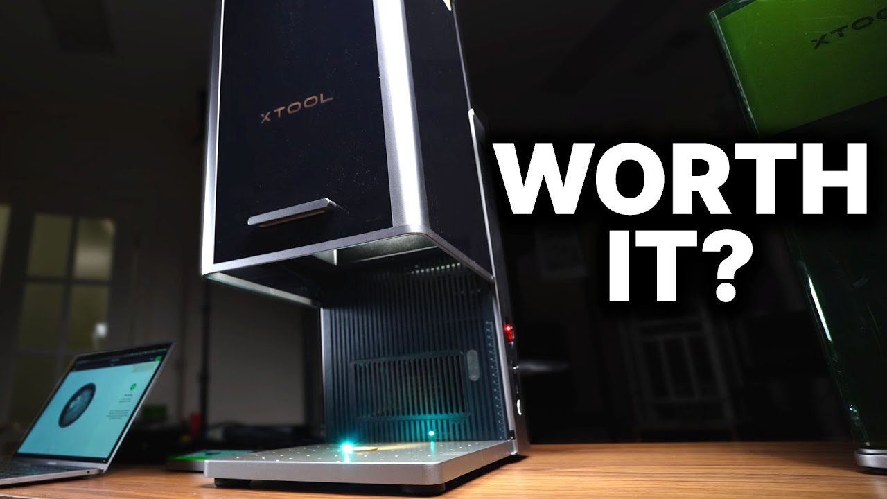

The one that’s piqued my interest in the past month has been the xTool F2 Ultra. Strength of a MOPA Fiber Laser to actually cut through or engrave metal. Controllable frequency to do color engraving on stainless steel. Heightmap relief engraving to fabricate brass coins is mesmerizing. Other demos also show it working with accessories like rotary attachments (tumblers, rings, etc) and a conveyor belt.

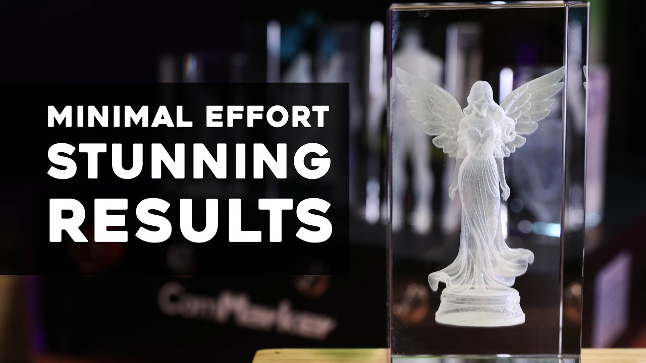

Mr Carve’s M7 doesn’t seem to be the only game in town. ComMarker’s got one to show off too
Here again they mention it being a “cold” laser.. and the thing to glean from that is these 355nm Lasers aren’t doing as much incinerating (??). Lasering on wood appears to leave very little of the charring we’ve come to expect. I’d need to see many more unadulterated examples across different material to get a better sense of the machine.
I can also see circumstances where I WANT to leave a dark mark…. Engraving the inside of a gold ring, for example.

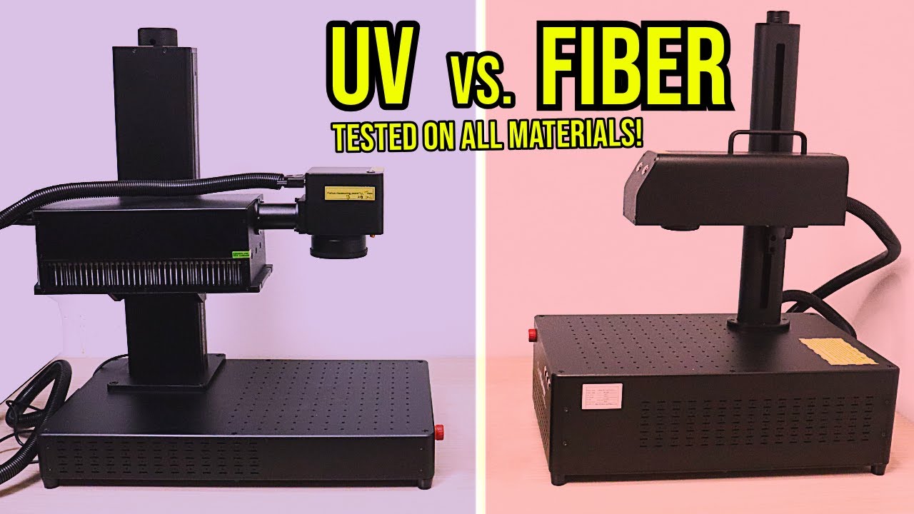

If you watch nothing else today, make it this one.. EXCEPTIONALLY good video covering the differences between UV Laser (355nm) and Fiber Laser.
Days before watching this, it became apparent that if they rolled out a successor to the xTool F2 Ultra (currently MOPA Fiber + Diode) by kicking relatively useless (to me) Diode Laser off the island and rolled a MOPA Fiber + UV Laser (xTool F3 Ultra??) you’ll find me at the side of a highway…..
