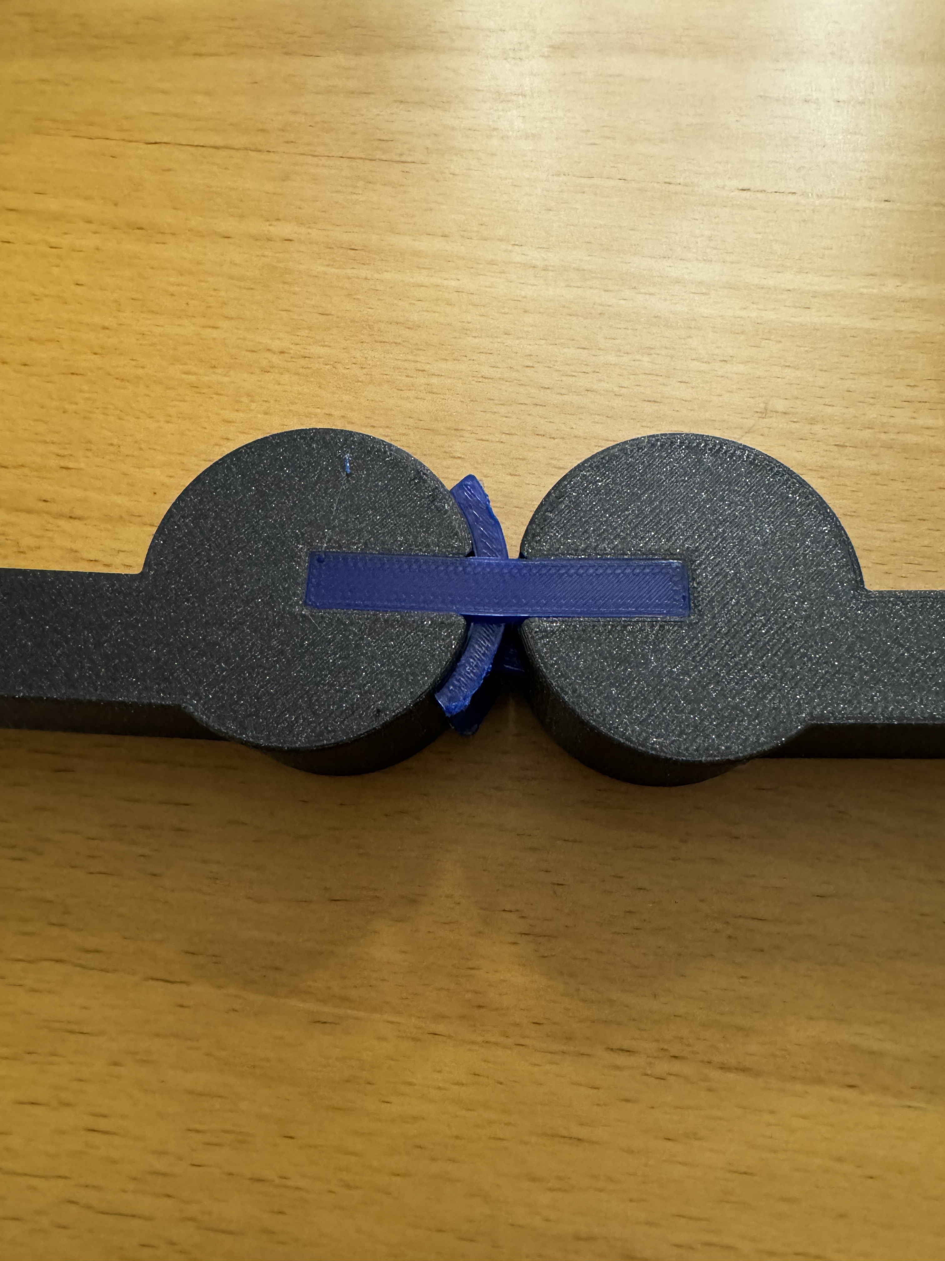

First knee done and works better than I thought. Handing it to the orthopedic surgeon to try out for corrections to tendon thickness (how we vary tension). Then we can make versions with pathology. Need to switch pla for polycarbonate or nylon-cf as the torque on the shafts is very very high

Can I get my surgeon in touch with you for parts?
Yes, the infamous “poop chute” on the Bambu does waste a lot of filament. That’s the advantage of the XL being a tool changer rather than filament switcher (purge vs. prime - purge being like 10x more wasteful). As far as time-lapse yes that’s nice, although in the past I just used the raspberry pi’s camera to do it which was also watched by Obico’s spaghetti detector AI. For the XL just have a webcam watching it
That being said the Prusa XL is not a starter printer, in the prusa line the Prusa Mini+ would be a perfect printer to learn on. The XL 5-tool monster is an industrial printer with a complex workflow (mostly all the placed you need to remember to assign tools to things), but pretty much if you want to print something simple like “I want to print that model on thingiverse” you can let Prusaslicer (or whatever your modern slicer is) take care of itself and load filament and hit print. The big thing that trips newbies up is managing supports (for overhanging parts) and what you can get away with (tons of videos on youtube). For the knee model above I used “organic” supports that look like little trees and they support material was a different type of plastic that the item being supported (PLA and TPU are chemically incompatible so won’t stick to each other which was what I wanted) but day one you don’t need to worry about these things
