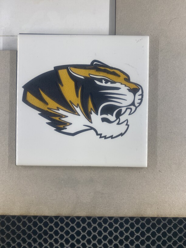

More experimentation using Norton’s tile method.

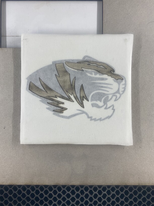

The vey first thing I did was make a jig so I could get the best alignment possible. Both of these tiles were painted, engraved and then repainted and engraved for a second time. My blacks are much darker. I then returned it to the GF without paint to “etch” off the glaze before adding color.
(I know, I know… it’s another Chiefs thingy)
I got impatient and removed the masking while the paint was too wet. It smeared a bit.
I masked then did the final engrave.
Yellow pain applied and then back to the GF for a score around the yellow to get some smoke marks for shadowing (it didn’t work like I thought, oh well it’s a test)
Did I happen to mention I’m a Missouri fan too?
Edit - I forgot to mention, the paint treatment for the first engrave was Rustoleum Flat White, the second was Rustoleum Gray Primer.

I want to make sure I’m understanding what you’re doing correctly. Tell me if this is right:
  1. Start with a Norton method engrave (i.e., you paint the tile, engrave, then wash of extra paint)
  2. Mask the tile, engrave certain areas, which removes the tile glaze from those areas, which prepares it to be painted?
  3. Paint the whole thing with the nice color
  4. Remove the mask
  5. (optional) score for fancy shadow effects =P
Is this right?
Really cool work.
Yep, made the jig before I started. I made it out of heavy card stock that I bought from a local paper company, cheap and easy to cut.
Thank you. I make my jigs with straight edges to butt up flush to the edges of the crumb tray. After I figure out the placement of my cutout and before cutting, I register a mark on the jig that aligns with one of the permanent marks I have on the crumb tray edge. That way I can remove the jig any time needed and return to the exact (we know nothing is exact) spot.
Thank you. Yes, except for these two I did step 1 twice. First with the white paint and next the gray.
