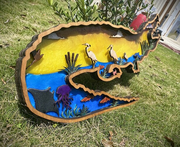

Okefenokee Gator
6 layers of Baltic Birch and all layer’s resin’d.
(If anyone knows how to avoid resin drops that I have to Dremel off the back of the delicate pieces please share so I can avoid that nightmare again).

Love the layers! Did you design it or working from a file?
36” x 18” and not fun using the pass through. But I have plenty of gator pieces laying around now.
Baby olive tree.
Found the design on Etsy.

If I understand what happened - keeping masking on everything that isn’t getting resin might be an easy answer…
Thanks! Masking the back helps a lot on the big stuff but those willows and birds …. No fun.

I mask both sides of the wood prior to cutting and leave the masking on the back of the pieces. Coat with your resin. Wait 24 hours and use a heat gun to warm up the resin on the back of the pieces and peel off the tape. It takes some patience, but it will come off. I have even used my exact knife to help trim it. Just be careful not to slip and scratch the resin you aren’t trying to remove. You may still get a small amount, but no big globs and a light sand will take care of that.
Great advise! Thank you.
