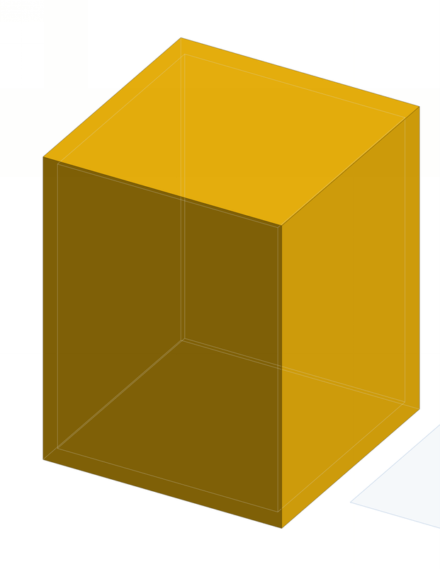

I decided to focus on OnShape. It seems like a relatively easy piece of software, and based on the demos and such it looks like everything is pretty much automatic. However, I’m having a hard time reconciling the “sketch” vs “shape”. I get that I need to draw a rectangle sketch and then extrude it to a shape. But I can’t figure out the interaction between sketches and existing shapes. Example, I have a shell (roughly a 3"x3"x4" box with 1/8" thick walls). I want to split that shell into two pieces, a lid and base to make a box. I don’t want a straight-line however, I want an angled edge to my box. Here’s the part in Onshape:

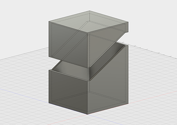

And here’s the part with the cutting plane that I would like drawn in…
(I drew this in BlueBeam).
I can’t figure out how to do this in Onshape for the life of me. Heck, I can’t even figure out how to snap the sketch for the cutting plane to the existing object. It is very frustrating. I suppose perseverance and devouring any and all videos that I can find are probably the key. I am relatively certain that, as limited as my 3D AutoCAD skills are, I could probably whip this out pretty quickly.

Can you publiclly share your Onshape document and post the link here? I, or another Onshape user here could then use that doc to create the parts you want so that you can see one or more ways to do it. You could also try posting on the Onshape user forum and someone there will probably do an animation showing how it is done.

See this public document for a couple of ways to do what I think that you wanted.
https://cad.onshape.com/documents/57ab822fe4b01d53a1c99780/w/8484890858d8dc4606426fa9/e/affd33596f1033b3efd6b18b
This is just a copy of your public document and the 2nd two Part Studios each have a different way of make a box that is split into a bottom and a cover.
The first one creates a 2.75-in cube with a sketch and a subsequent extrude. This is just a solid block. A sketch is then created on the side cube to add a line that intersects the right top corner on the side face and a point 0.75" down from the top on the left hand side. This new line is then extruded into a surface that extends through the depth of the box. The new surface is then used to separate the block into a lid and bottom with Onshape’s Split command.
My second approach starts with a sketch that outlines the side of the box and includes the line that defines the boundary between lid and bottom as seen in profile. The lid and bottom are then created in separate extrudes, with one extrude using the triangular sketch face that defines the lid profile and the other extrude using the trapezoidal sketch face that defines the bottom part of the box. Note that the separate face portions of each sketch are used for the two extrudes. If you use the entire sketch you will just end up with a solid box.
You could also create lid and bottom as separate sketches and extrudes.
Hope that helps and doesn’t make things more confusing for you.
