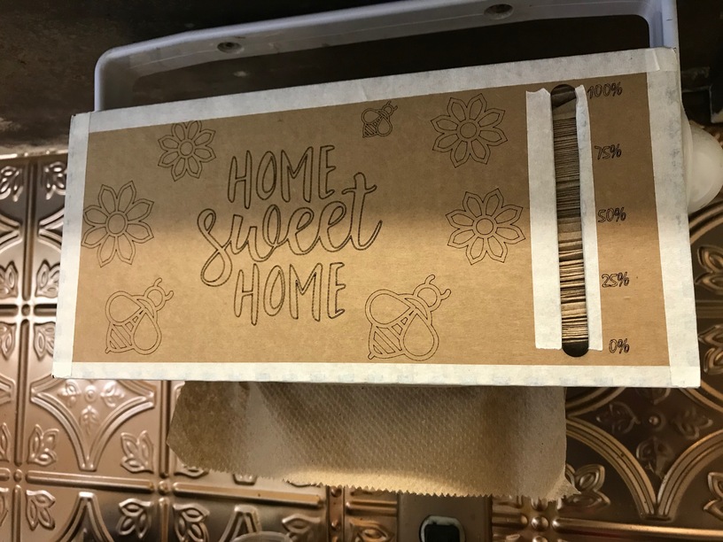

Finished product.
Side view with hole.

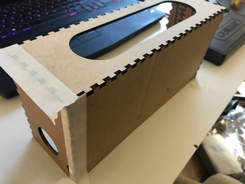

I’ve decided that the bottom piece would need to be made of a more durable material, because pieces of paper would need to be pulled out of it and there’s friction. Cardboard box just won’t cut it.
The entire box is held together with masking tape for now. Guess you can call this a poor man’s box!
Also, feel free to modify the SVG. I think the hole size of where the papers are coming out should be a bit larger. Mine take a bit more force than I wanted for the papers to come out.

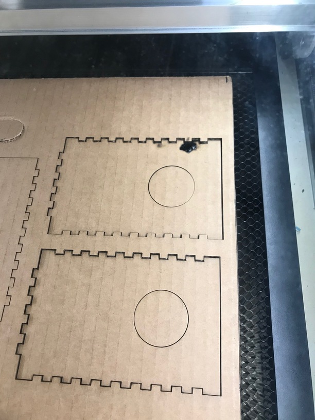

Here are more photos for entertainment purposes only:

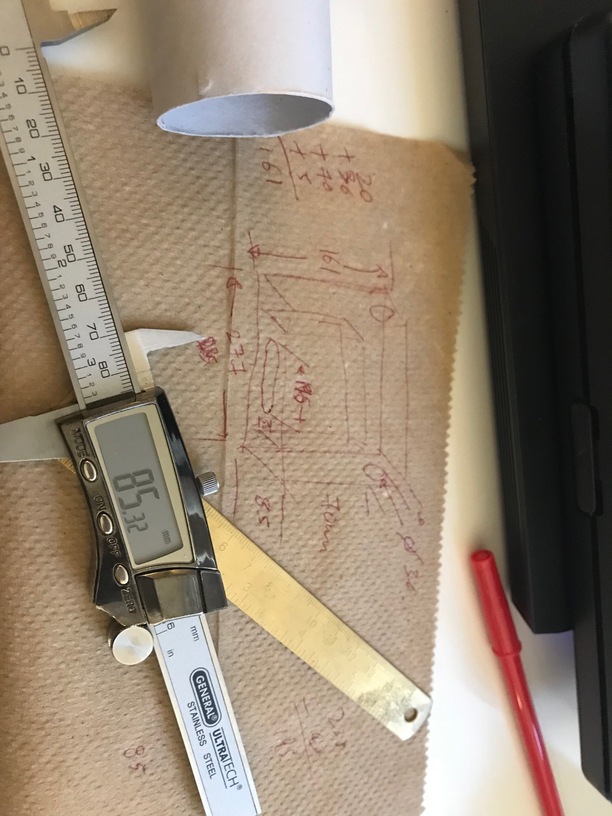

Literally started as a “napkin sketch”.
Cardboard isn’t my favorite material to work with, since thickness varies a lot! Finished piece has a burnt side - thankfully, nothing caught on fire.
MDF “bottom”, with cardboard sides, with masking tape.
