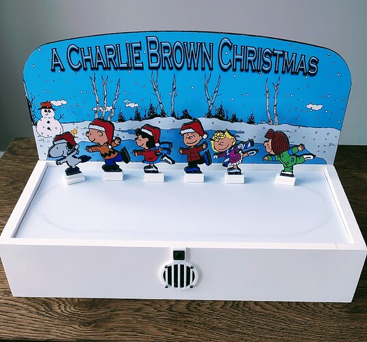

I decided one day that I wanted to blend two of my favorite things: “A Charlie Brown Christmas” and magnets.
So, I spent a lot of time hunting down chain and sprockets for my 3D printer. Also, finding the skater artwork that I could glue to the laser-cut character profiles.

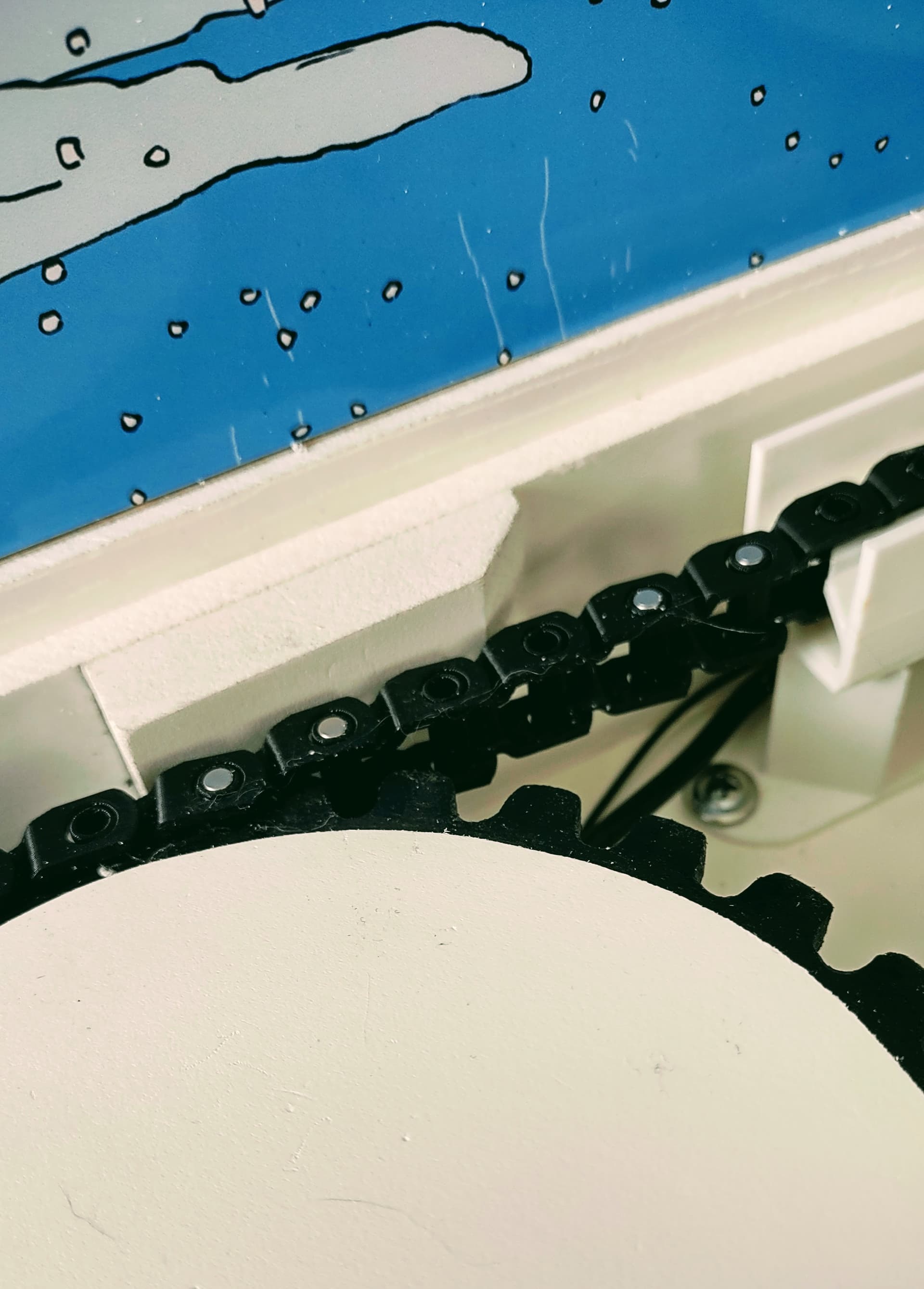

It got a little tricky finding the exact gap needed between the magnets in the chain and the ones in the skater stand. Had to design some 3D printed guides to make that work.
Topped it off with an inexpensive circuit board/speaker to set the proper musical mood when the skaters are doing their thing. All in all, a fun project.

That’s adorable! I too was thinking they were going to cross across the middle - but of course if the chains cross there’s a depth of magnatism issue.
Is the ice just white acrylic? It looks so smooth under their feet!
I love this! So cute!
The ice is white styrene .03 thick. I was worried that anything thicker would dilute the magnet effectiveness. The rod magnets embedded in the links are only 1/8" in diameter by 1/4" long.
