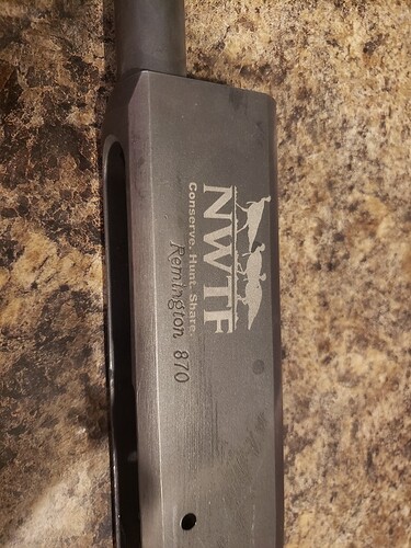

I was trying to find anybody who had used pearl white to mark and came up with nothing so I bit the bullet and ordered some to try it. It works aside from the fact it’s not really white. More of a gold-ish. 750 speed/full power/450 lpi.

If you’re using full power, you need to include what kind of machine you have, because full isn’t the same in the pro vs 45w plus vs 40w plus vs basic.
Sorry about that. I have the pro.
So the remington 870 is a shotgun, yeah?
How much did you have to disassemble your gun to get that piece to fit in there? Scale is hard to tell.
It is a shotgun. Took off stock, barrel, and trigger mechanism. So it was just the receiver. Had to lay it in diagonal to get it to fit.
The stock and fore-end come off with just a couple of screws and, iirc, a nut. About a minute more than a basic field strip.
