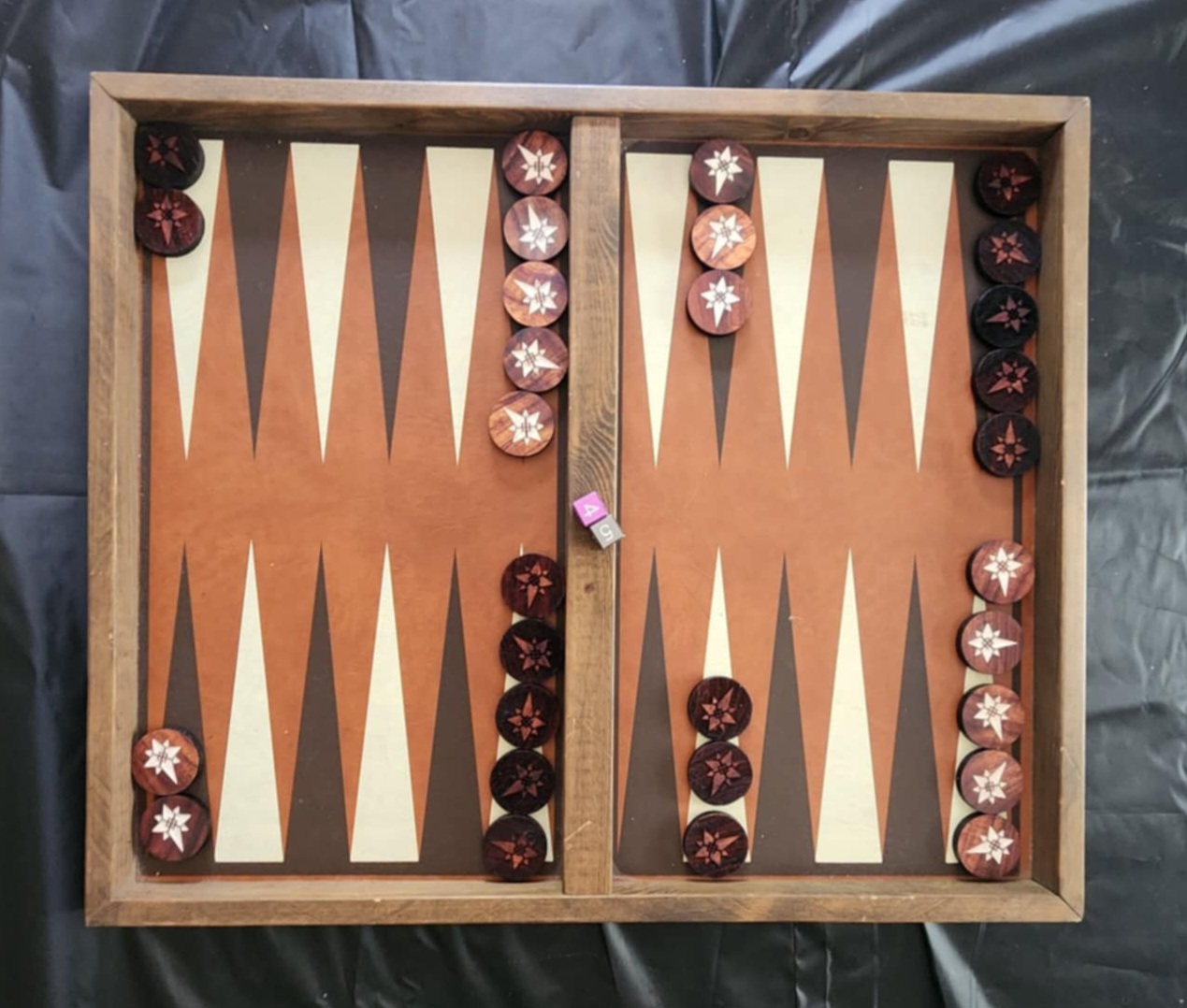

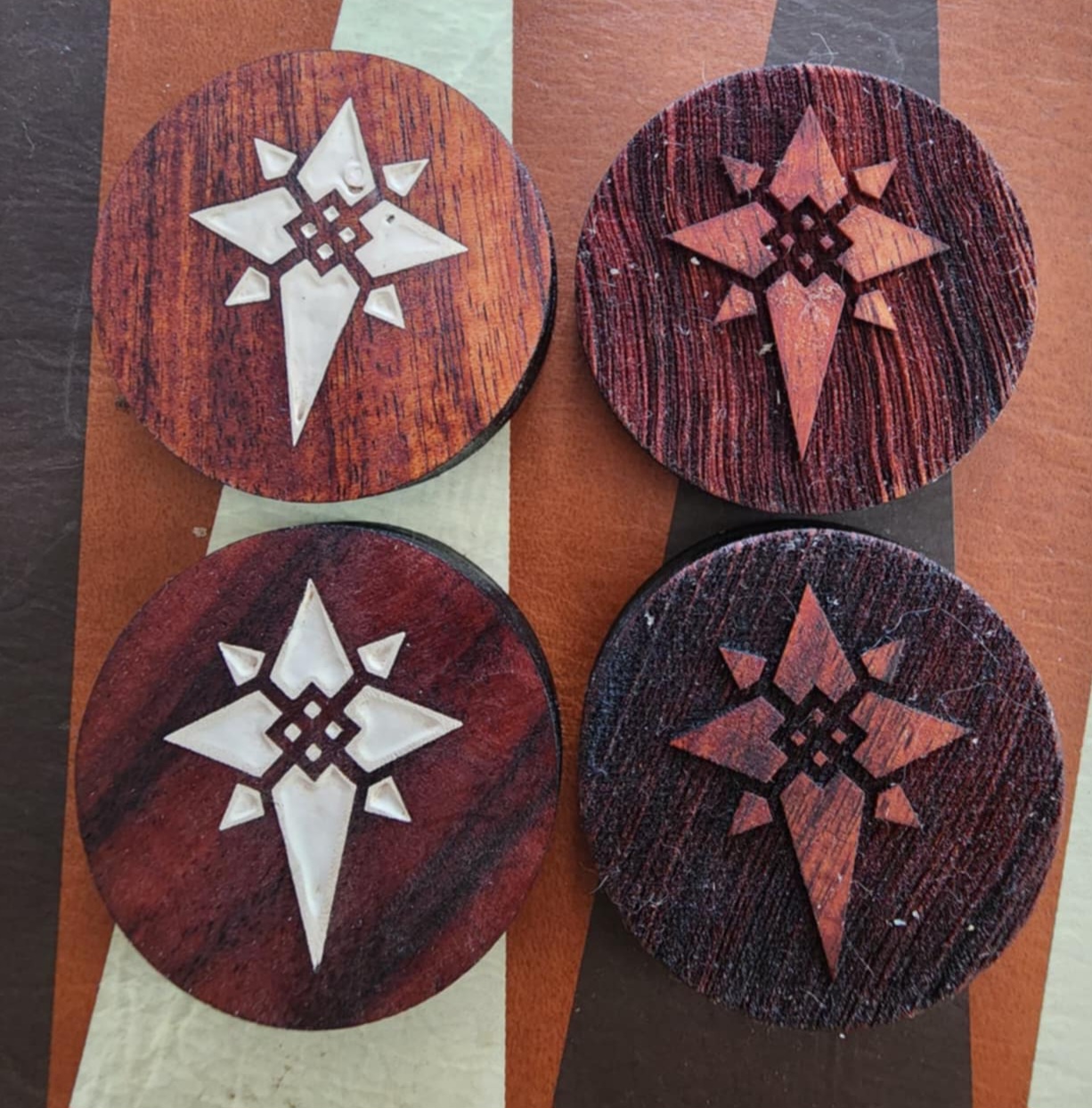

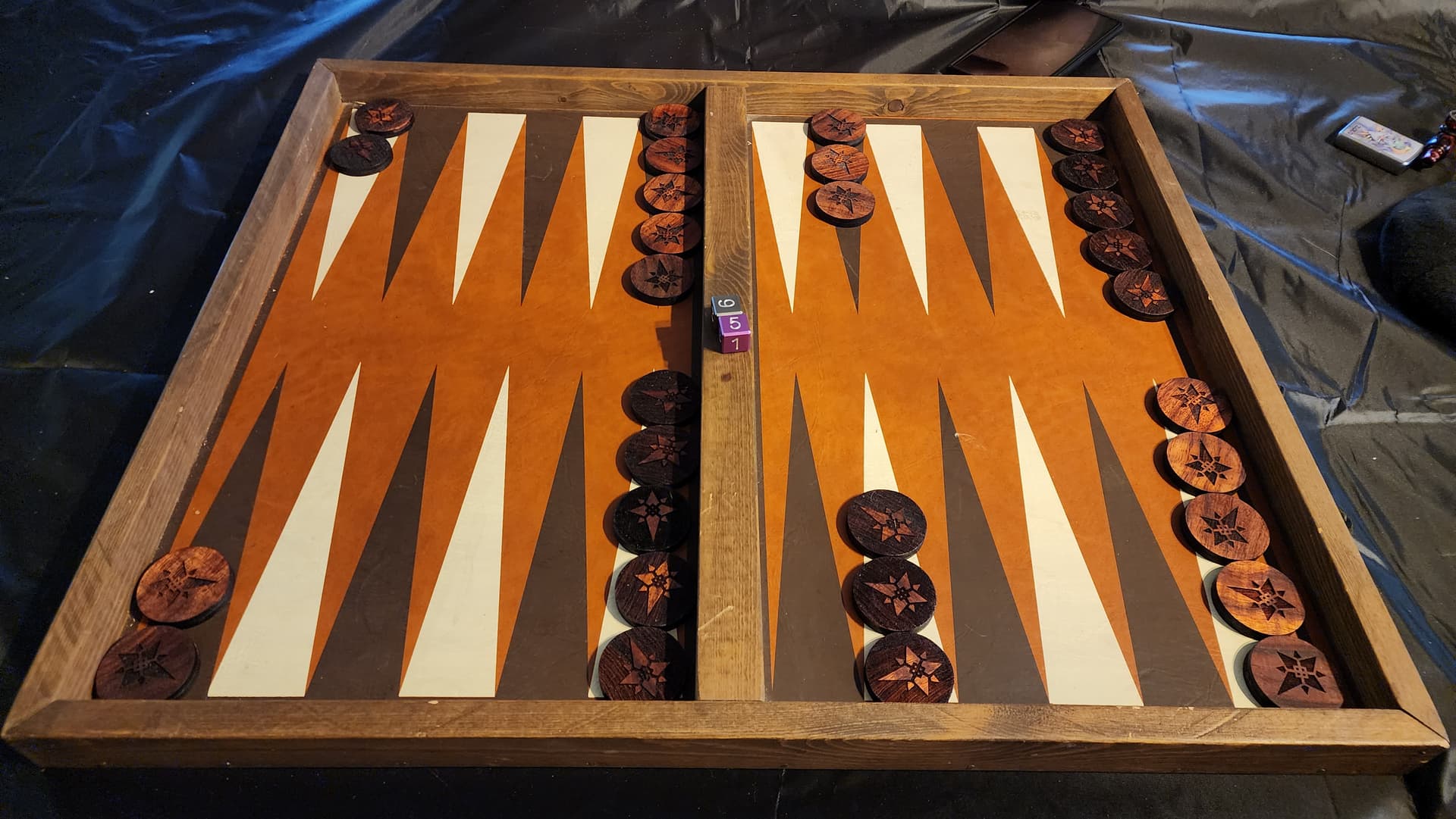

My SO found this cool oversized backgammon board at a flea market and fell in love with it, but it needed pieces.
First I made size samples out of cardboard, and found that 1.75" was the winner.

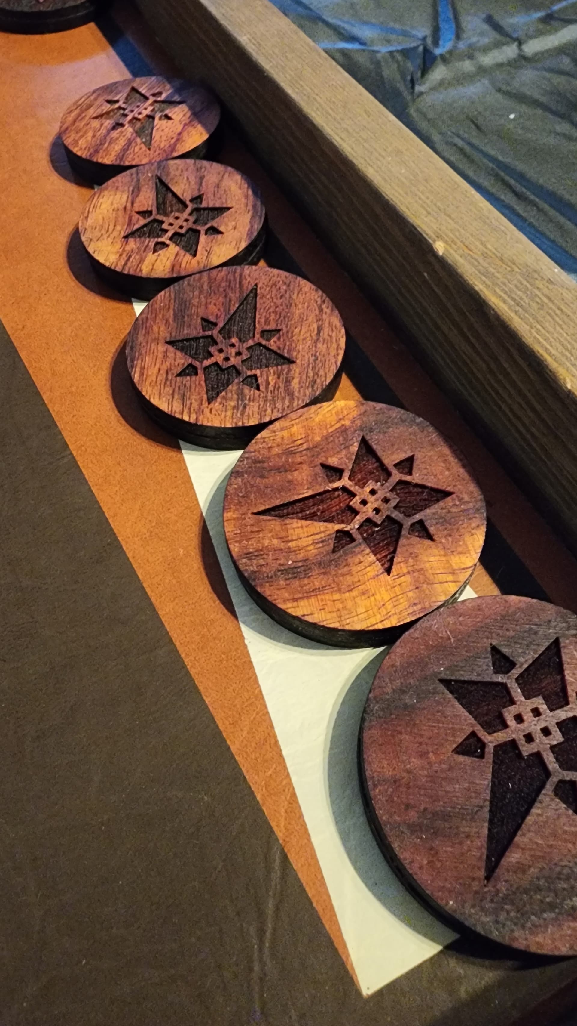

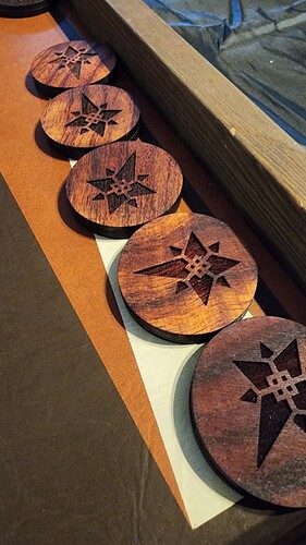

I then took some of the koa I picked up from @amandarogers808 and did a positive and negative engrave of our family’s icon, added a2nd layer of wood, sanded and finished with tung oil.

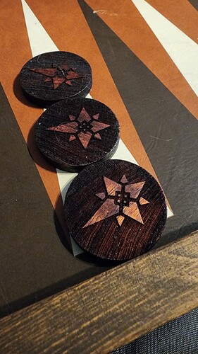

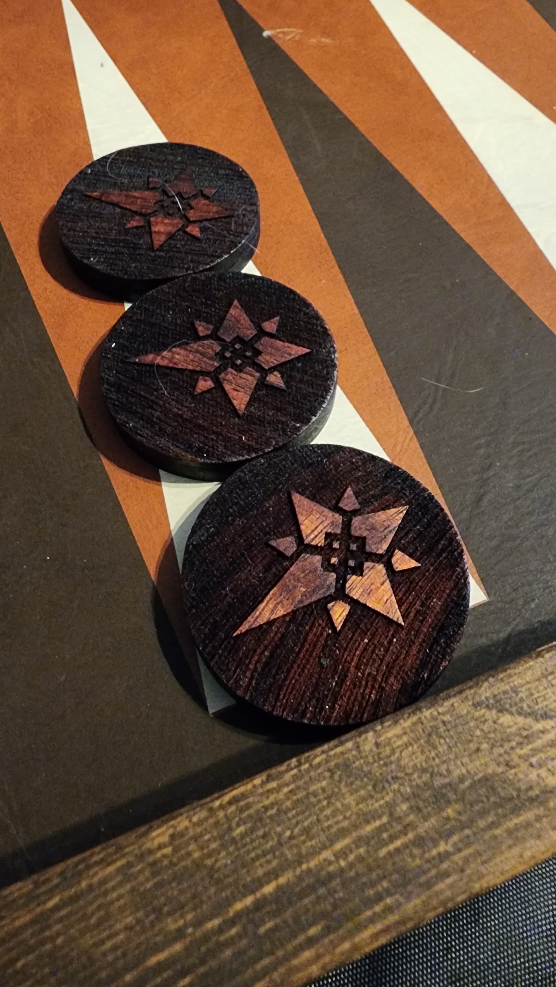

They looked gorgeous, but at a quick glance they were surprisingly hard to tell apart!

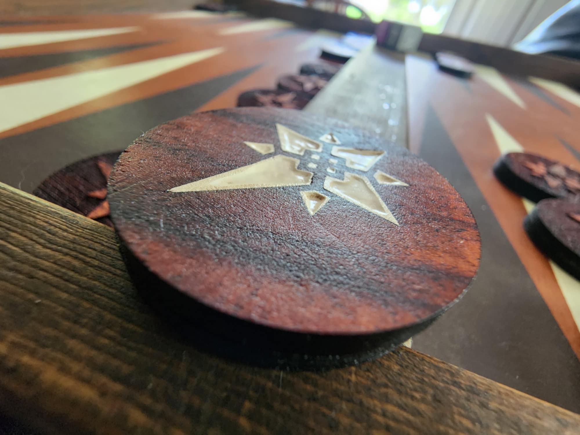

So, as a final measure I filled the positive engrave with white acrylic paint, and now we’re really happy with the whole set :grin:

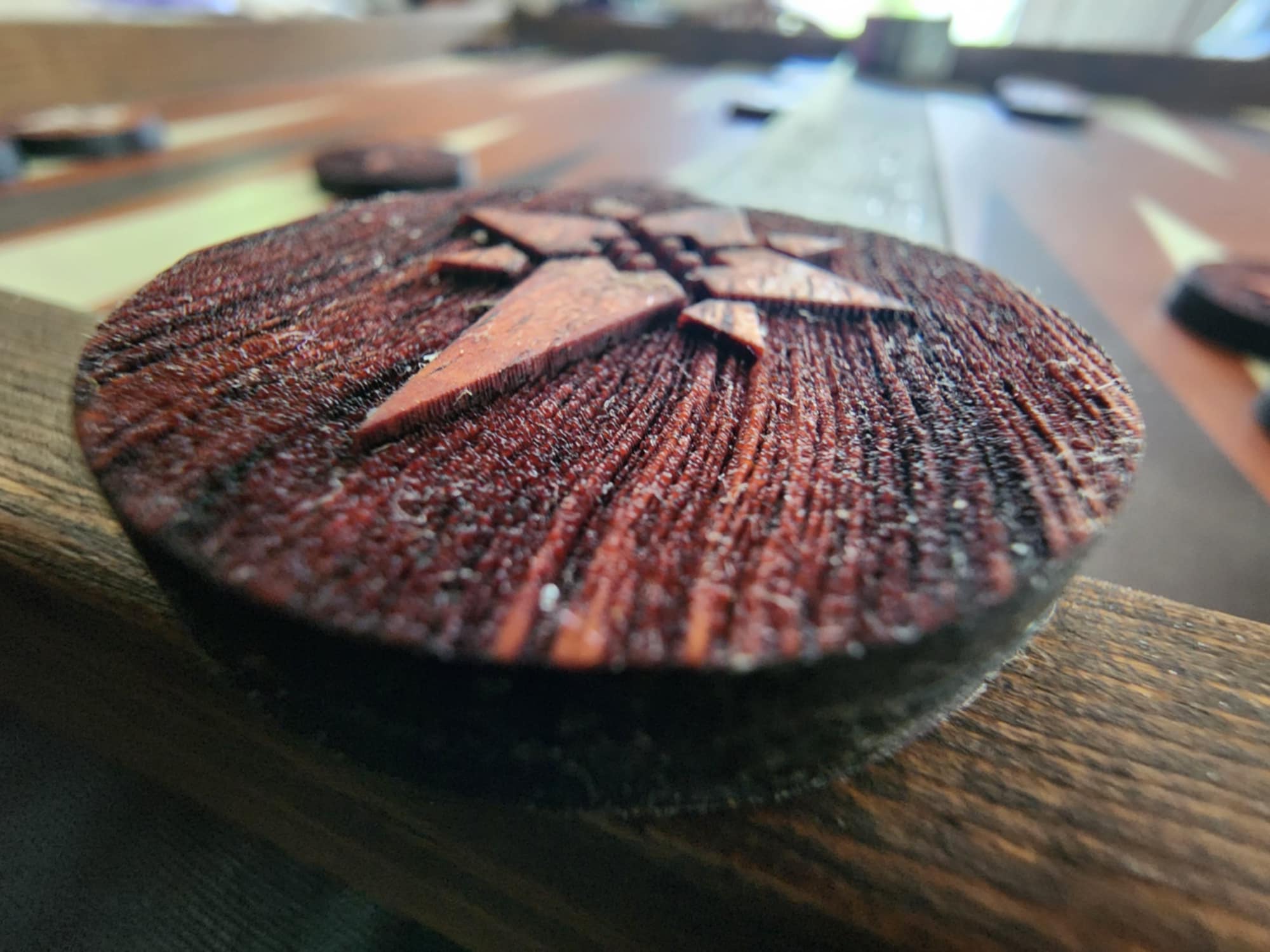

We might eventually do a clear resin over the tops so the dark pieces stop gathering dust in their grooves…but I’m not laying odds on that happening before the heat death of the universe :stuck_out_tongue_closed_eyes:

Nice! These are pretty cool! I think you could spray some coats of clear coat and it would fill in the engraving. I’ve done it before (especially with Rustoleum Triple Thick Glaze, comes out really nice with several coats on it). I can’t use epoxy.
My main worry is that it wouldn’t stick to the tung oiled wood, so maybe after they’ve dried out a bit more…

Through-hole inlay is the move here. Koa on maple and maple on koa. They’d look so good, and they’d be double sided!
Oh and bonus: they’d be much faster to laser than engraves.
Of course then you need to glue them up and sand them which takes some time but I think they’d be worth it :slight_smile:
That was definitely my first thought once we realized we needed more contrast, but I can’t bring myself to abandon these!

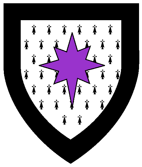

It helps that we both play in a medieval recreation group, so we each had Arms from there, this is a combination of their compass star, and my fret knot. I love it so much :heart_eyes:
