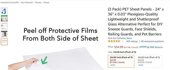

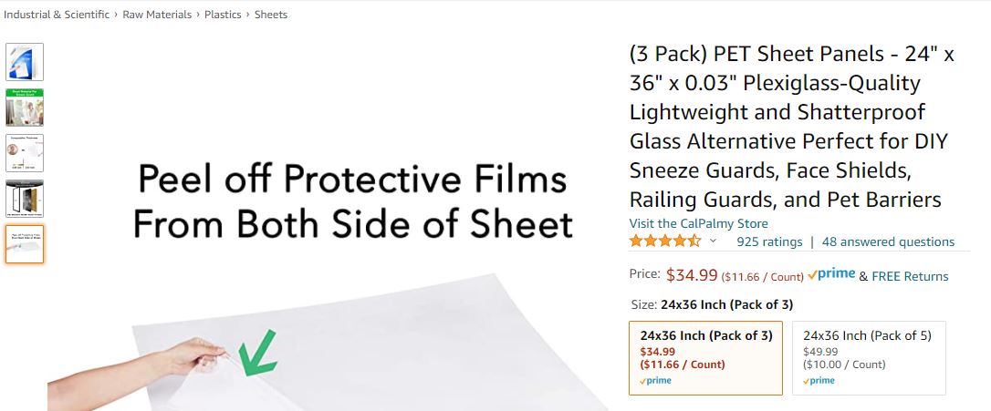

PET sheet from amazon
Anybody used this stuff?
Should be fine cutting, not sure about engraving. Never done PET, specifically but have done other polyethylene.
It is polyethylene terephthalate so not Glowforge destroying or instadeath if you breathe the fumes but it will likely melt easily and likely to go up in flames if not watched very closely.

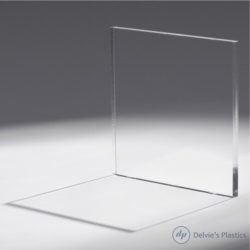

Been trying to find a thin cast acrylic in larger sheets at .05. I can get .091 from home depot but they want something much thinner. Thanks for the info

.0625 nominally… still too thick?
They say:
Nominal 1/16" Thick (actual thickness will be approximately .035" to .062").
Averaging those two extremes lands at 0.048, so maybe right on?

Thanks for the replies!
Is it necessary to peel the clear film that comes on the material prior to lasering?
Not totally necessary but usually preferable to remask with paper masking. The plastic masking can get sort of melty.
