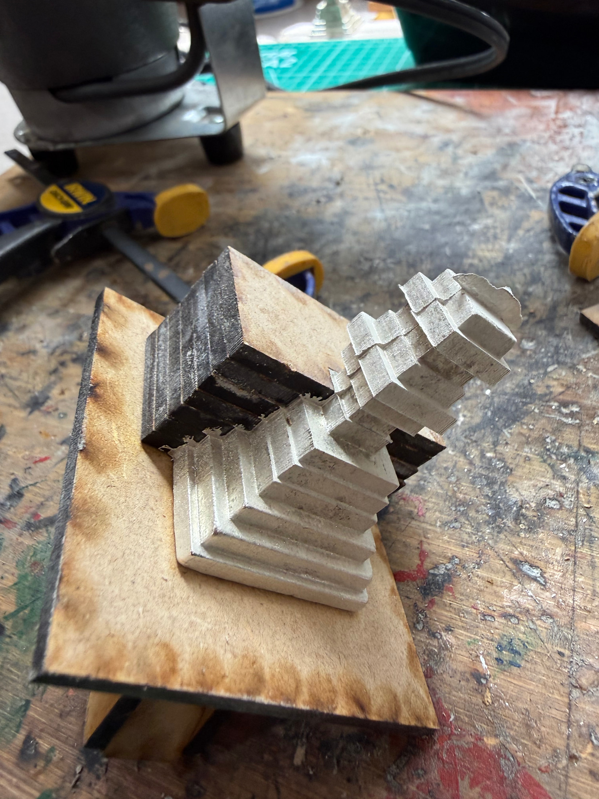

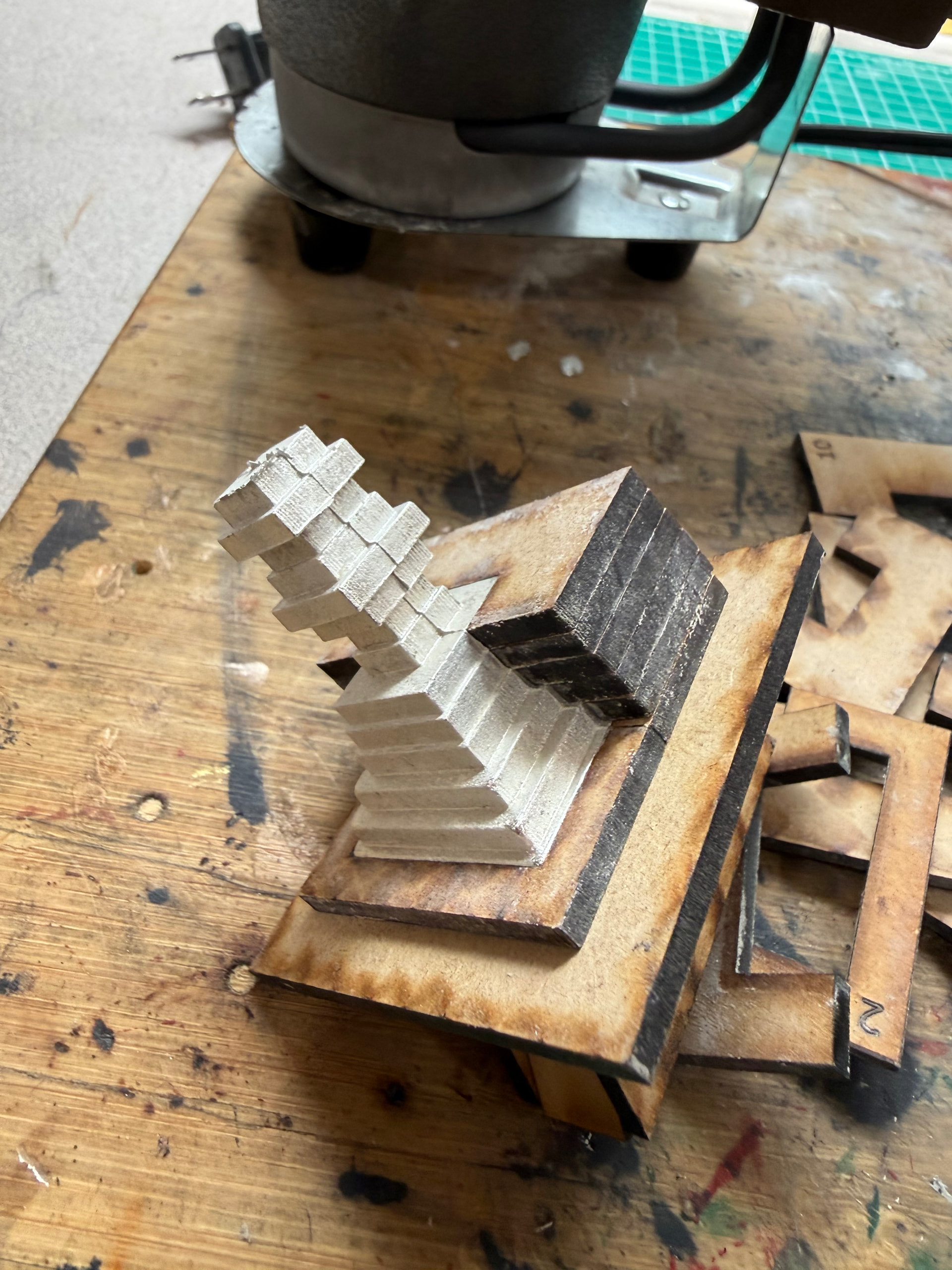

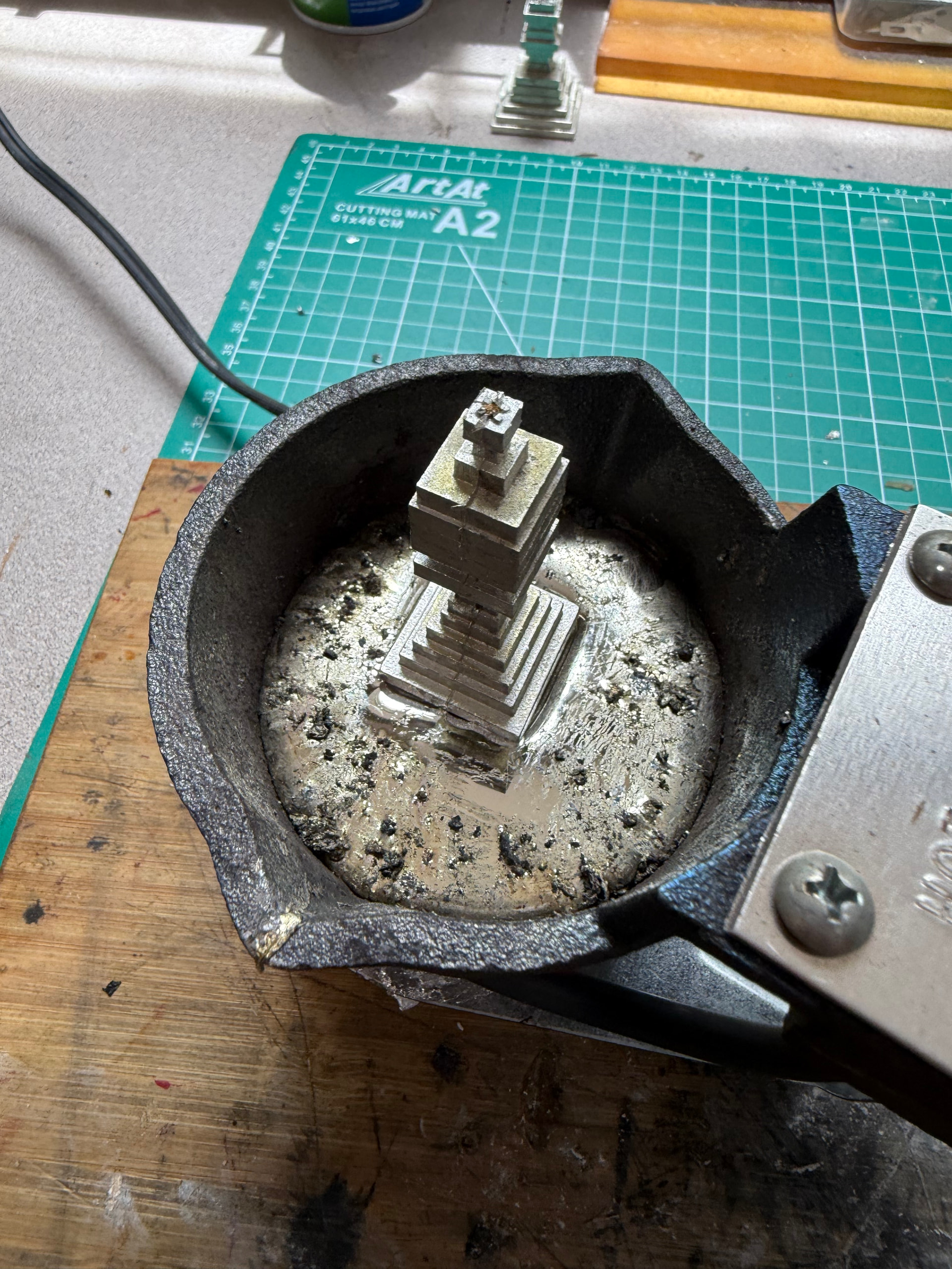

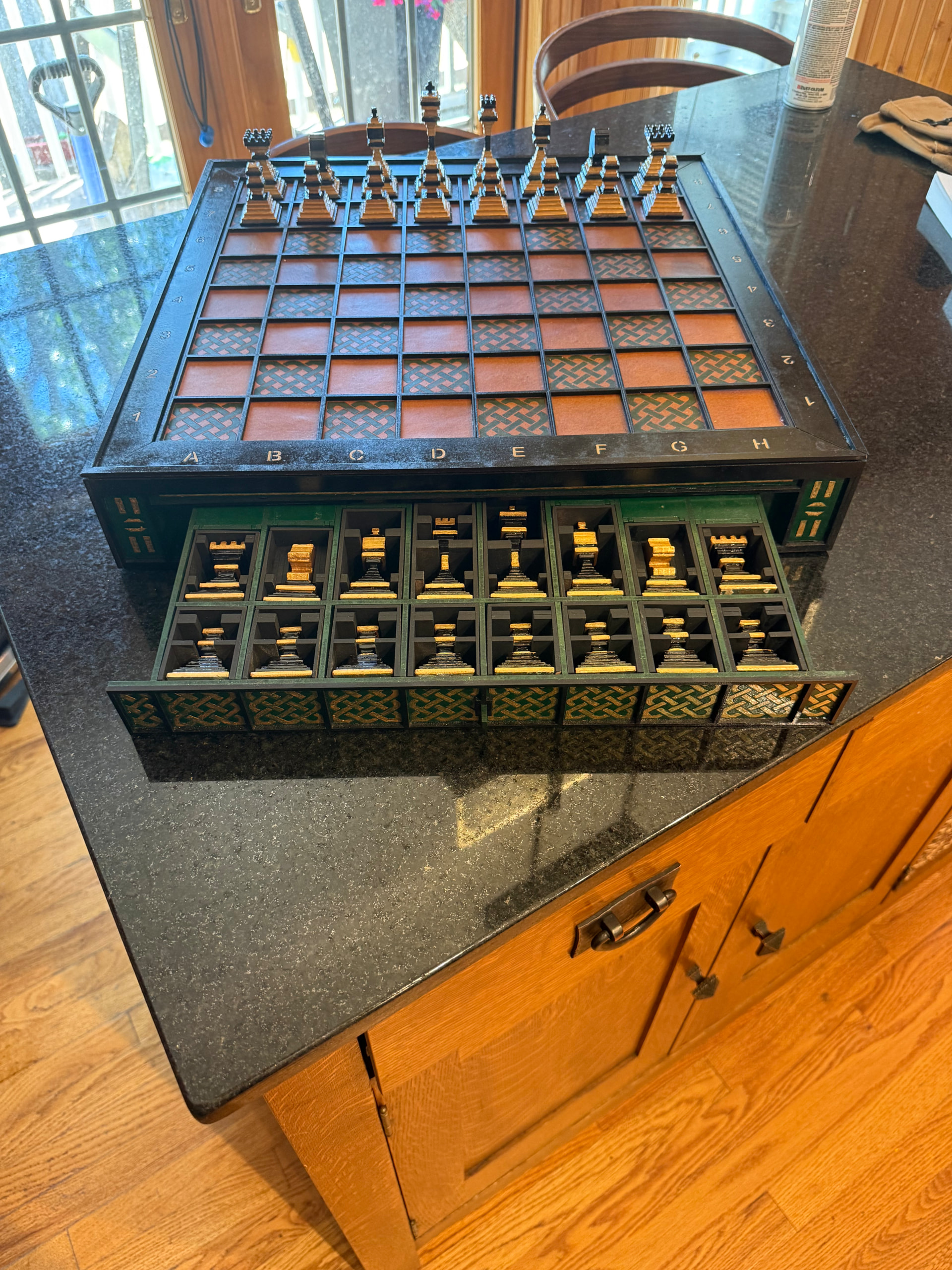

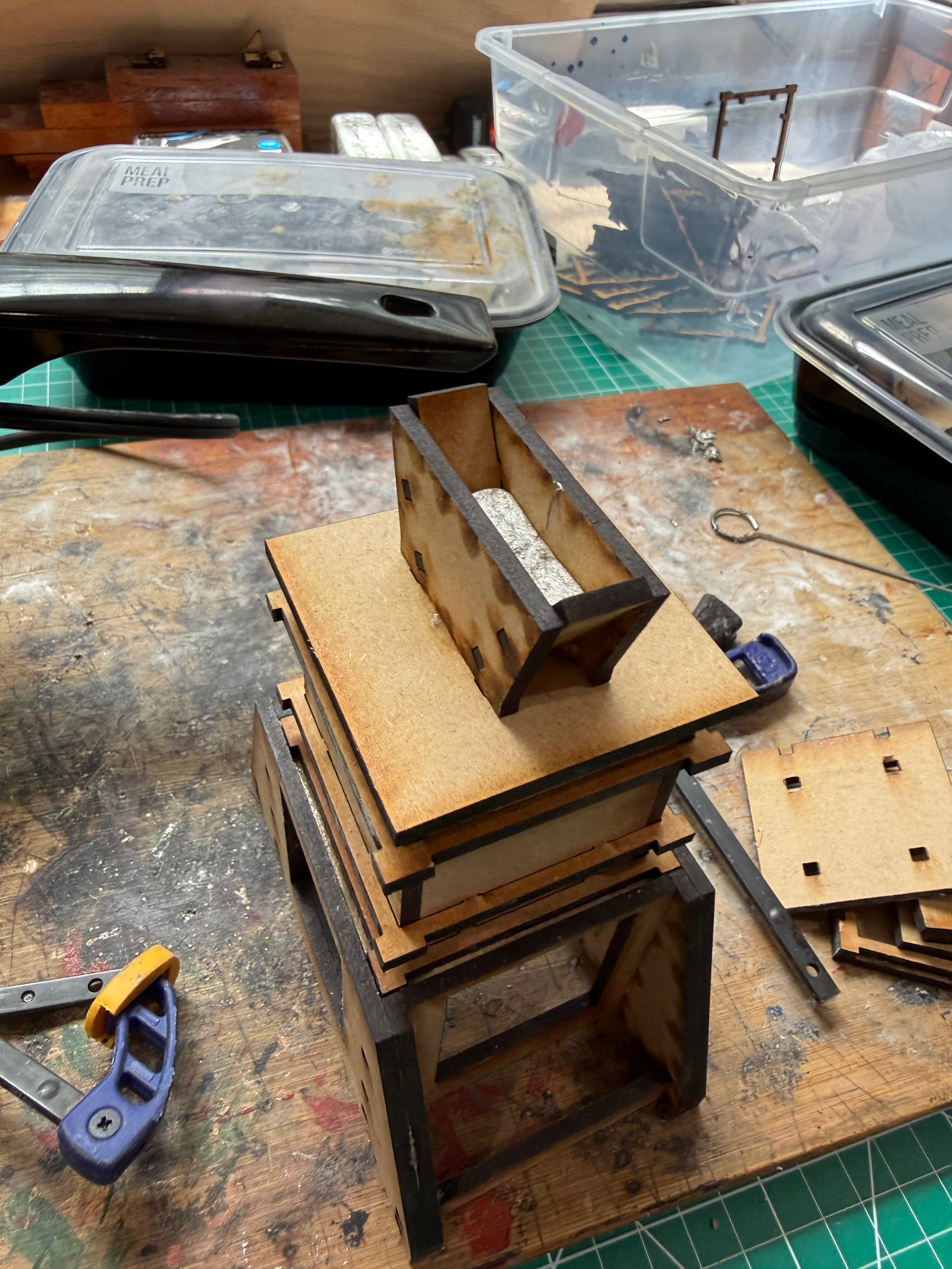

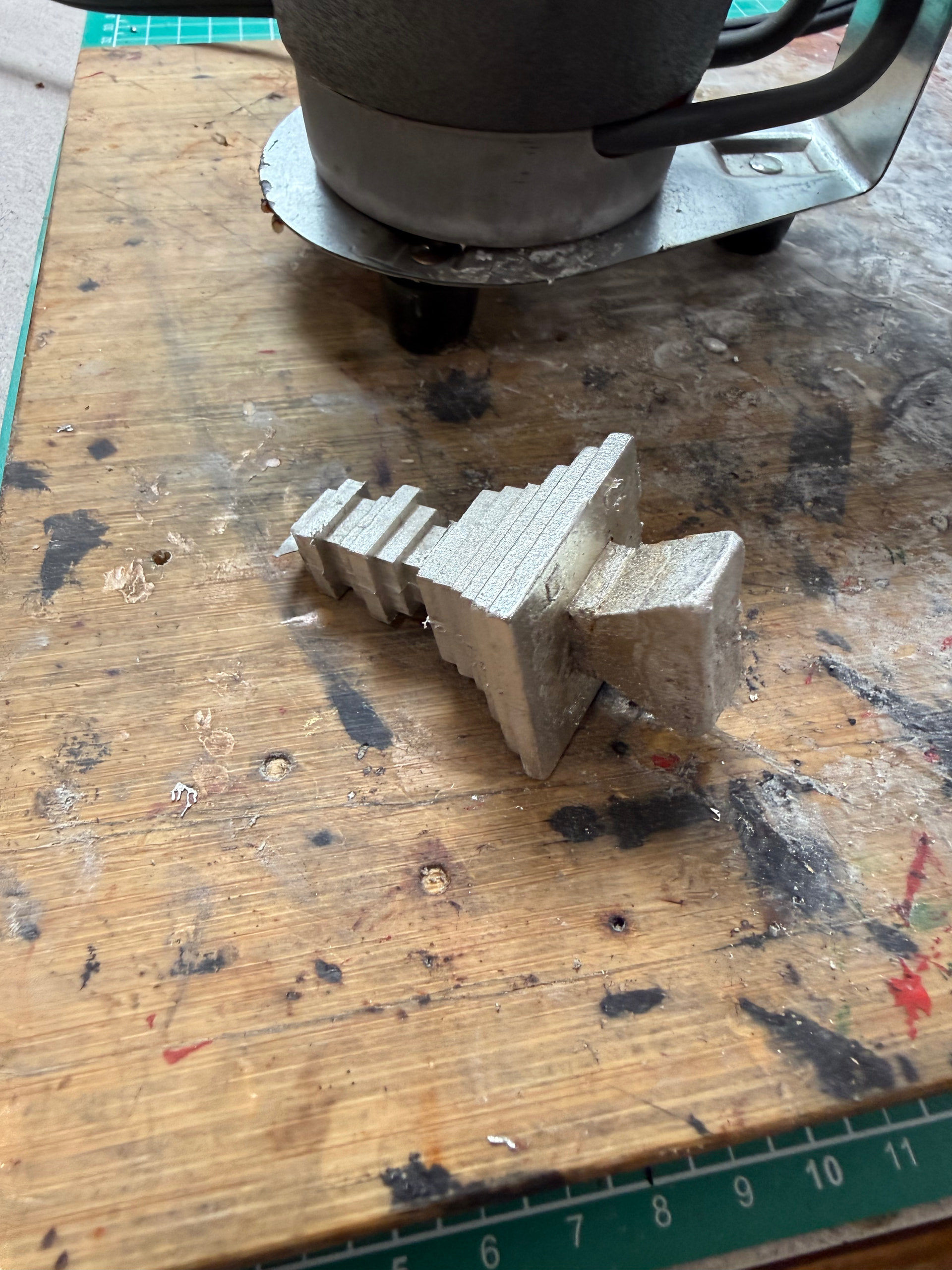

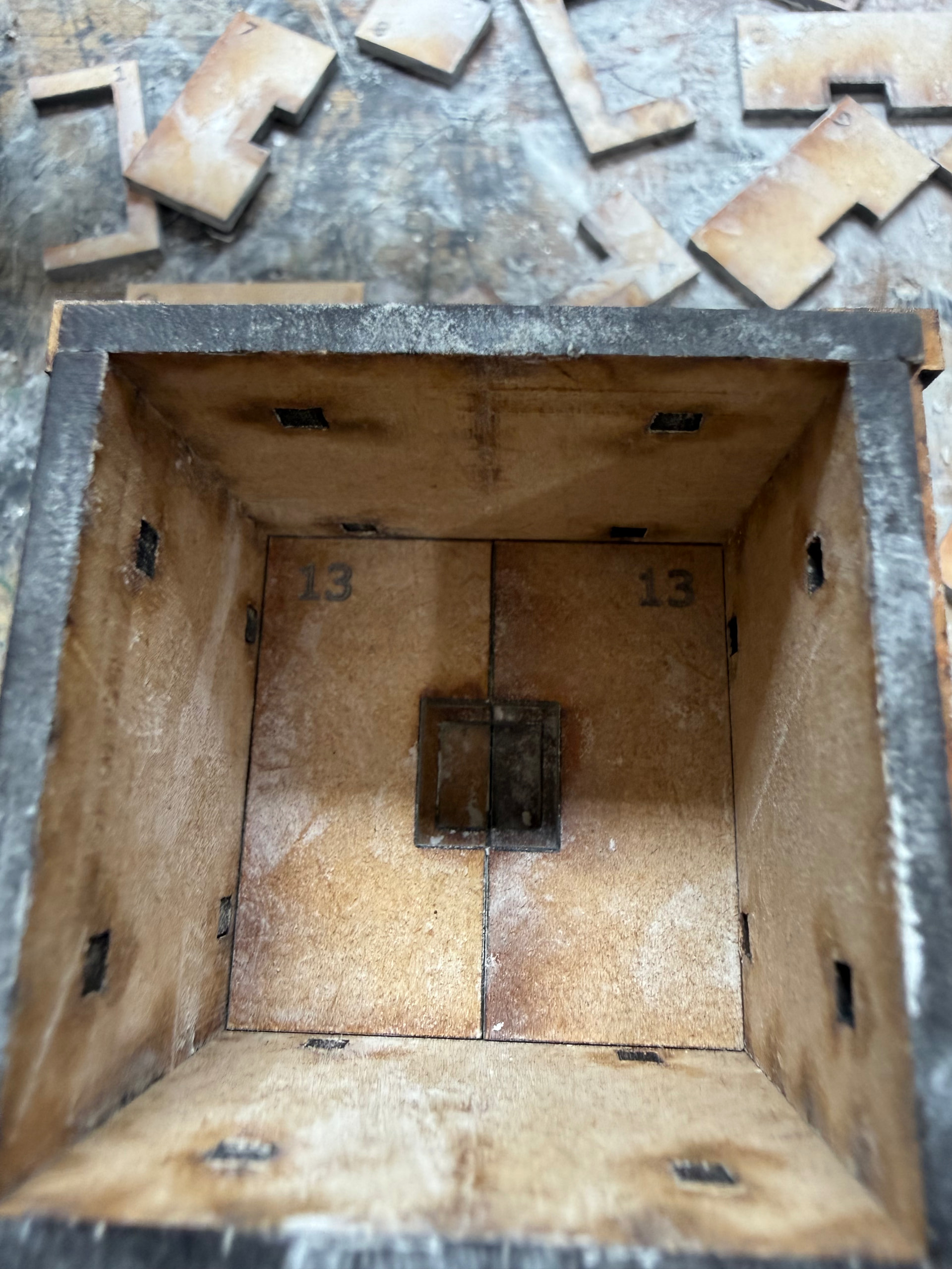

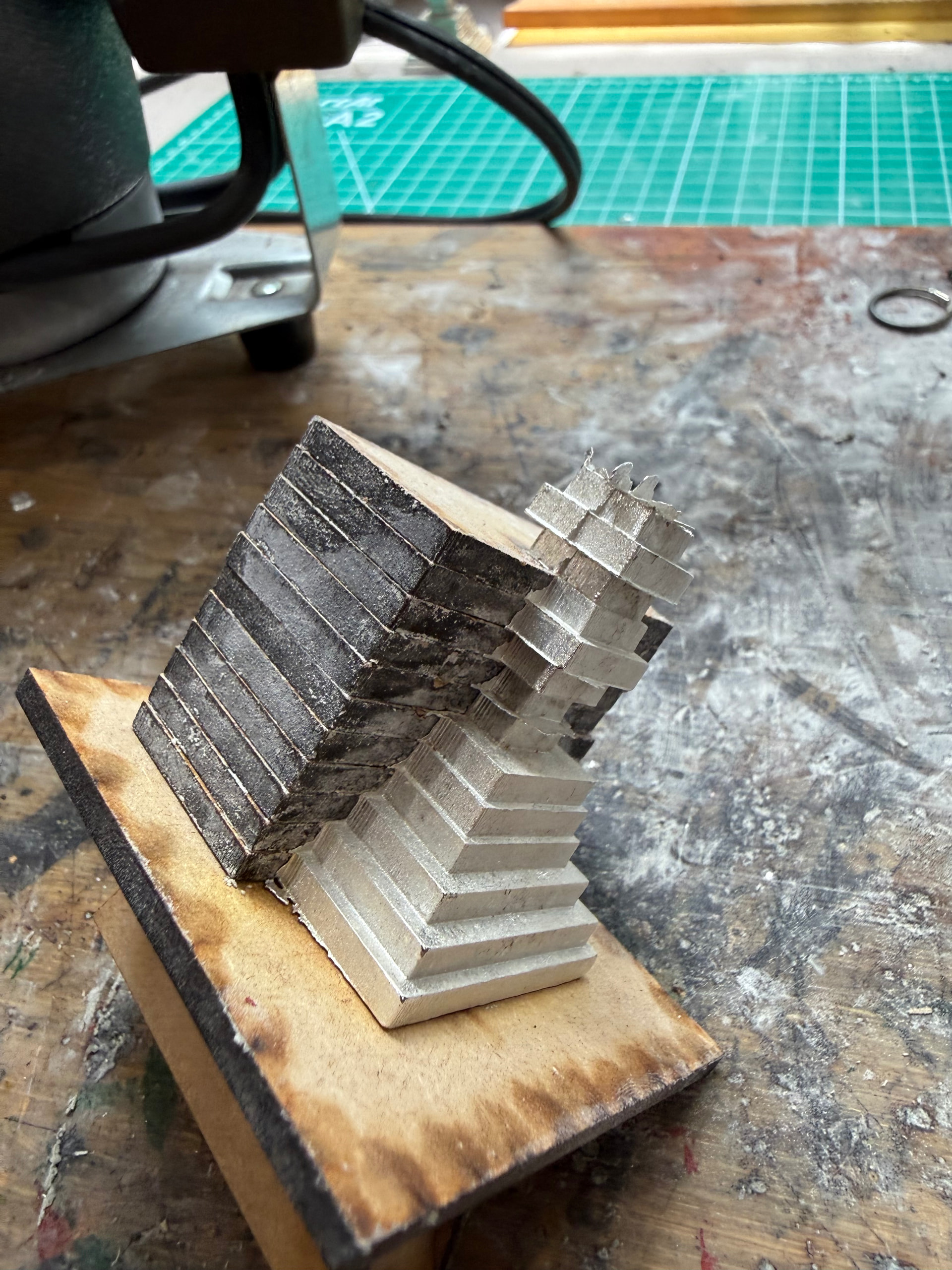

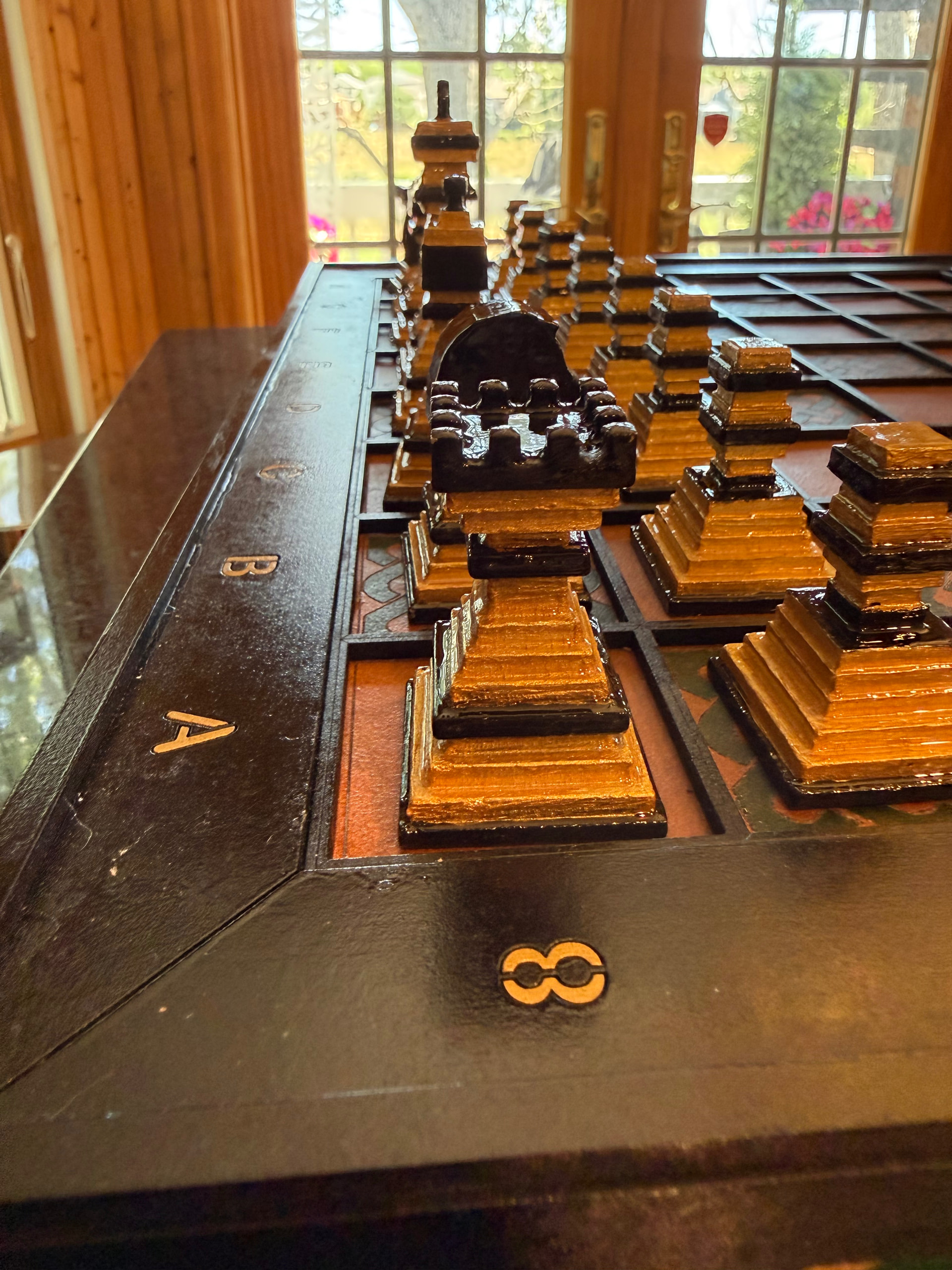

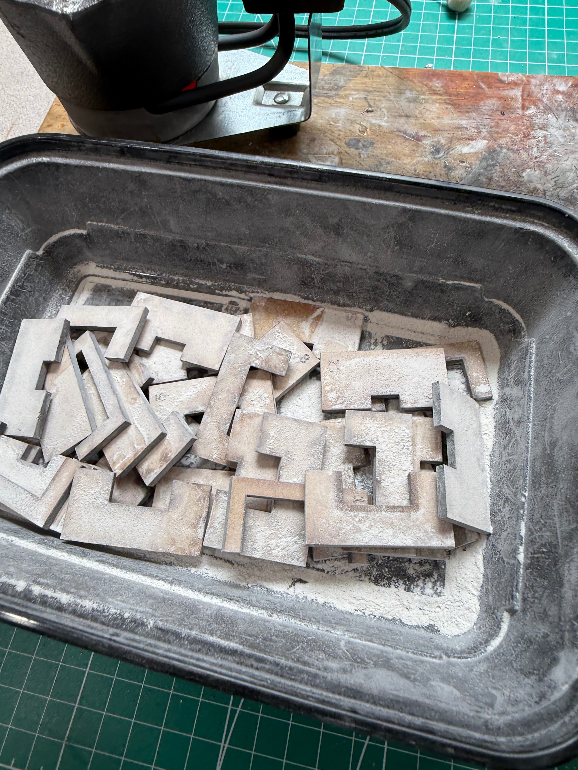

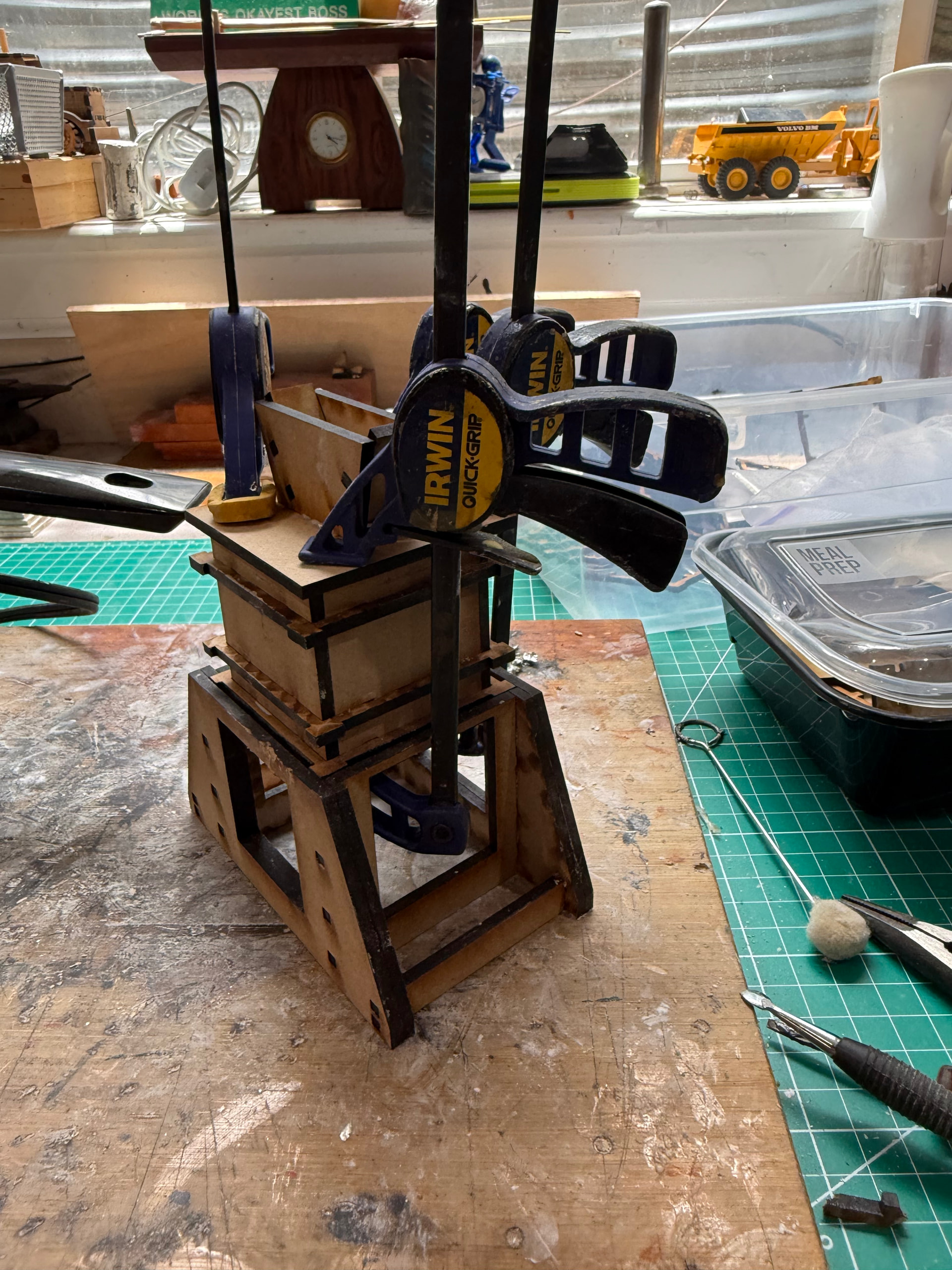

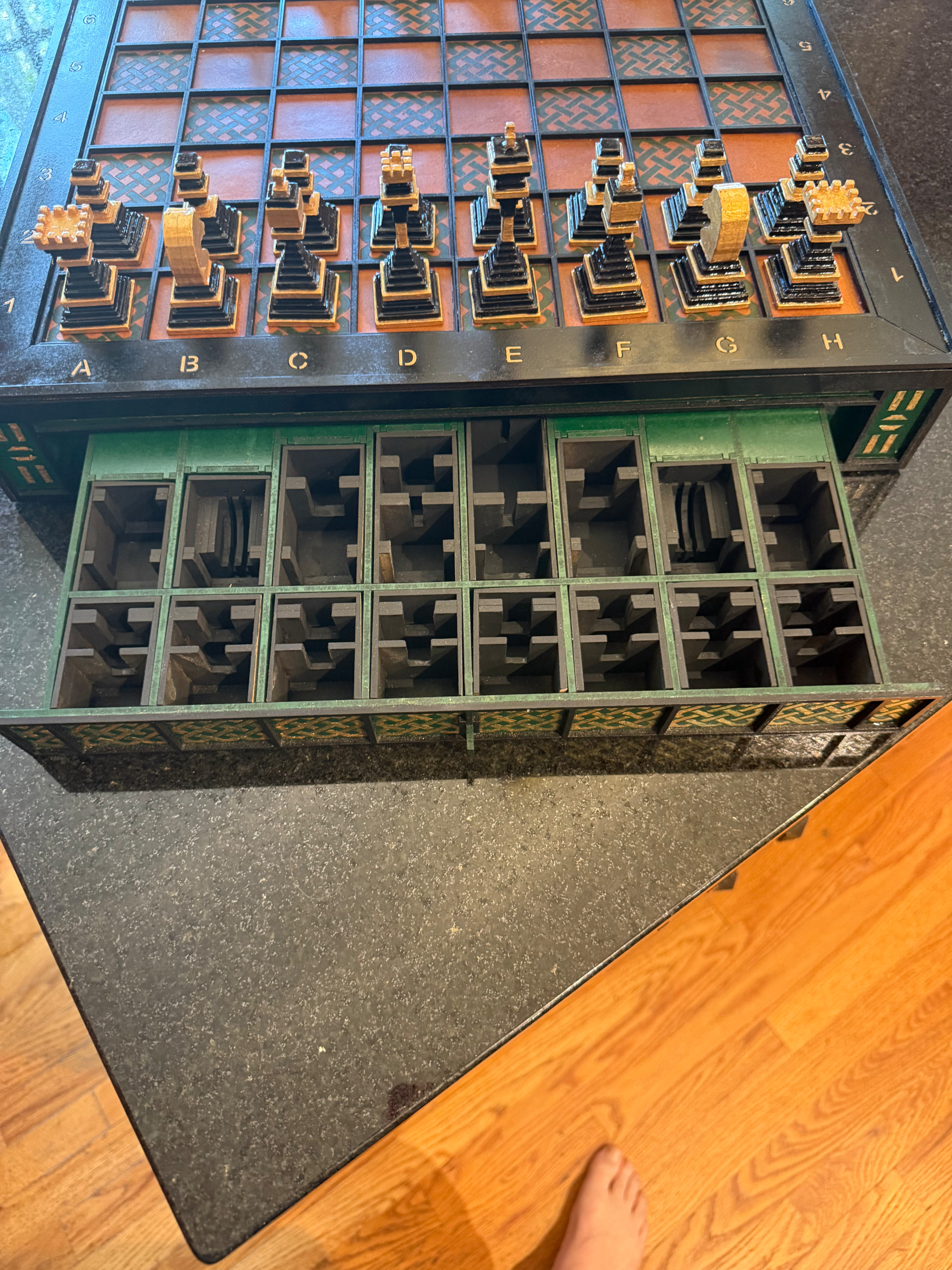

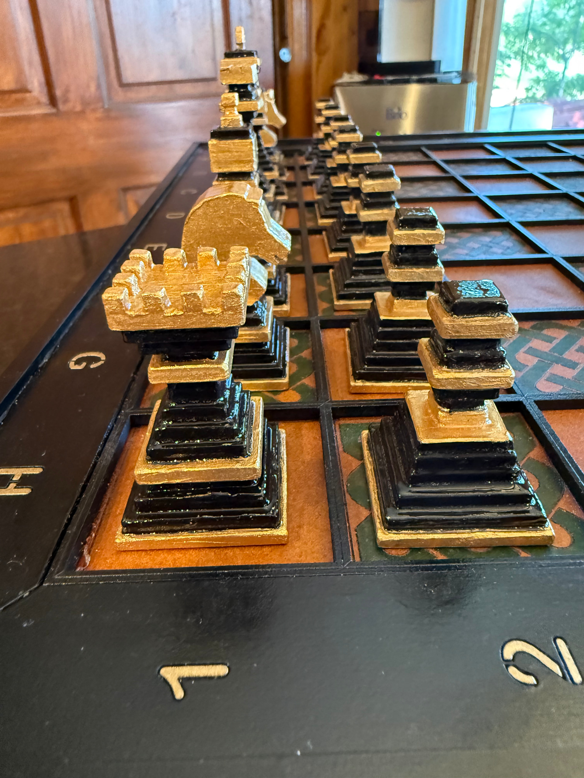

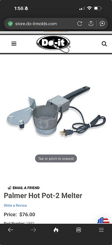

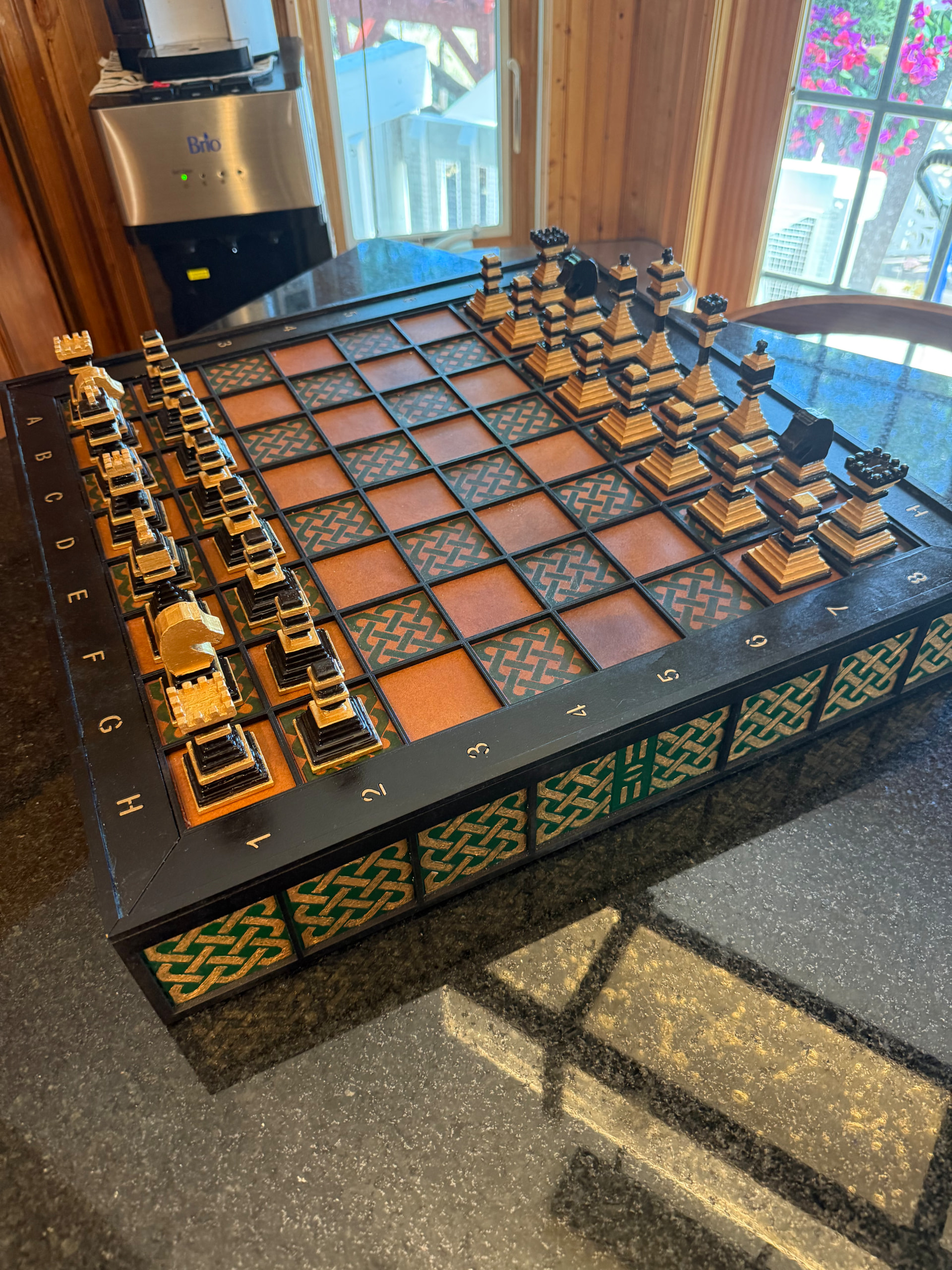

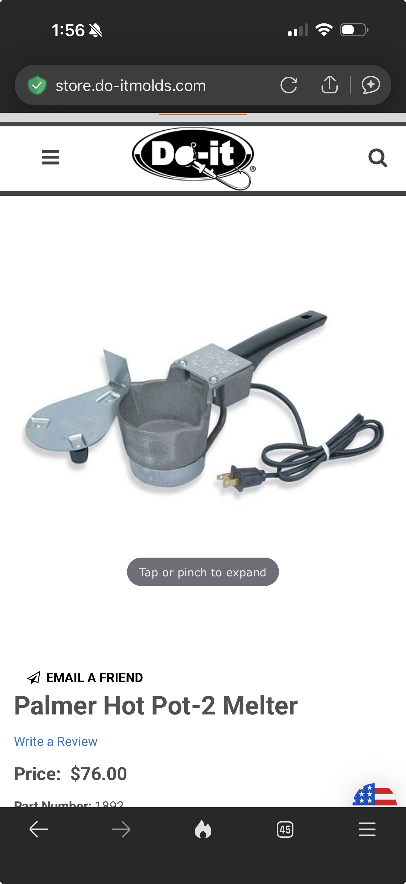

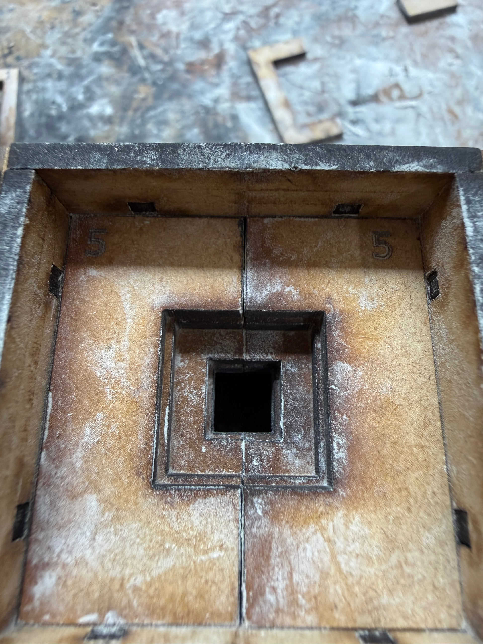

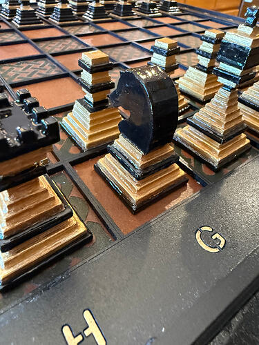

Decided to see if I could pour molten pewter into a Draftboard mold cut on my Glowforge pro and it worked! Next step was to pour chess pieces and build a chess board with storage drawers for the pieces. Board measures 19”x19”x3” and has enlayed numbers and letters all cut on the glowforge. The board top is leather cut and scored on the glowforge. The board and pieces were all hand painted and clear coated. The 32 pieces weigh a total of 8.28 lbs with the heavest piece weighing 5.3oz. The board weighs 14.2 lbs. The height of the pieces range from 2” to 3 3/4” tall. I was able to get two to three uses out of each mold and used a small hot pot to melt the pewter that I purchased on etsy. I used baby power to act as a mold release. Project took approx 6 months and was a lot of fun…

Pretty cool. It’s been awhile since I did pewter casting. I used silicone molds with draft board pieces to clamp the two halves of the silicone mold together. Never thought about using the draft board for the actual mold. I think I’d still go with the silicone though as you must have had to make a bunch of molds if you only got a couple/three pieces out of each. I don’t know what RTV silicone costs right now but I expect it would be cheaper than the draft board.
BTW, watch out for Etsy & eBay sellers of pewter ingots. You want to make sure it’s Britannia pewter as other pewter alloys can contain lead.
