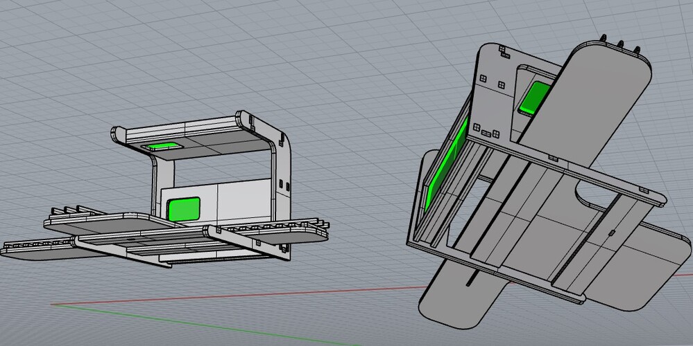

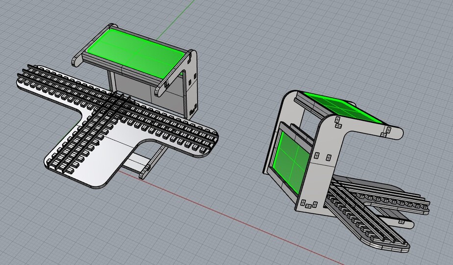

So to make my camera stand I started with Modeling in Rhino 7.
the green is my phone, and as you can see there is a sliding base with train tracks to hold and move the train car to be photo’d.

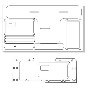

Once the 3D model was complete. I take the parts apart to laser cut. I lift off the 2D surfaces. Rhino is surface modeler. The Rhino surfaces are exported as .dwf files to be imported into Corel Draw.
Corel Draw exports the surfaces into .SVG files.
cam stan cutouts
Now I could take the Rhino objects and convert directly into .svg files, but I find it easier to move and revise 2d objects in Corel Draw.

Why the third rail? Is that for other scales?
