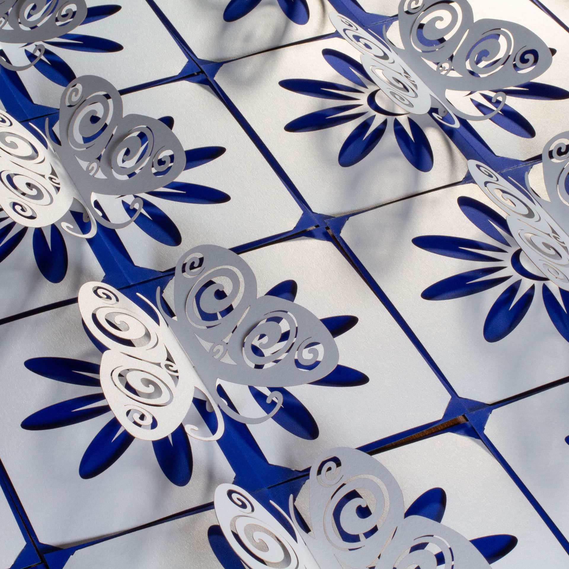

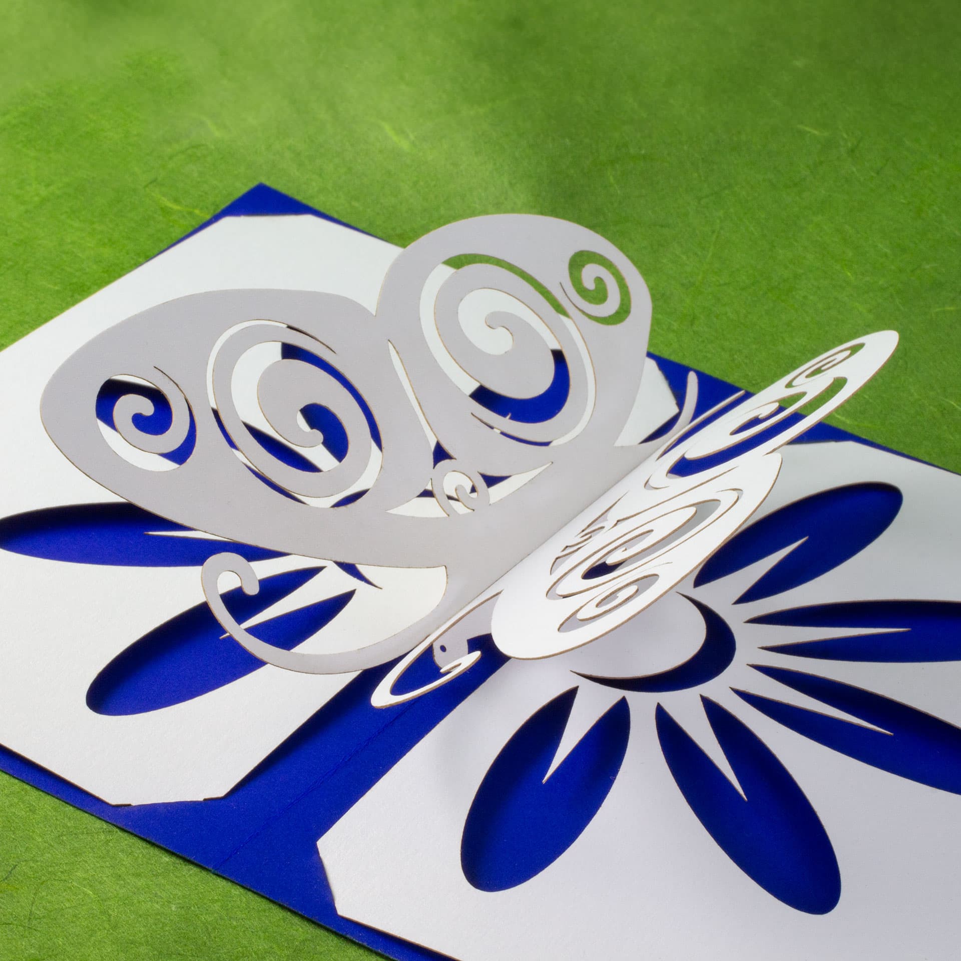

Pop Up Butterfly Kirigrami / Origamic Architecture Card
Time for the annual pop-up holiday card!
~2 minute assembly video:
More stills on my blog: Butterfly OA/Kirigami Pop Up Card - Evermore Stud.io

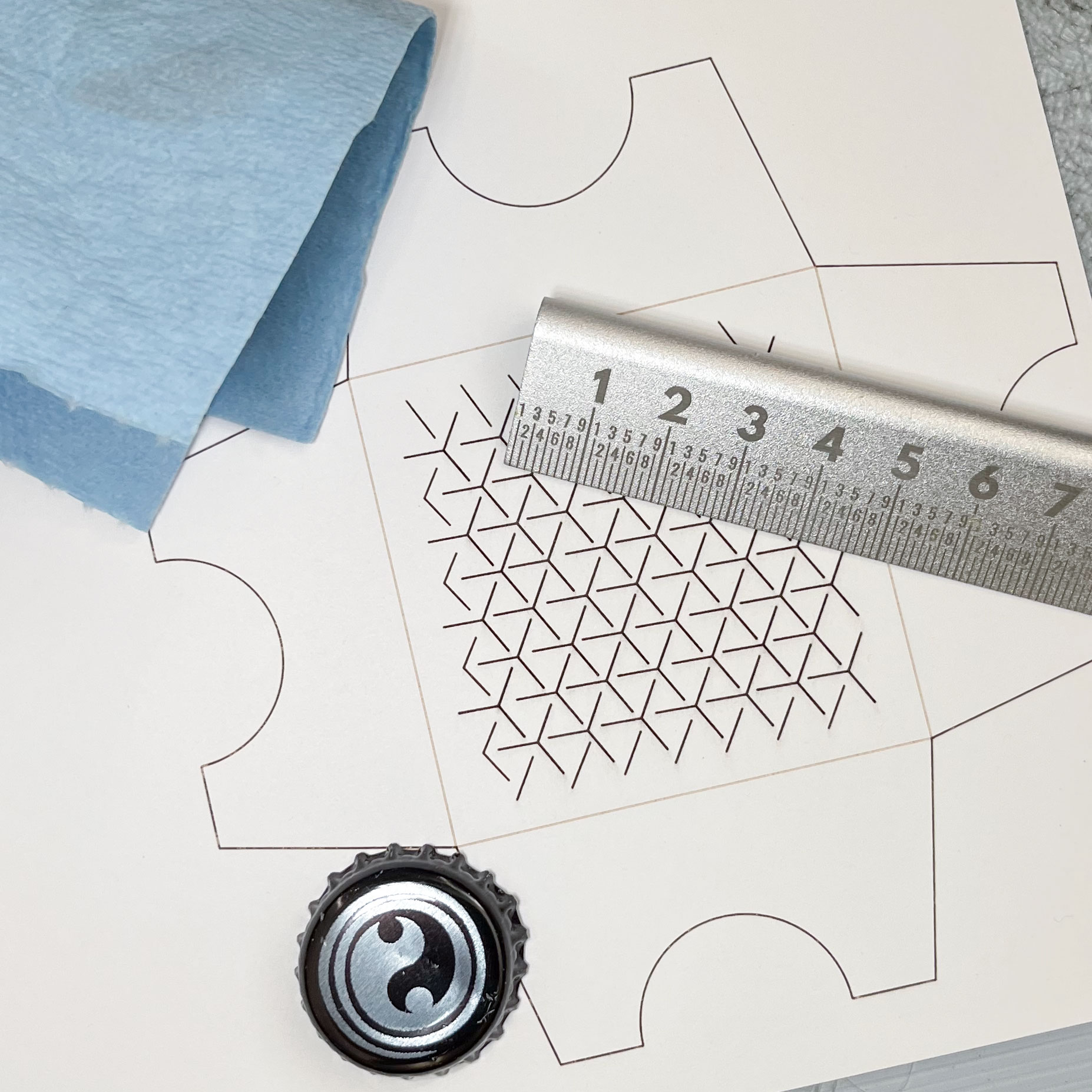

How much is MOAG here? No smoke marks anywhere, if you lasered did you mask?
All of the cutting of the butterfly and the backing card was done on the Glowforge.
I have very dialed-in settings for cutting the card stock [1]. The Seklema mat does a nice job of preventing flashback marking (a shortcoming of the vacuum tray, alas). The clay coat finish on this particular stock is resistant to smoke and ash deposition. I also use Post-It tape to pick up much of the ash from cutting before I peel anything off the Seklema mat (I have shown off that technique somewhere else, will have to look for a link when I have time – basically, you just stick the tape down over the finished cuts, then peel it back up). A fair amount of effort goes into keeping hands, machine, and environment clean when working with white stock.
Edit: The issue I have run into with masking stuff like this is that the only masking material I have found that is not too aggressive (won’t wreck the surface or tear off little bits) is Friskit, which is kind of expensive for making a multiple cards.
[1] There is a painful tradeoff with this kind of thing: lower power will mostly cut through, leaving less scorching, but will leave the cutouts in place so that they have to be removed one by one by poking with a craft knife. It gets tedious when you are making a bunch of cards. A little more power leaves the cutouts (mostly) stuck to the mat.

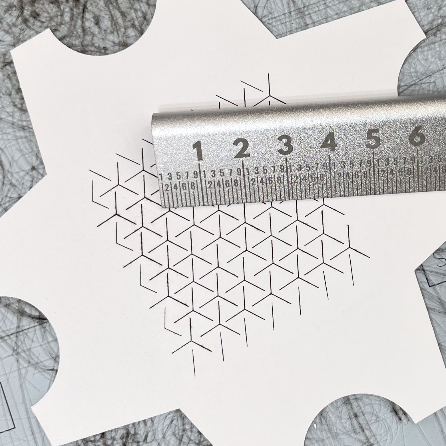

I was cutting some other prototypes, and took a few minutes to dial-in settings for the plain card stock I am using. This is on Neenah Exact Index 110 lb, chosen for weight and brightness/whiteness. I used 500/50 here. This is just wiped off with a bit of blue paper shop towel after cutting. Most of the grunge on the back side (anything not touching the cut lines) was picked up from the mat because I didn’t clean the mat before cutting (having done several dozen cuts on it since the last cleaning).
