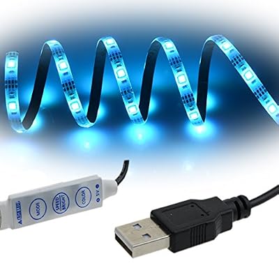

I just saw these and thought it might be an easy, no solder, fast option for edge lighting or other lighting needs in laser projects. Cut to length, powered by USB or USB wall adapter and various color/diming/flashing options.

The waterproof LED strips are a lot less effective at edge lighting than the non waterproof strips. They have a thick rounded piece of plastic that covers the LEDs and doesn’t allow for good straight contact.
Go for the non covered ones. They’re in the same price range, a little harder to find, but so much better.

This is cool to find USB powered. The 30 LEDs in 39.4" (1 meter) is just 1 LED in 3.94 inches (10 centimeters). Not very well lit acrylic unless you loop them up, but the price is right! :slight_smile: - Rich
Very true! I was just doing some experiments yesterday and was amazed at the difference of having just a couple mm space made vs direct contact. Made me want to try and use a clear adhesive and glue them on direct, I suspect this will increase the light transmission even more! (but impossible to replace)
Wouldn’t the math be 1 meter = 100 cm. 100cm / 30 LEDs. 3.333cm between LED or about 1.31in?

Yeah it would be. I had another argument going on email at work…but still kinda weak lighting. - Rich
