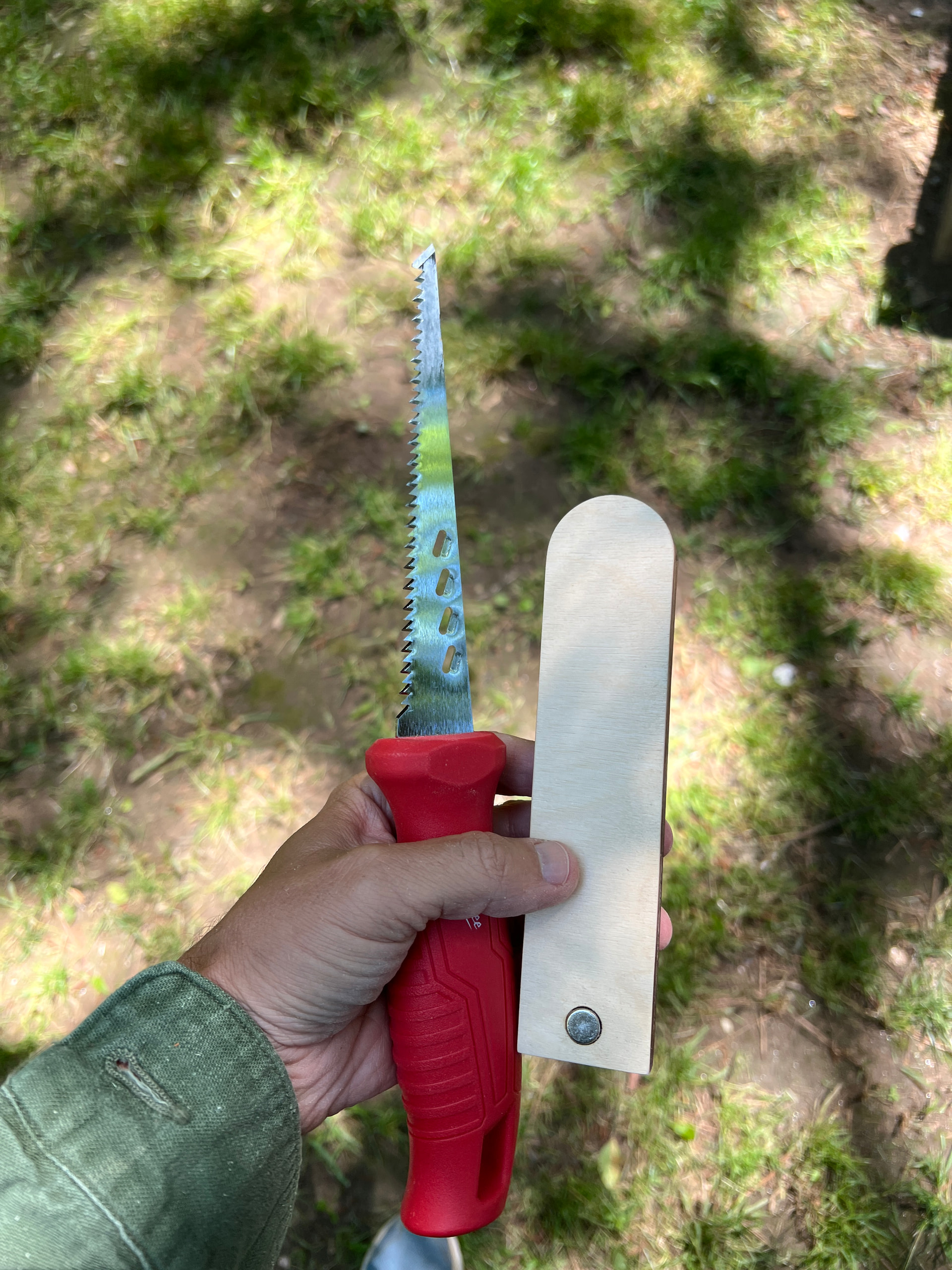

Practical cut: saw sheath

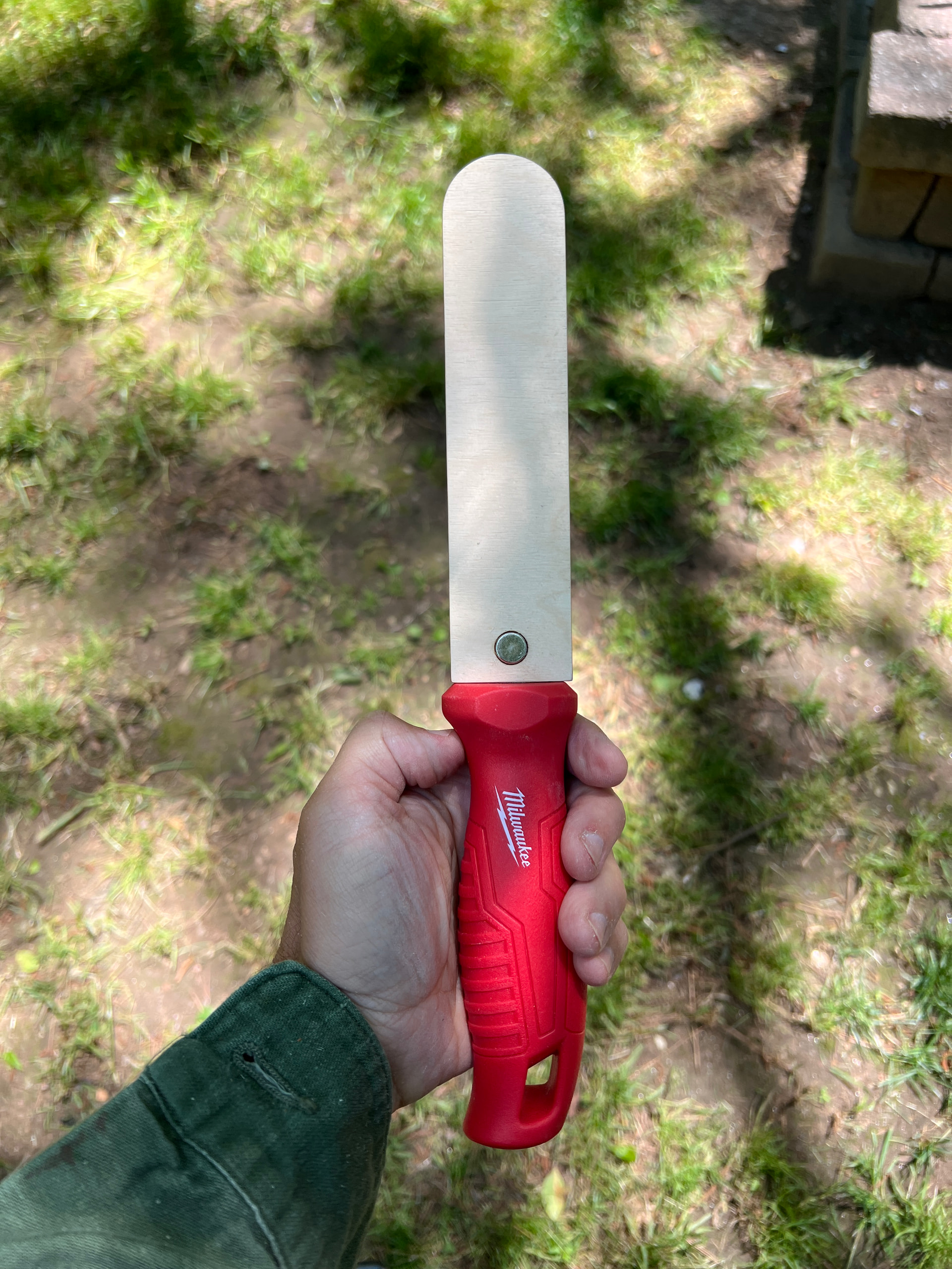

Simple, effective. Practical cut.
Three layers of Baltic birch plywood glued up, the top layer has a circle engraved into it to accept a magnet that’s glued into place.
That saw is nothing but sharp edges so leaving it loosen the drawer seems like a terrible idea. The sheath will save me future bandaids
