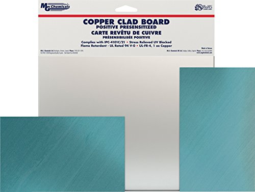

I see a toner transfer paper as a way to get designs onto PCBs. Can you get boards covered in resist already? I’m missing something here.
https://www.digikey.com/product-detail/en/pulsar/50-1101/182-1003-ND/3386
Yes.
Digikey has the presensitized board too, albeit a touch more expensive, I think. But with the laser method you wouldn’t need the photosensitive resist, just a thin clean layer of anything that could act as resist: ink, paint, varnish, whatever…
Right. But the question above was, ‘Can you get boards covered in resist already?’
That helped. “Sensitized” is how it’s listed on Digi-Key. Very hard to figure out there. Thanks!
https://www.digikey.com/products/en?keywords=mg%20chemicals%20603
This dropped in price overnight by a couple bucks and I’m thinking of buying it to try it out, though I’m unsure of the last half of the process…removing the copper.
