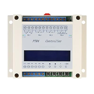

Here is a more capable unit that will countdown up to 9999 minutes:
It will also let you trigger some action. It has four timers, and one can trigger the next, so you could have four distinct phases during the 30 min or 60 min booth time.
Keep in mind that the second device shows the countdown on an LCD screen, which may not even be lit. If you want the booth occupant to see the countdown, it may not be suitable.
If you want large lit numbers visible in the booth, then the Arduino approach might prove to be the best bet.
