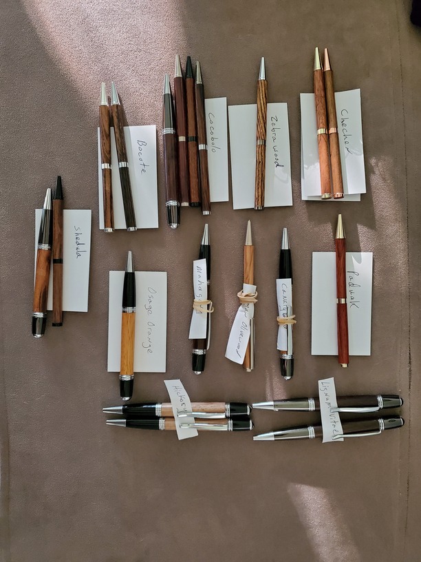

My brother doesn’t always think in advance but tries to help me out by bringing “business” my way. Well his latest “hey I bought this/these for you to engrave” are these lovely hand turned pens. The problem is before asking me what woods to get and not to get he just bought an assortment (and two different sizes :smirk:). I’m not hung up on the alignment or jig issue, but more so the fact that I have an assortment of wood selection and each will be different.
The question at hand is for turners, are you testing woods before to get your approximate ideal settings or are you going with your final product and making another pass if needed?
The only thing is these aren’t “well if you mess up no big deal” pens, they are purchased product for distribution. So I don’t want to necessarily engrave then engrave again and have it go too deep. I also don’t have some of these wood scraps like Osage Orange to just try settings on like I would with walnut or hickory etc. Some of the thinner pens also have thin shanks so I know if I run multiple passes my risk of burn through is much higher.

I was fortunate that the guy who gave me the pen blanks also included spares to test on. In the end, I was able to use all the barrels and not screw up on any of them.
I tested on some hickory and oak dowels to get a sense of burn. Part of it is that depending on your font and design, it does require different settings to not overburn, but still make it visible.
Sneaking up on it with a light pass to start with does work ok though, but I would only try that after testing it out on something approximate.
If I had to do it on finished pens, I would try to source some blanks of the material, that is the only way I would eliminate some surprises.
The finish could cause a discrepancy in engrave depth.

I think I’d just make a solid jig, and “sneak up” on the final engrave, inspecting carefully after each attempt.
I usually do mine pre finish. I use a jig to hold in place and place the text. I will do a light pass, not move the pen and do another pass if needed. Better to error light than burn down to the core. I prefer the lighter flowing text.
I appreciate all the input so far. As I planned already, I definitely will be making a jig and sticking with single lined fonts with semi thick tails if a serif. Glad to see the general consensus for wood is low power, but should I go low and slow or low and fast ie 800?
