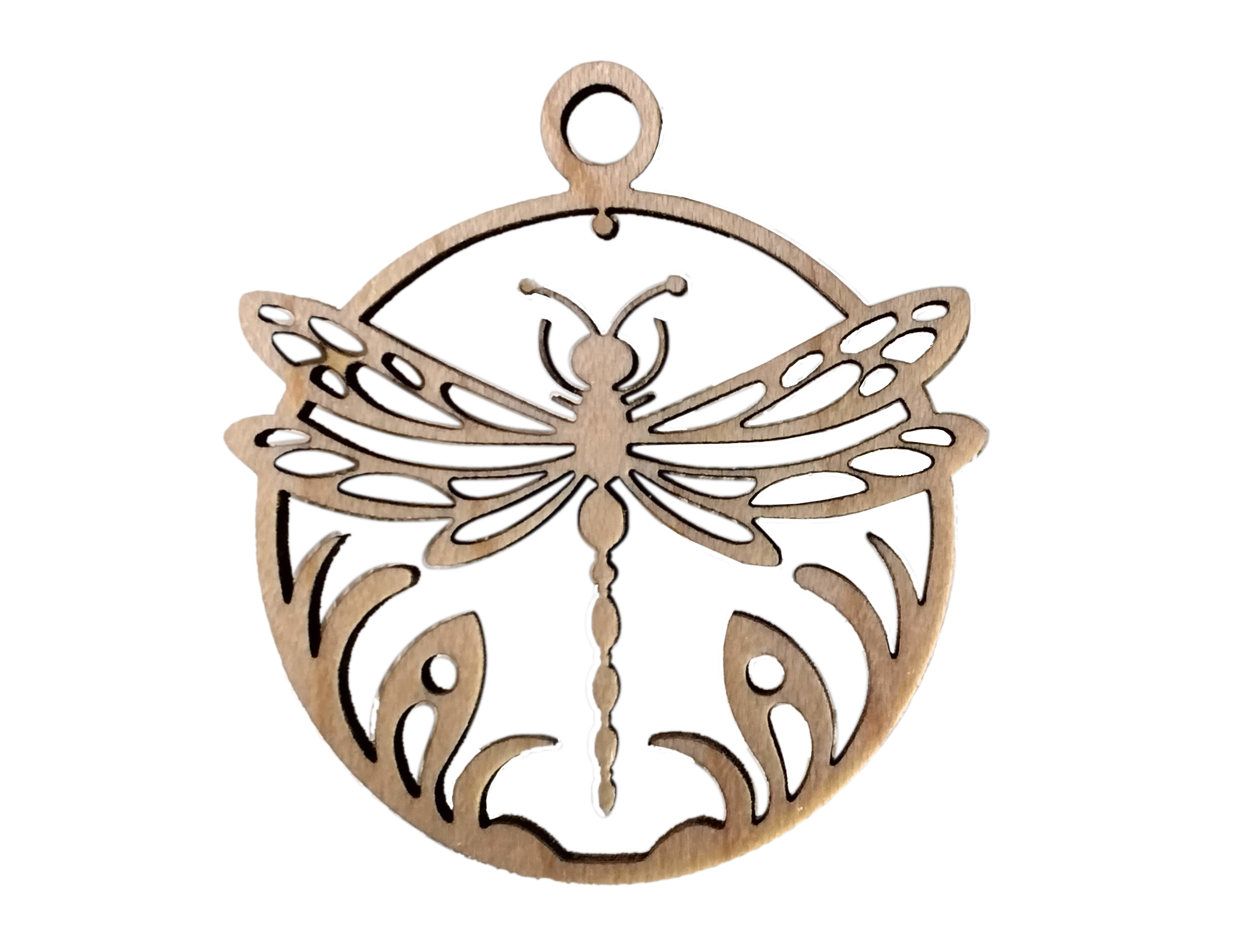

For a while now I have been using Gimp masks to create vectors, but just today I had a photo of a finished piece that would need a lot of work to create a mask. So I thought about how I created the masks to make vectors and thought “Hey! we could import the vectors to make the masks”. As the vectors made the piece in the first place it was merely a matter of scale and slight rotation and I had a pretty good mask!

This is the starting Image:

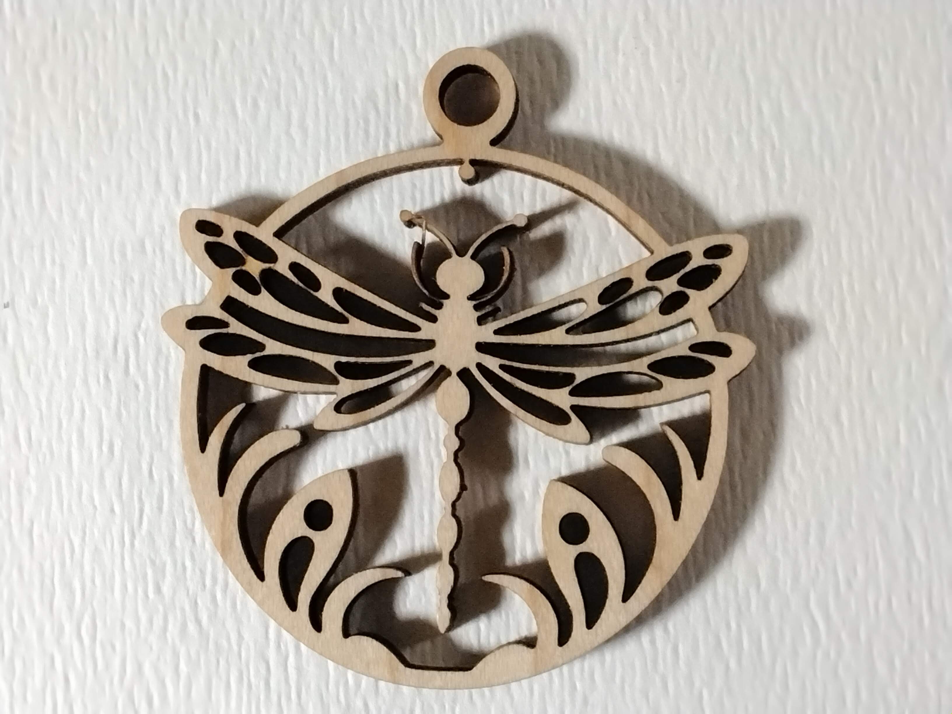

And this the result:
Now I understand what you were saying!
