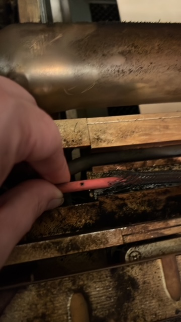

We have one of the new machines with the red wire covering… guess what? It doesn’t work! Red wire still has a hole! And of course, GF wants to charge for a refurbished model even though this is a factory defect they are WELL aware of!
Reach out to Jonathan Gleich on Facebook. He fixes a lot of these.
I did and it’s back up and running but it’s kind of ridiculous that Glowforge knows about this issue and even their “fix” didn’t work and their only solution is to have someone shell out 1600$ for a refurbished one.
Glowforge does not offer a fix for this problem. They would never suggest that a user open the machine and work on the HV cable.
No they would not, they would prefer to keep this known defect in their machines and charge people to get refurbished ones. Then fix the simple $20 wire and resell the machine for $1500 as refurbished.
And the fix I was talking about in the original post was the glowforge fix of covering the red wire with a black sheath. The newer machines have the red wire covered as the factory “fix” but it does not work.

Thanks for taking the time to contribute, it does help everyone to know about the arcing issue.

You say the red wire has a hole, did it arrive from Glowforge that way, or did it happen after some time as you used it?
Do you have any photos of the defect? Was there any sign of wear or damage to the wires otherwise? Can you show the area where you think the wire may have been touching the Glowforge? I wonder if it was a rough or sharp area that wore through or if the insulation simply wasn’t enough for the voltage?

no worries. The machine is about a year and half old. Came from the factory with the upgraded red wire covering. You can see in the pic my husband actually had to cut away the black covering to find the hole.
