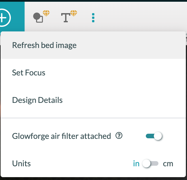

it is at least double the noise of the first unit.
it is not cutting gf proof grade materials all the way through.
the camera is not reliably reading the QR codes.
on 1/8" baltic birch ply it is making only about 70% cut all the way through but is burning the back side of the material , two things that worked ok on my original unit .

Hello, I am mystified how the cut could possibly go only 70% through but burn the back. Non proofgrade I am assuming?
Edit: Oh, do you mean that only 70% of your cut line is cutting through? That would point to material inconsistency. Noise - are you using an external filter with the internal fan running?
Do you have the fan switch in the interface in the correct position (since it sounds like you have an air filter attached)?
The only way it can burn the back is if the laser is going all the way through and the heat is reflecting back onto the rear of the material, so (like @gewubs said) I’m not sure how it can be burning the back but not cutting through. Maybe some photos would help?

As one increasingly disabled from birth I am very happy with my Pro and glad I bought it instead of the Basic. I also had my first machine die but now understand that it was mostly my own ignorance that killed it. The internal exhaust is very loud but should not be run with the filter. If you can exhaust out a window you will have an easier time of it, and with a 200+ CFM inline fan you will not know the Glowforge is even running.

yes 70% of the cut line is not cutting through. Regardless of material, proof grade from GF and also other materials that cut ok on the first machine. Having measured with micrometer and a straight edge there is next to no warping/cupping etc and it happens on every print. Glowforge say it’s another faulty machine…
Glowforge say the machine that was sent to replace my faulty pro is also faulty.
