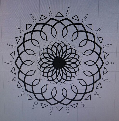

Finally got to the office to play.
I used the transformation tool in Corel that lets you make copies to paste around a rotation point.
Started with a simple line, mirrored it then applied a brush stroke to beef it up
Then with Transformations I made 17 copies to rotate 20° around. 360 divided by 20° is 18…that’s how you get 17 +1(original)
Click apply and got this…
The shapes were too close together so I moved the rotation point to the bottom of the shape and got this.
Then added a few more shapes, moved the rotation point to the middle of the design and applied transformation.
In order to get the extra shapes to line up, I had to fiddle with placement.
Next I made a larger more complex starting shape. (sort of ugly…lol)
First time I did the 20° with 17 copies but its pretty dense.
So moved it to 40°.
