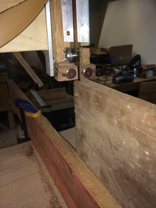

KSet up the bandsaw to try and resaw some walnut. It worked but just barely. The 1/2 horse 1725 rpm just doesn’t have the power. It was slow and kept catching. I did manage to make some 1/4 stock and thinner using hand planes and a belt sander to finish. The wildest thing was that after church today, a parishioner stopped me. He used to run a lumber company and has seen the bandsaw. He told me it was underpowered for any hard and wider pieces. Well, today he dropped off a refurbished 2 horse 3450 rpm motor single phase wired at 110 for now. Tomorrow I’ll install and and see what I can do.

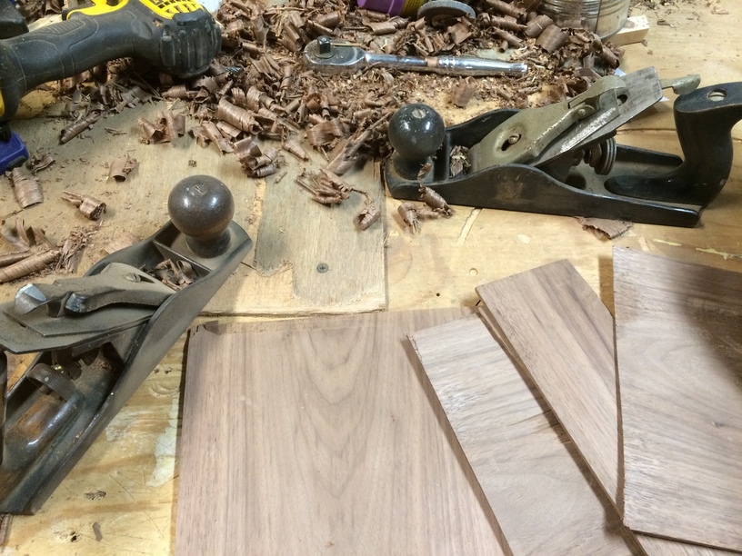

whoops need to get into the habit of putting my planes down on their side.

Since your bench is wood, setting them on the blades isn’t so much an issue. I usually keep a piece of scrap on the bench to prop them up. Setting them on their sides can be problematic for your finger tips! :laughing:

In addition to the larger motor make sure your blade is wide enough. 1/2" minimum - 3/4" preferred.

I have a 3/4 and a 1/2 in. This is the first time I loaded the 3/4 and that is what made me understand I needed a bigger motor. The 3/16 blade does well for smaller cuts but for resawing I understand the width makes a difference. Thanks. It’s a lays amazing when mutual interests combine. This forum has been so helpful to prod me on to finish.

The wider the blade the more important it is that your guides be accurately set and smooth running.
Getting enough tension on a wide blade like that is also critical to keep the blade from flexing and wandering around. A 3HP motor is massive for a saw that size! Be careful…

Main things I would worry about would be actual speed of belt. Most band saws have a smaller pulley on the motor shaft that turns a large larger one which the blade rides on. The real problem that may come is the belt slipping due to speed vs torque required to turn the large pulley. My suggestion right off would be to up the pulley size on the shaft to lower the torque curve on turning the larger pulley. Remember it will drastically effect speed when you upsize the motor pulley. But this will not necessarily negatively effect cutting of the wood, most saw blades cut better and last longer at a slower speed. Plus when you load up the saw by cutting wood you will have less belt slipping.
