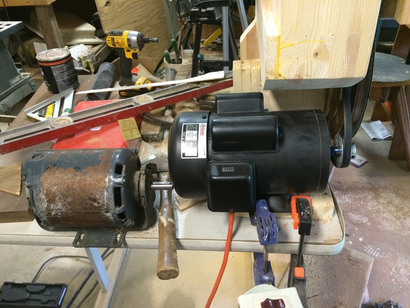

Ok. I looked more carefully. It is 2 horse refurbished. But it still rocks. The pulley ratio makes it 2100 fpm so that is a pretty good speed. I adjusted the blade guides very carefully for the 10" in boards.

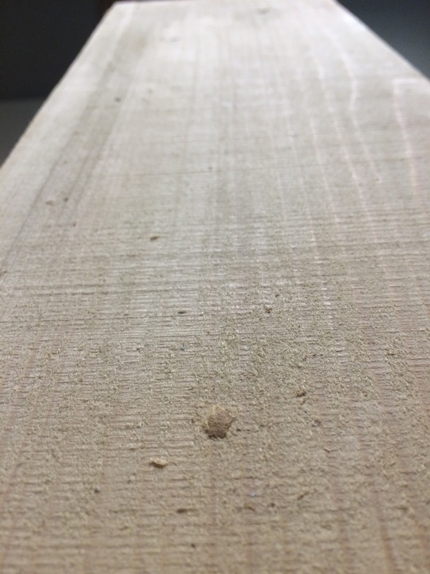

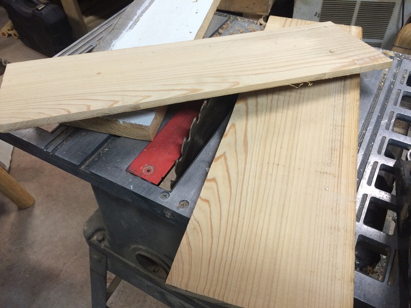

I also scored some 5/4 cedar 12" wide by five feet from a remodel. I have 20 boards in great shape. They were exterior siding of a house that got closed in to a breezeway and screened in porch. I ripped them in half because they were cupped a bit and then resawed a 2 foot section into two boards. The walnut actually cut faster. The cedar really has lots of friction. Planing them up to 1/2 inch if possible. I don’t have a powered planer and it’s pretty challenging to hand plane this much. I have enough material for a couple nice cigar boxes. Cedar inside and walnut veneer outside.
Here is the surface after sawing.

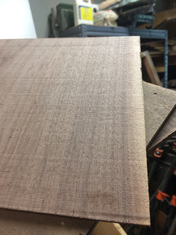

And here is another piece of walnut. I hand planed it and it turned out ok. Need some winding sticks now.

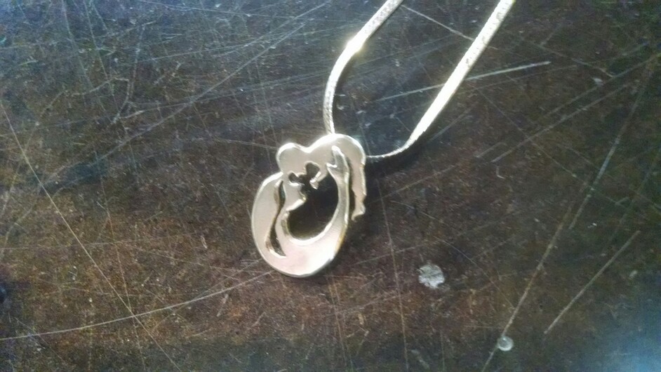

A Mother’s Day gift, not my design. My Wife saw this on a co-worker and took a pic to show me. Fashion jewelry in cheap metal.
I reproduced it as closely as I could to honor the great design. No idea who to credit, but they nailed it. Salute to the original artist!
I embellished the finish by blasting with flint shot (glass bead) that leaves a smooth matte finish, and beveled the edges and burnished them. Done in 14k, (bad picture, looks silver) precious metal befits the wonderful design.
One of her favorites.

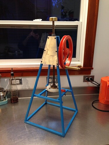

This is a shave ice machine I made my wife as an anniversary present (she really likes shave ice).

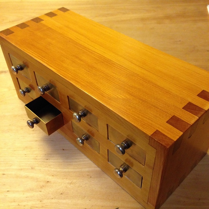

and a little set of drawers made out of recycled fir from our house and fabricated brass drawers (about 12" x 5" x 5")

I like the brass drawers, well done.
Is that cast or pierced out?
Very pretty either way!
Awesome little drawers! :relaxed:
That box is gorgeous!
Great example of cabinet grade woodwork. The combination of metal and wood - especially the colors work so well!
Nothing like shaved ice on a hot day. Had it first in Hawaii, might have to snag that design from you!

Thank you, I cast that.
Speaking to one who can appreciate the perspective, although most are simple, the part I enjoyed most in the process was designing the spruce/gate/vent and feeder system for complicated pieces. Envisioning how metal would enter and distribute In the mold.
Great anticipation right up to the reward of the finished casting!

Nice box joints! I would like to make a box joint jig, but I can’t decide whether I should do Matthias Wandel’s, John Heisz’s or Stumpy Nubbs’. Will just have to wait till I get the Glowforge.
Ha, it is NOT cabinet grade woodwork, it is just a very carefully composed picture to hide all the tearouts in the box joints. Bone dry 100 year old douglas fir was not a good wood for this application, especially given my limited skill at woodworking.
The shave ice machine is loosely based upon one we saw in Hawaii. I bought cheap bevel gears intended for use in an angle grinder and literally built the machine around them. I would be happy ot send you some close up shots if you want them.
@numosbk @Jules I will accept any compliments on the drawers as well deserved though, making eight of them identical was a test that I actually passed. :slight_smile:
@marmak3261 thanks, I hacked something quick and dirty together in mdf in a few minutes, and it worked just fine (as far as the jig was concerned anyway). It has no flexibility though so it was a once and done kind of thing.
A square drive for the shaft slip through the gear?
It is a round shaft with a keyway cut in it.
I had to use as many machine tools as possible.
Do you have to freeze your own blocks for it?
Yes but that is not a big deal, it is designed around quart sized yogurt containers.

Josh that is so cool!'
Hey, that’s why we have machine tools! Besides, they’re just sitting there…
My guess is you lathed the knob and the crank handle, (looks space-age on that sheave) maybe the bushings too.
Drill press, mill maybe and some cutting tool with muscle to form the aluminum gear boss.
Welder …
Fun project, with many brownie points as a bonus!
