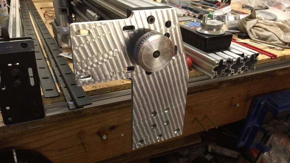

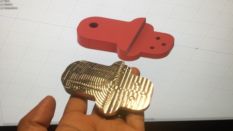

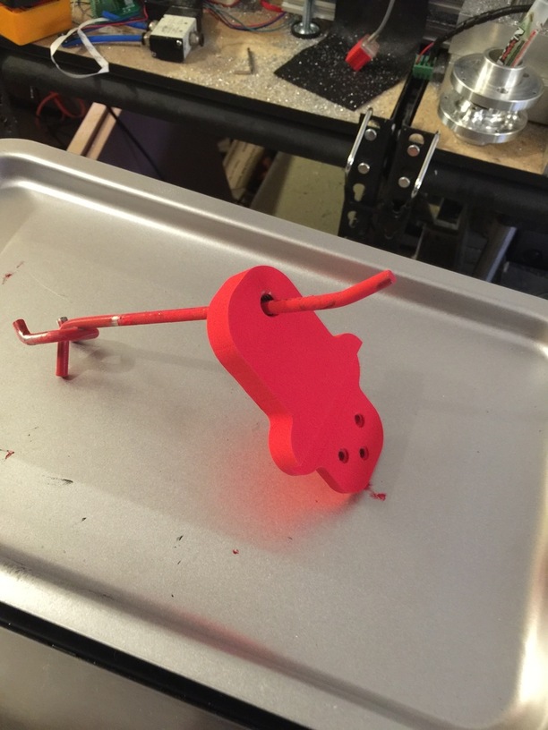

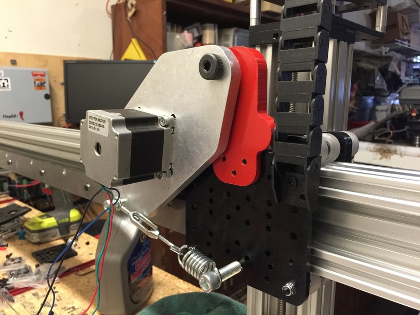

This is what I’ve been working on in the last 2 months.
Basically I got rid of the GT2 belts. Switched to R&P on the X axis. Then lead screws Y. Raised the Z Axis. More powerful NEMA 23s all the way around. Power coated the new plates.
Impressive capability. In house end to end fabrication, sweet!
Very nice work, I know you will have fun with that. Thanks for sharing!
Very cool. Would love to have access to equipment like that.
Looks like the red brackets were powder coated. What did you use for an oven?
I would love to build that iPad stand for myself , able to share plans?
Thanks!
Unfortunately, I don’t have plans for it. They were made manually, using a bunch of custom router jigs that we made to cut all the parts out in multiple operations.
