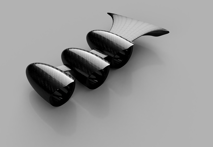

That’s really nice work! The carbon fiber looks gorgeous. But those styrofoam skills…
I’d be very interested in how you modeled this if you are inclined to share.
Once you have a fundamental grasp of the software, amazing how differently you see things. You want to model them for fun.
I hope this makes sense with the screenshot. I used the Loft command for the main shape of the housing. This entails setting up multiple sketches in a “layered” fashion, the items labeled Profile 1, Profile 2, Profile 3, Profile 4. You’ll also note each sketch is on its own plane, and those have to be created before you can make the sketches. The sketches need to be closed shapes.
You’ll also see the items labeled "Rail."These are Guide Rails. They help to quickly refine the shape of the loft. You dont absolutely need them, however relying solely on the sketches to determine the shape will give some odd results (wavy, uncontrollable surfaces). You can spend hours tweaking the sketches and plane locations trying to smooth out the model, but put Guide Rails in there and suddenly the beast is tamed. Two tricky aspects to guide curves though is they absolutely must intersect the sketches, and they must be continuous curves, no sharp corners. Guide rails can, however, be open shapes.
Something else to note on this particular model in the screenshot is this is only half of it. Sometimes some of the parametric model computations get tricky and it can slow things down, particularly when you go make edits further up the command timeline, and go to regenerate the full model. It has to think and run through all the steps again, and sometimes it bogs down and crashes. So, I will often split the model in half then mirror it, so there is less computing that has to happen.

Thanks! I give the credit to Fusion 360, they’re really stepping up the render engine!

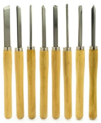

Yep they are, messy but they are fun. Congratulations on the new toy, all the lathe chisels are the expensive parts.
I got this set for my HF lathe, and they seem to be working quite well. Less than $20
