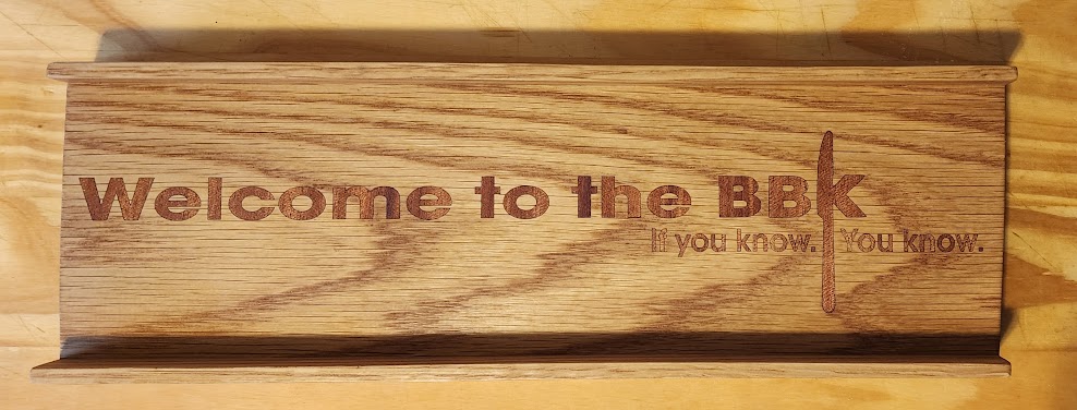

My friend built himself a baking kitchen in his basement out of all clearance/used/gifted things so he calls it his Bargain Basement Kitchen. When folks are coming over he wants them to use the side door of his house - and he wanted a way to indicate that the BBK was open. Et Voila!
I inlayed mahogany veneer into some golden oak and finished it with like 10 layers of tung oil, and then some polyeurathane…it should have no problems at all surviving outdoors!

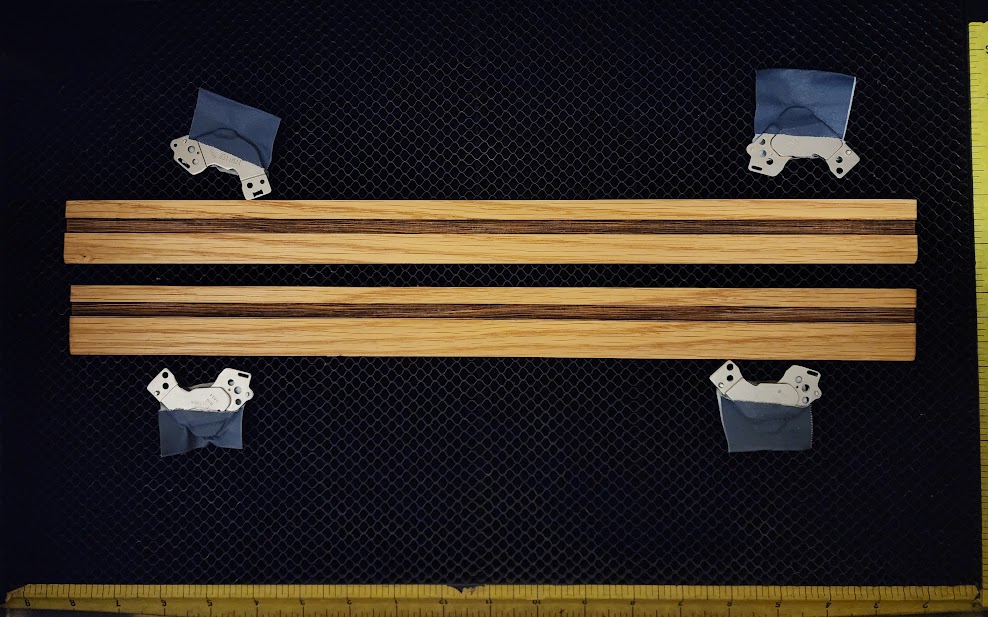

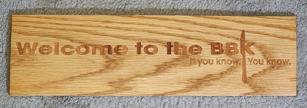

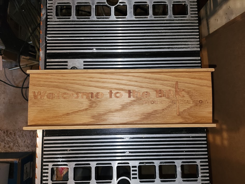

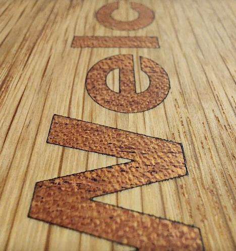

The inlay was done first. Intentionally set at a 90º angle so that no matter how the sun hits it, you can read it - but the colours are similar enough that it’s very subtle from any sort of distance.

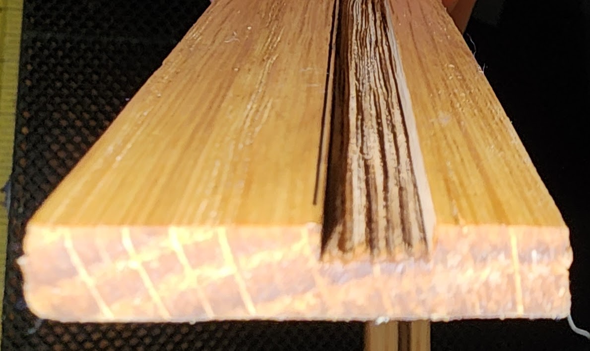

I cut evenly sized pieces from the top and bottom of the oak to give it a frame.

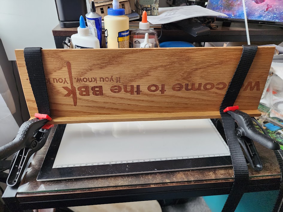

I did a deep engrave to give me a channel the same depth as the sign.

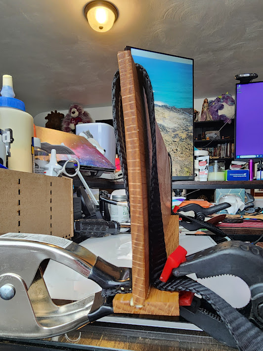

That got sanded out, and then glued to within in inch of its life.
Despite appearances it’s not actually curved
Complete except for the finishing!

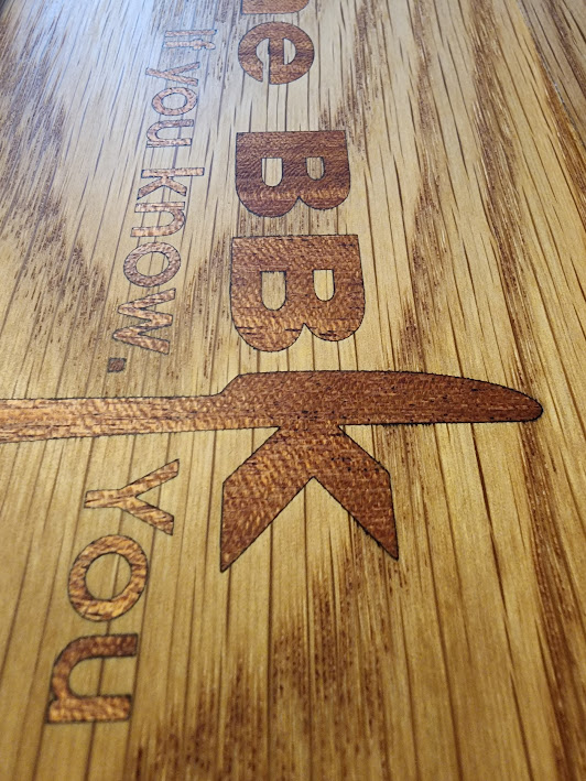

Closeup comparison of before and after tung oil
It’s subtle, but significant :slight_smile:

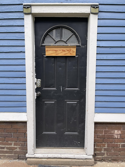

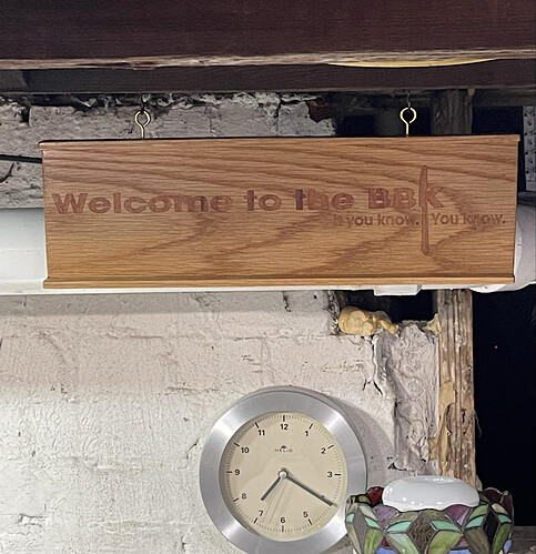

He sent me a picture of it hanging on the door, and its storage spot inside :slight_smile:

It always surprises me just how easy inlay is when you’ve got a machine that can cut things to tolerances of .007"!
This looks amazing!
Oh yes! Compared to the old-school manual method it’s voodoo! Trade the traditional tools for a robot that can graduate cutting by .001!
