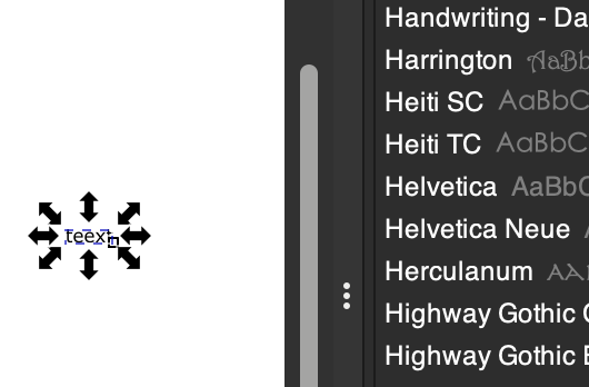

I’ve tried everything. The custom font folder in preferences is correct. I’ve quit and re-started. None of the .svg fonts show up anywhere. And I can’t load them into the OS ‘font book’…

I’ve put all the files in all the places, and Hershey does not show in the app. I’ve even rebooted.
This works for me after editing /Applications/Inkscape/Contentx/Resources/share/inkscape/extensions/hershey.idx. It did not work for me with just typing in the font name.
@eflyguy – your image looks like the regular font list. To use these, you need to type something with the regular text tool (like you already have there), then go to Extensions > Text > Hershey Text … From there, with the text you created selected, you can choose a font and click Apply.

The Hershey text extension in Inkscape works fine, always has. I thought they were describing additional “regular” fonts that can be selected in the text font dialog and then scored. None of the SVGs from the links above allow that.
Right, this is all about adding additional hershey fonts to the extension.
Feel free to come over and slap me over the head!
I thought it was about single-path fonts to the regular text tool. :man_facepalming:
