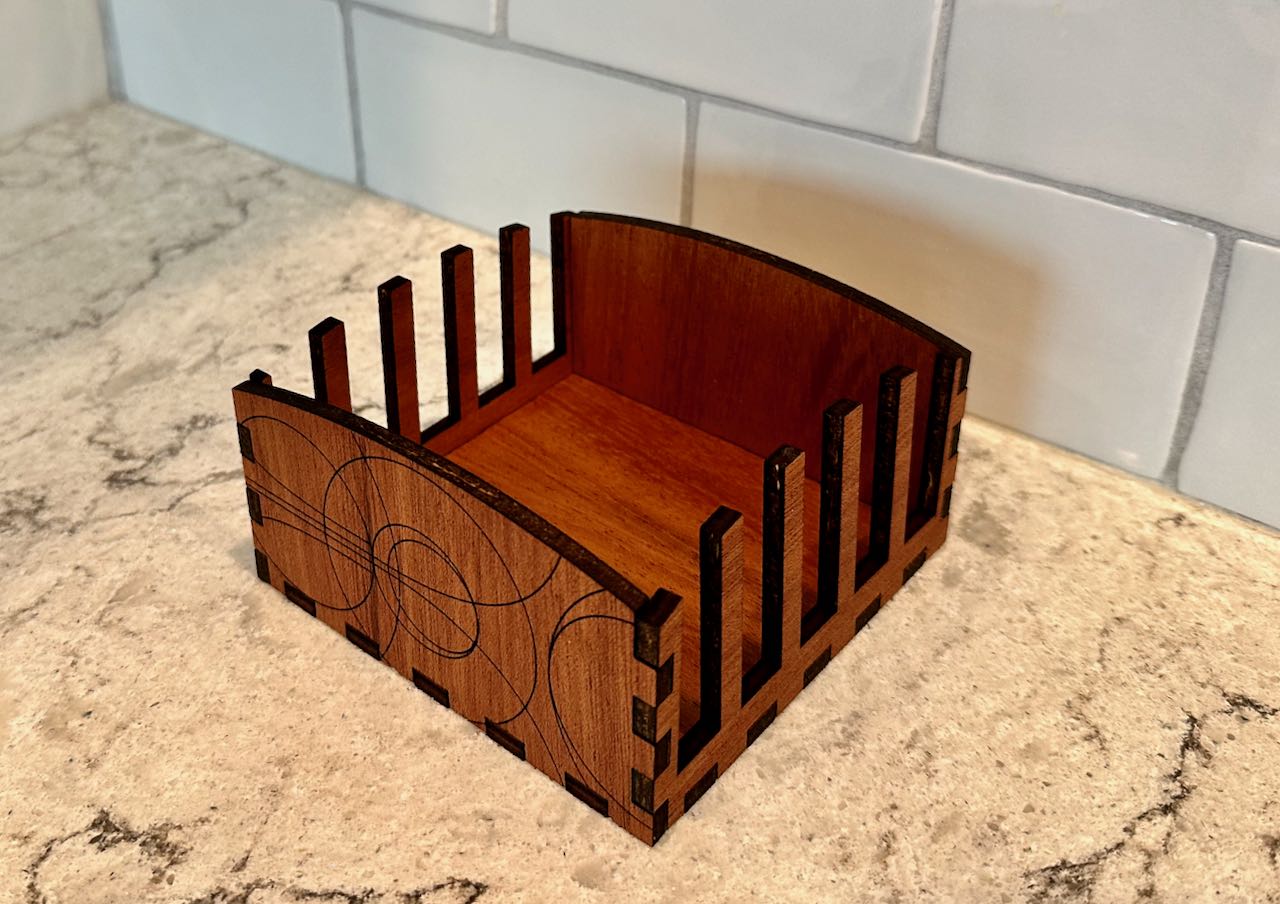

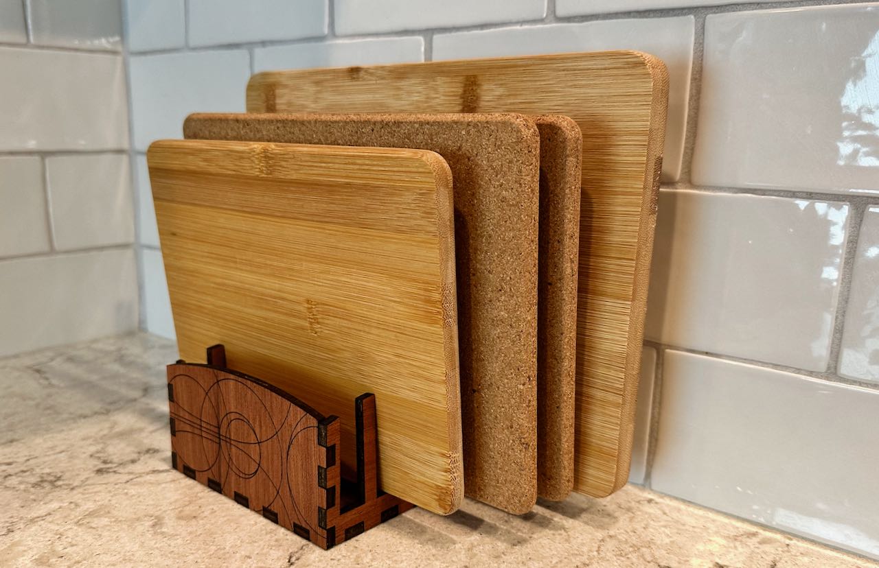

Sharing a little cutting board holder for all those small boards/trivets that you have no place for.
This file has a larger kerf (0.01) b/c I have to run multiple passes on my laser to get it to cut through the material. Material is 0.2" veneer soft core plywood from THD.
Add your own design to the front of the frame to personalize.
Cheers!

I should add that the frame holds boards up to 0.55” thick. The cork trivets in the pix can be found @ Ikea.
