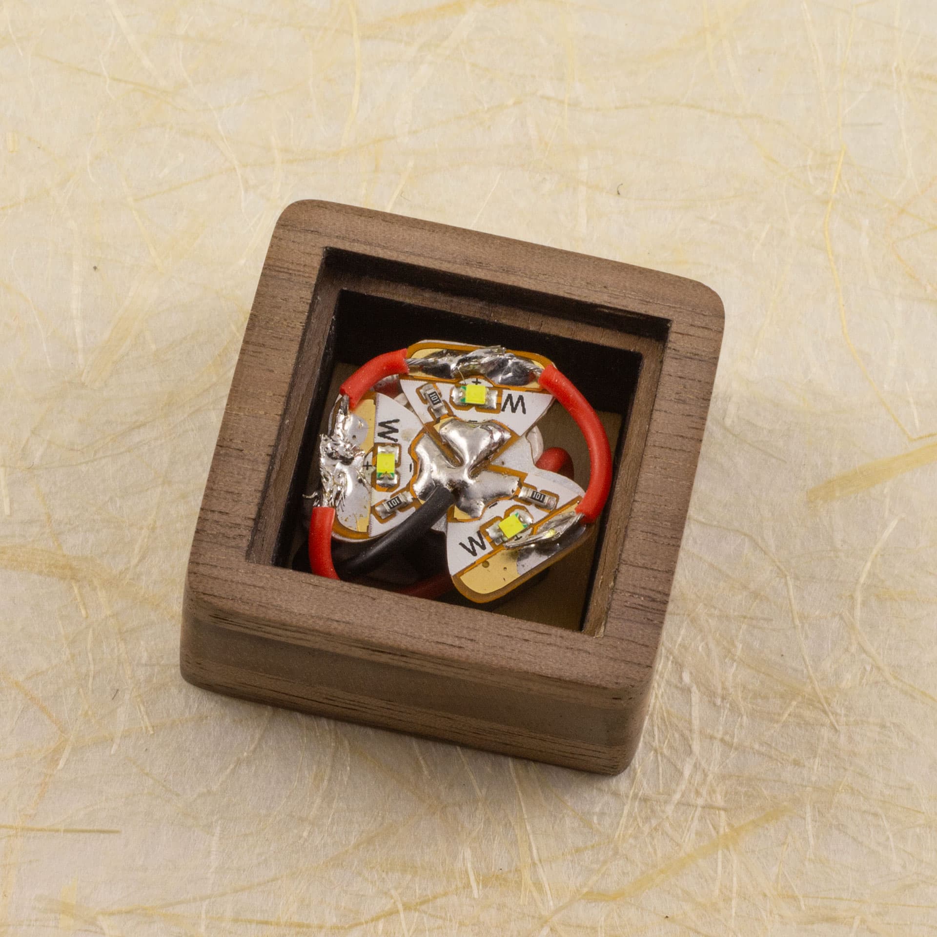

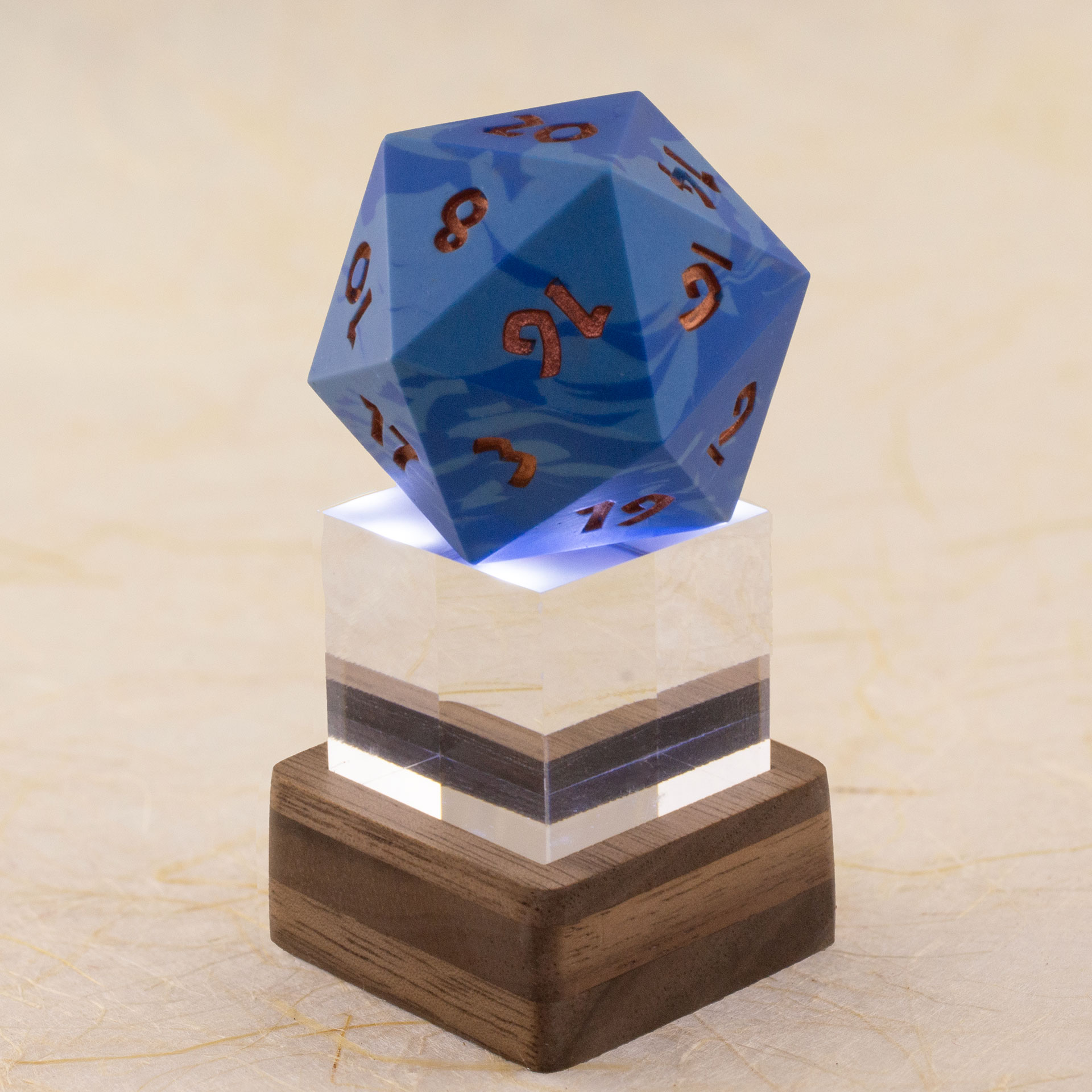

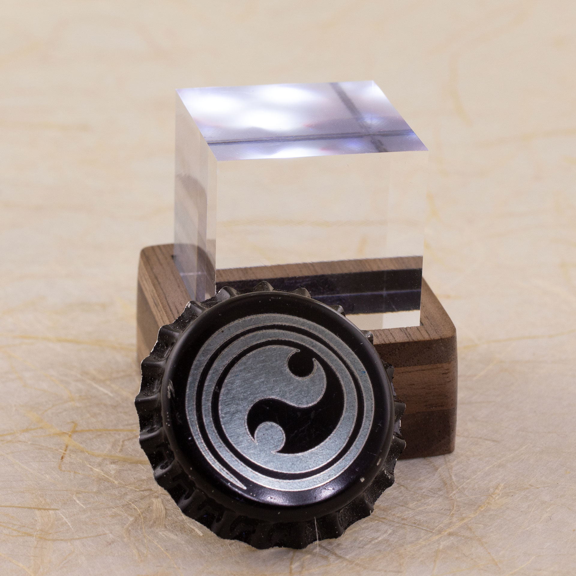

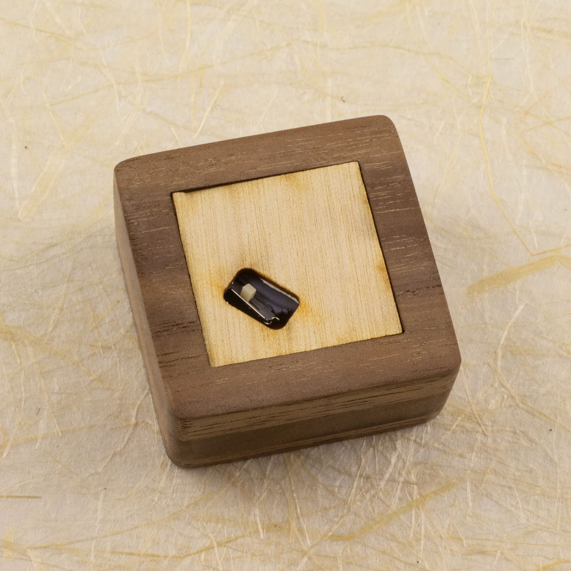

I lasered up this little light-up display/photography stand last week. The base is several layers of laser-cut walnut, glued together and finished (hand sanding and wipe-on poly). I made a hacky little light with a 3D-printed battery holder, some Chibitronics Circuit Stickers, a surface mount switch, and a LIR1254 rechargeable battery. The switch is reachable through a cut-out in the 1.6mm birch ply bottom. A piece of diffuser material and a 1-inch clear acrylic cube sit on a lip over the light.
I have several of the cubes, and will likely experiment with engraving things on the sides, too.

Oh, very nice! It would be great for displaying mineral specimens as well. There are some minerals that only show their beauty in plenty of light.
