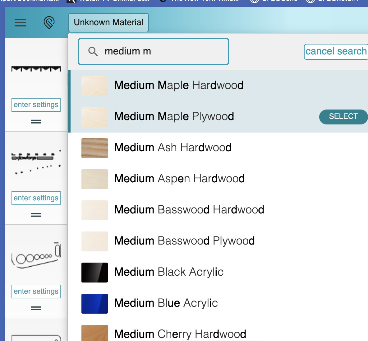

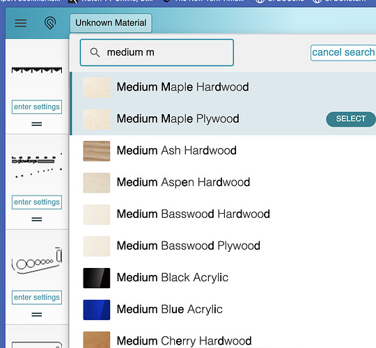

Why can’t I get medium maple plywood to show when I do a material search?
If you have one of the craft machines (Aura or Spark) medium plywood is not a recommended material. If you have a performance machine, it is in the drop down menu.
