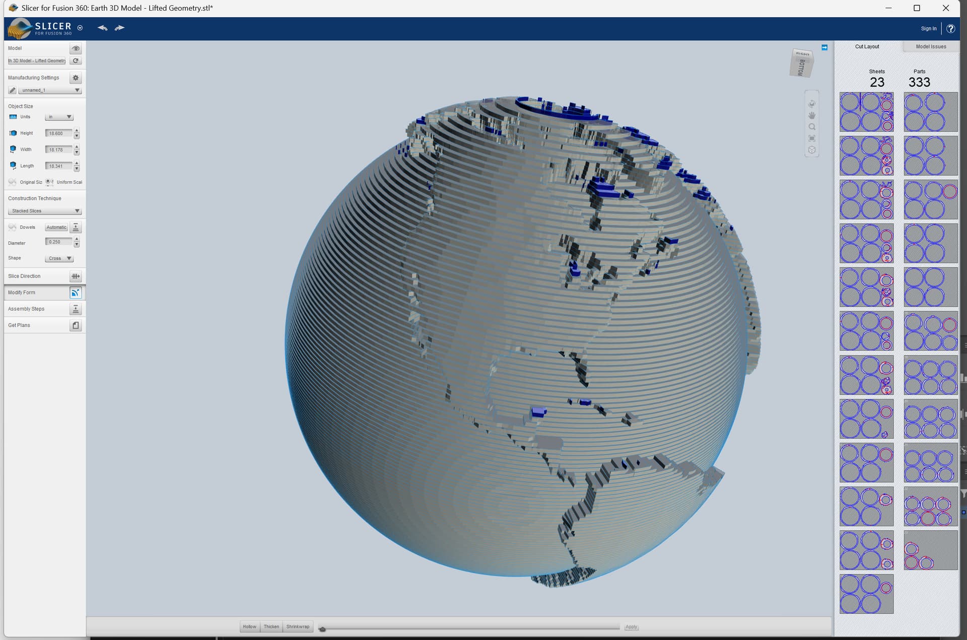

Drones have progressed so much since they released that video, not sure anyone would want that specific design. As far as the globe, the files from the designer at glowforge I have would have had to be resized to fit the glowforge bed. Even scaling to the maximum size would have required splitting each layer in 2, which still would have been hundreds of separate print jobs. I recreated it in slicer with a diameter of 18.6" at a layer thickness of .130" and it’s hundred of parts.
I’d be happy to share the EPS file output if anyone here wants to tackle making them glowforge ready. I personally don’t have any interest in trying to print this due to the amount of cardboard needed. I’d also probably print this on my Mira 9 so I could make it 24" in diameter.
Diameter of 11” seems like a practical maximum for performance glowforges.
That or segmented thin side walls in 60 or 90° chunks. I’d imagine you could fit it in fewer jobs. Let’s do some math with an 18” diameter.
Typical single-wall shipping-box cardboard is roughly 1/8 inch (0.125”) thick.
18 inches ÷ 0.125 inches ≈ 144 layers.
So about 140–150 layers depending on the exact cardboard.
So 140 layers ish with about 1” thick sidewalls, a bit of calculus puts it at about 50 square feet of cardboard required. Assuming you can pack it to 80% utilization that means you’d need about 60 square feet of cardboard sheets.
A full bed of 11x19.5 is about 1.49 square feet, which works out to roughly 41 full bed sheets of cardboard. Even if my assumptions or math are significantly off that’s still a lot of cardboard and a lot of job setup.
