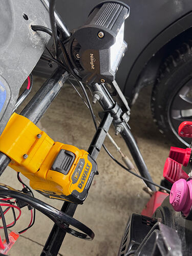

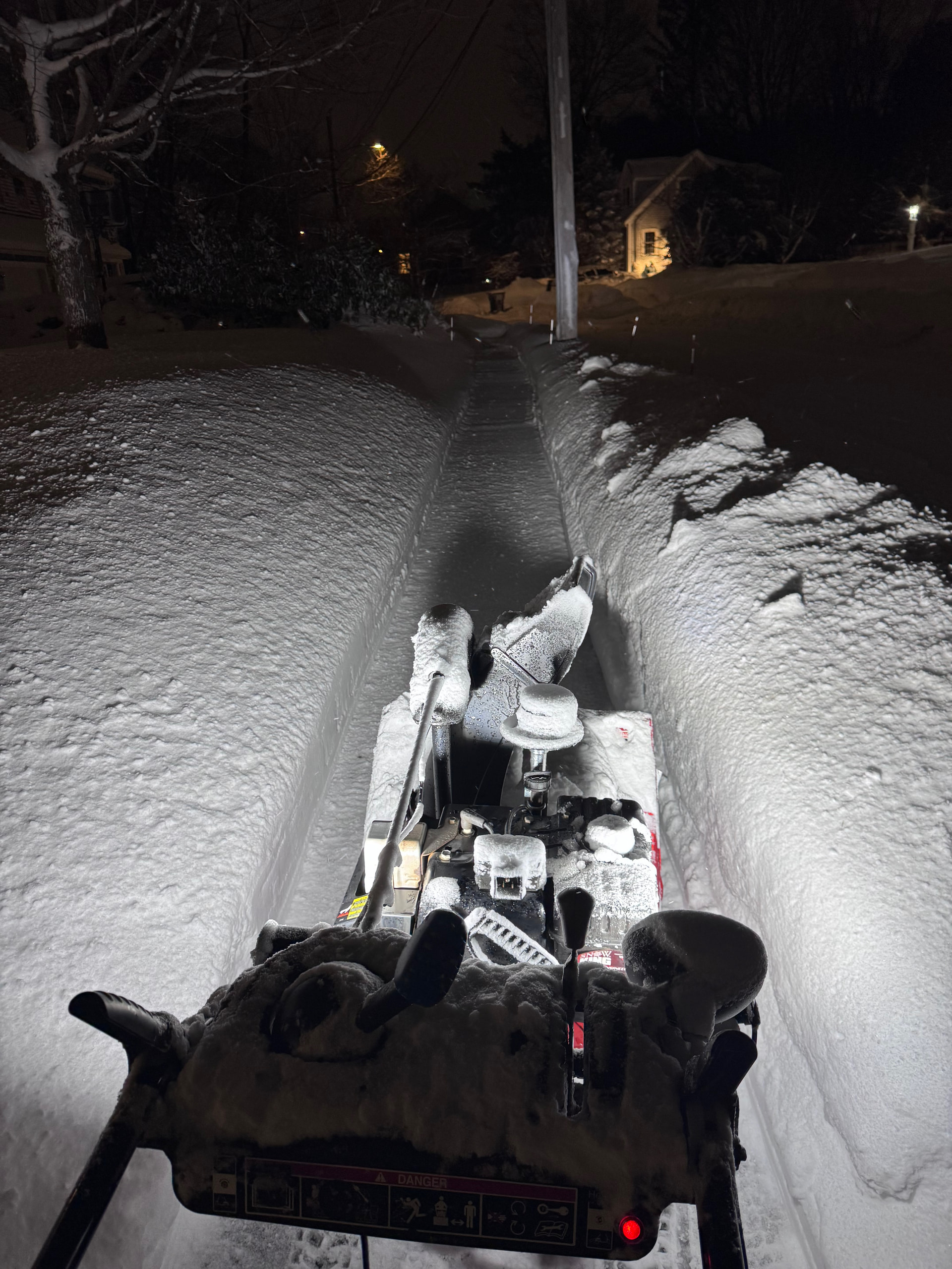

When I bought my Toro snowblower 19 years ago, I never really worried about how terrible the “headlight” (read small glow thing on the handlebar) was, I also hadn’t realized snowblowers (and other small engines) don’t have a real electrical system, and I quickly learned that light provided almost zero illumination for nighttime ops. So I went and bought a pair of 32W LED ATV Off-Road driving lights and mounted them, I’d tried using a motorcycle battery in a 3D printed battery box, but that solved the illumination issue, but ugh lead acid batteries are terrible. So this year I found a 3D printed adapter to use Dewalt Max batteries, and man do they light up the scene. And when one runs out you chuck another from the charger in. My 5Ah battery will give me about 2-2.5Hr (in the cold), and like most folks who do a lot of making I have multiple batteries of my chosen tool brand. It also powers a LED orange strobe since I often am out in the street while town plow ops are ongoing (that is the thing on the post on the right side of the blower that is covered by snow in front of the chute (it is still blinding even covered in snow). The switch is an illuminated waterproof switch (red glow bottom right) on the deck.

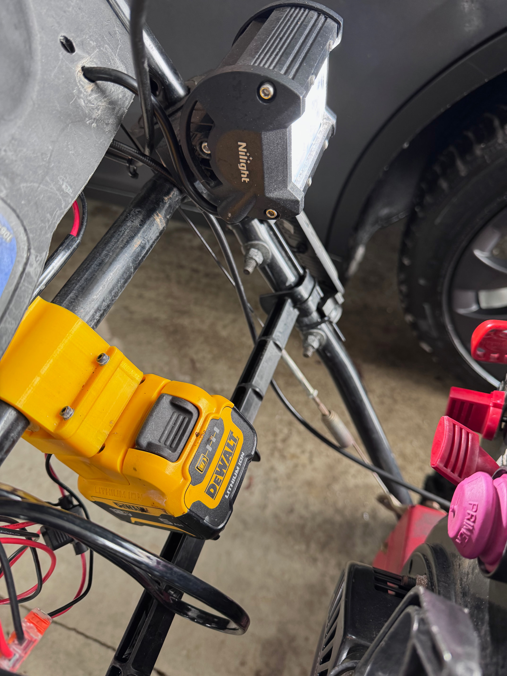

Here is a better look at the 3D printed part

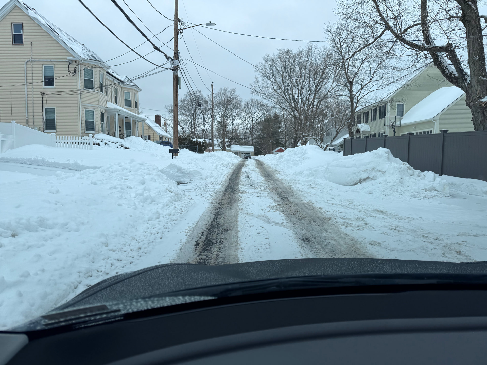

And here is a photo of a street off my street to show you why I am out in the street fixing this at least near my house. That is supposed to be wide enough to let 2 cars pass. I mean it is 2 days after the big storm they’ve had plenty of time to fix the streets…
